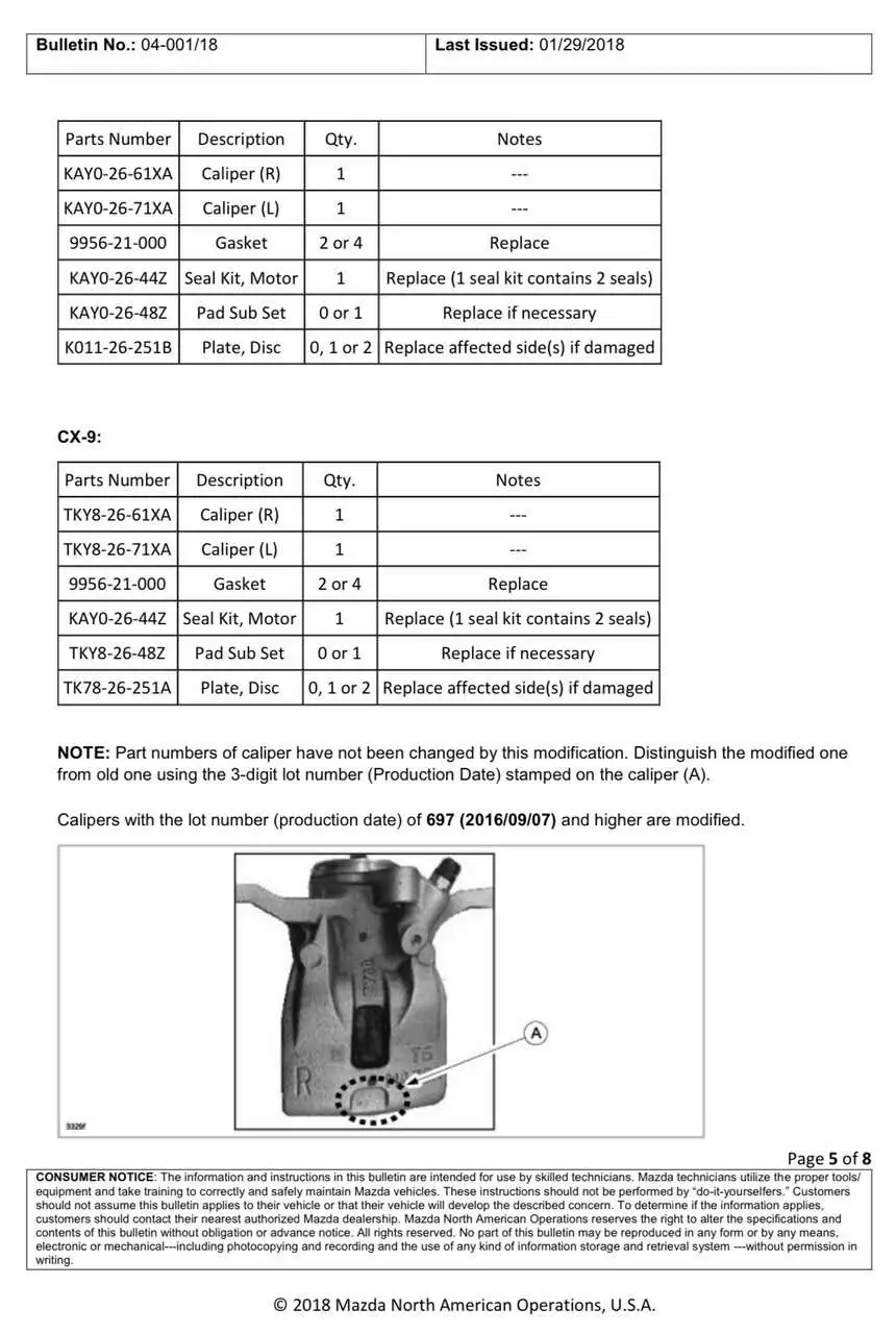

TSB No.: 04-001/18 Noise from Rear Brakes Due To Brake Dragging
If the rear disk calipers were made before 9/7/2016, you need a pair of new disk calipers. Check the date code stamped in the caliper.
When changing a caliper you need to remove the parking brake motor after putting the parking brakes into maintenance mode. Squirt some good penetrating oil (Kroil or B'laster PB are my favorites, not WD-40) into the back end of the hole the brake motor bolt is in. You'll need a hex bit (Allen bit) to unscrew its 2 bolts. You really don't want to break these bolts. You'll need to reuse the o-ring that seals the motor; a dab of silicone grease helps it slide in. (For some Mazda reason the new caliper comes with two new mounting bolts, nothing wrong with the old bolts, but no new o-ring.) Reinstall the motor with care...it's plastic.
When changing the caliper have 2 new 9.9mm I.D. copper washers ready for each brake hose banjo bolt.
Thanks for the information on available parts to replace calipers. The TSB also listed required parts to replace the calipers. It does list the Motor Seal Kit, p/n: KAY0-26-44Z which contains 2 seals.
Yes, two parking brake actuator seal kits would be good to have, but $19 each for an o-ring and two small bolts! The o-ring is merely a weather seal, not a pressure seal. Replacement bolts are available in any good hardware store. High strength bolts aren't needed, they bolt down a plastic piece.

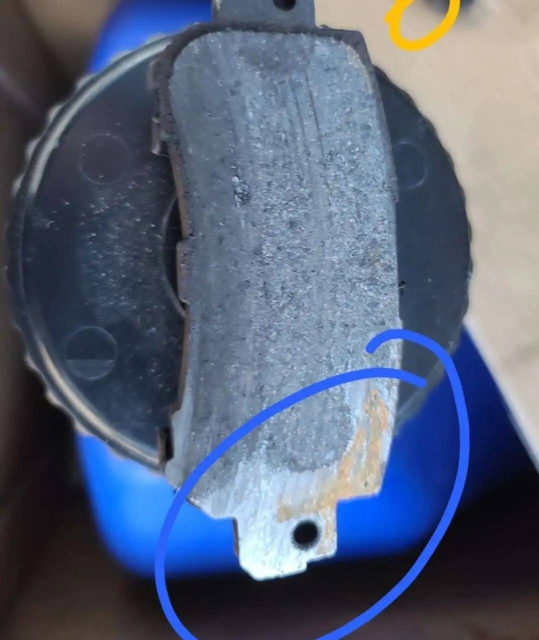

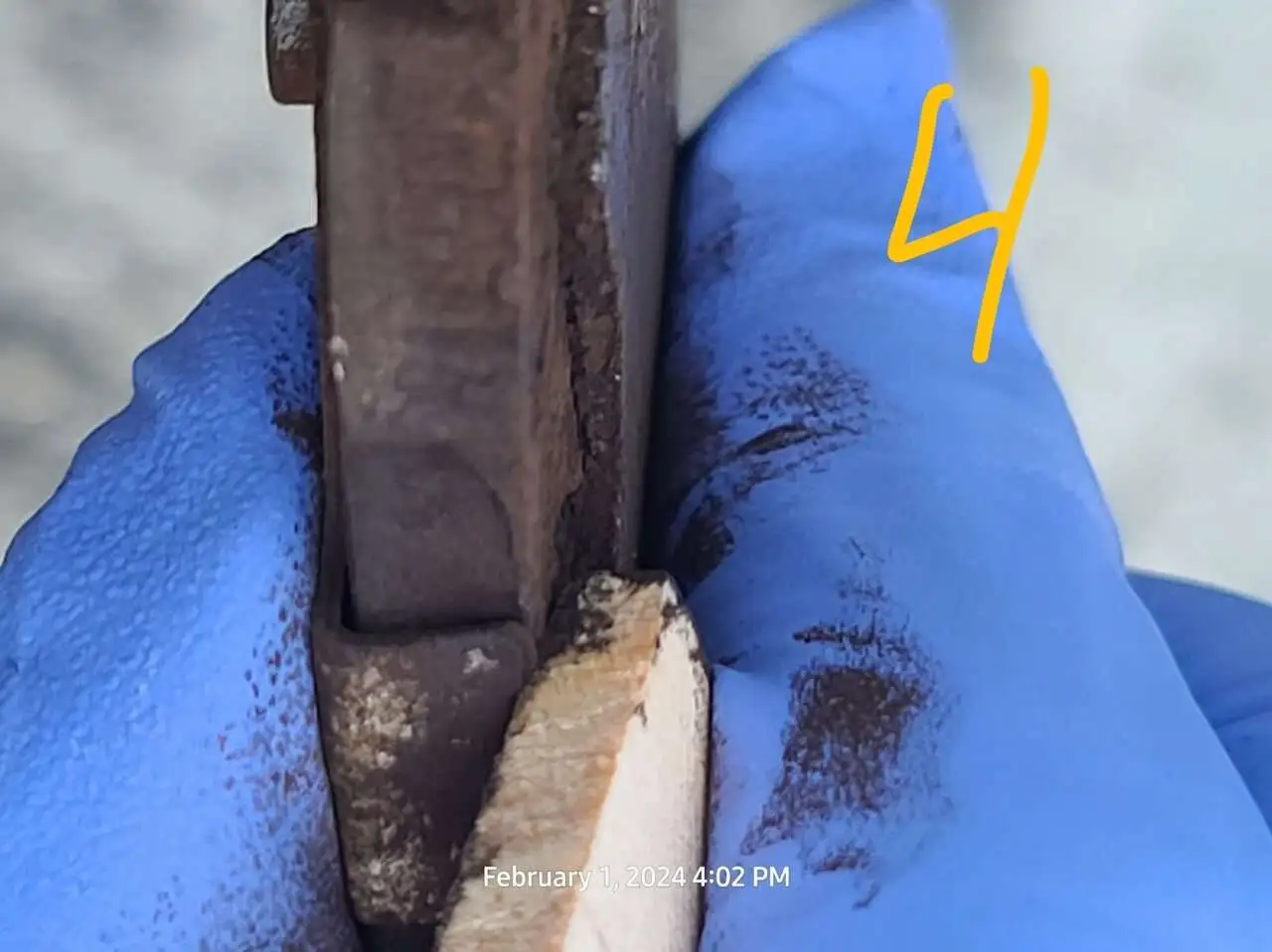

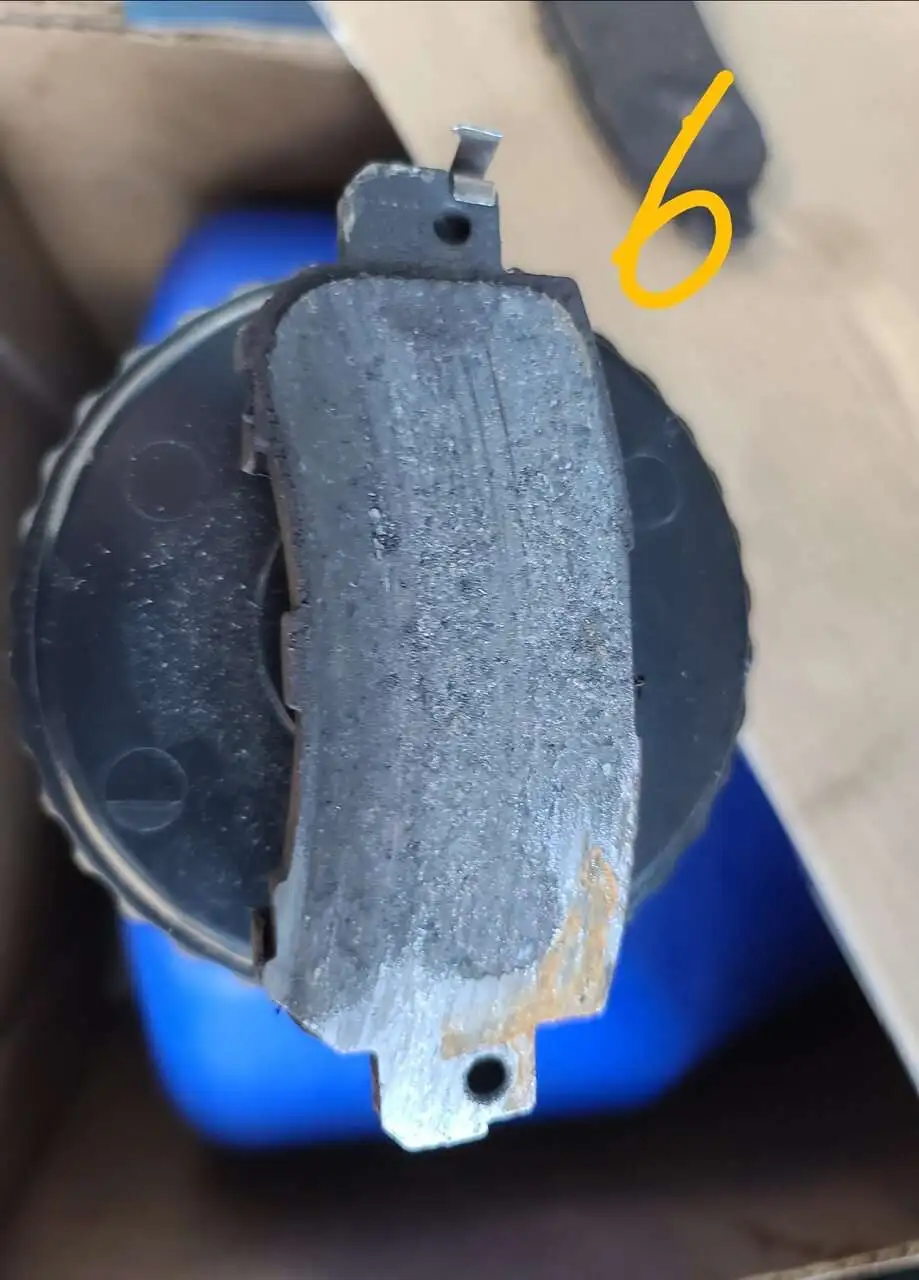

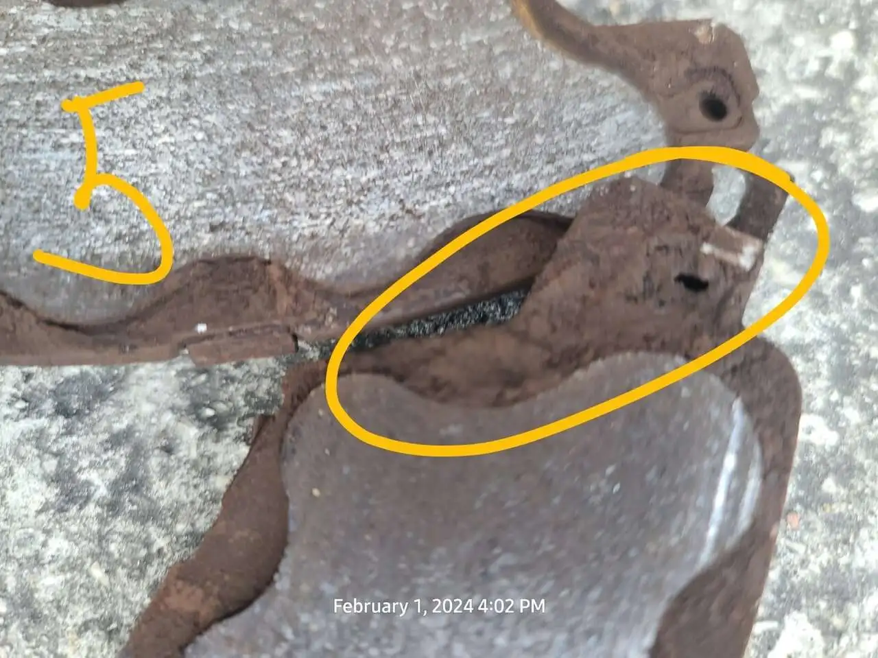

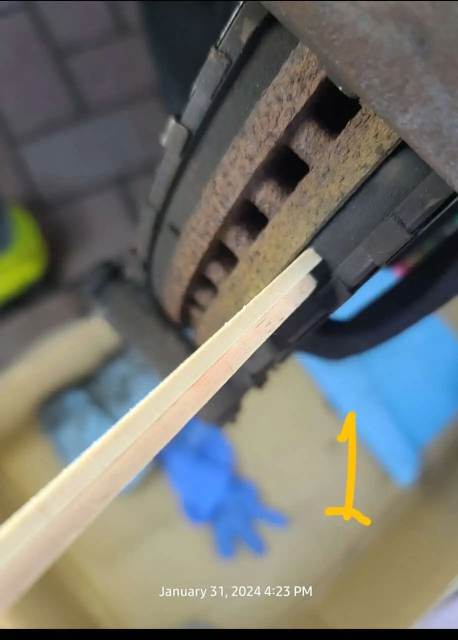

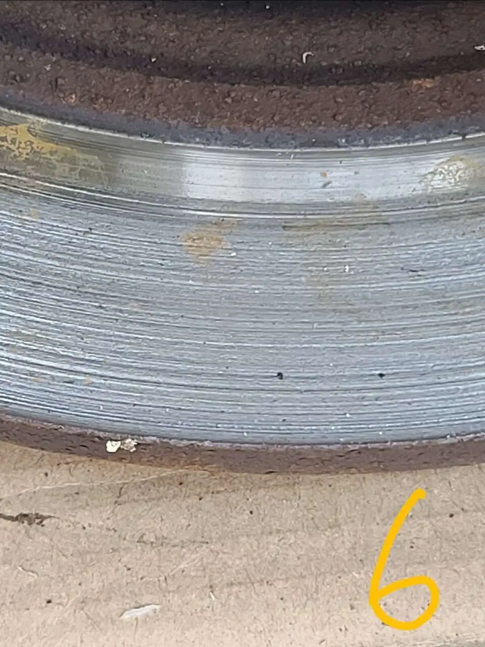

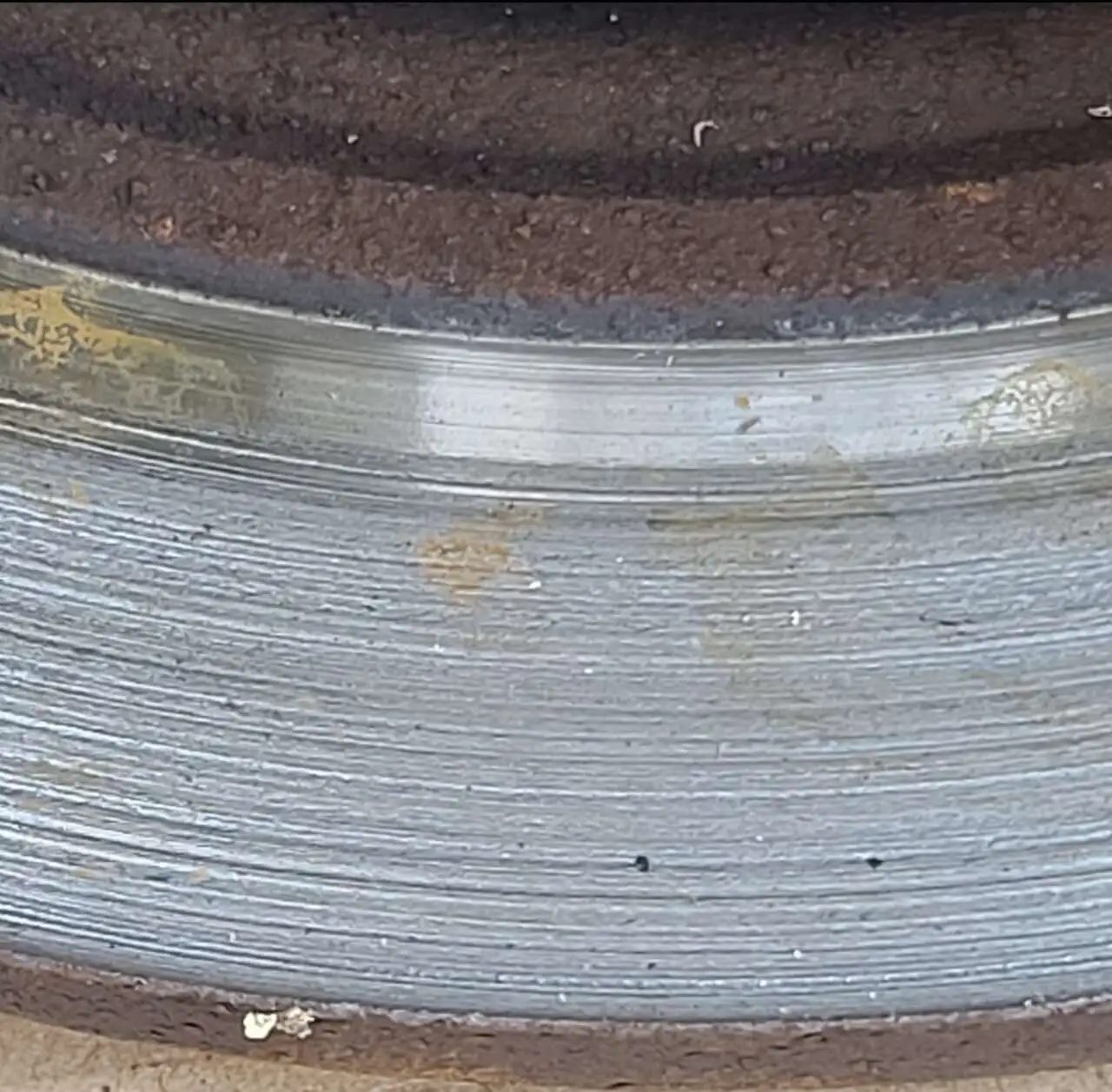

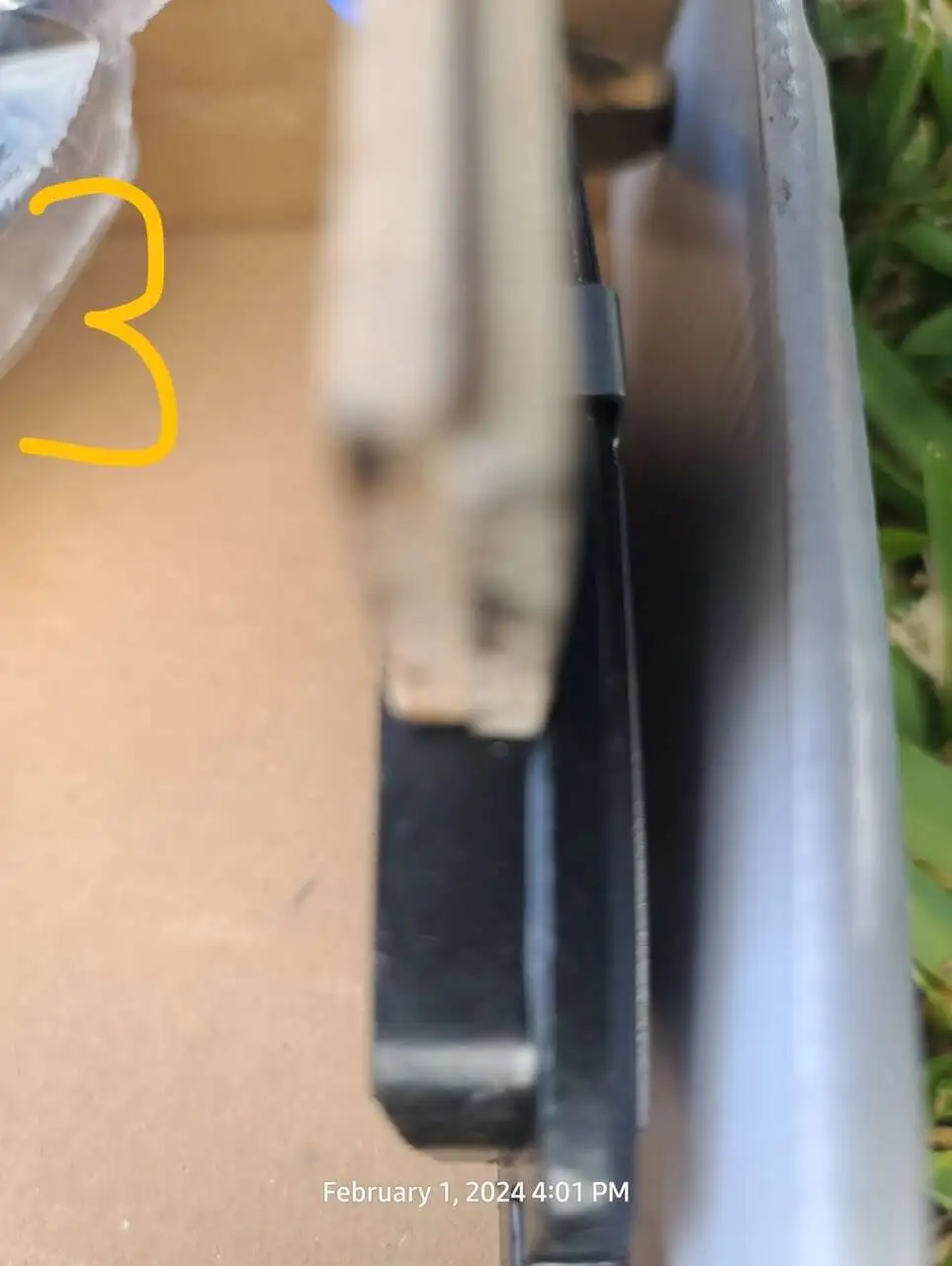

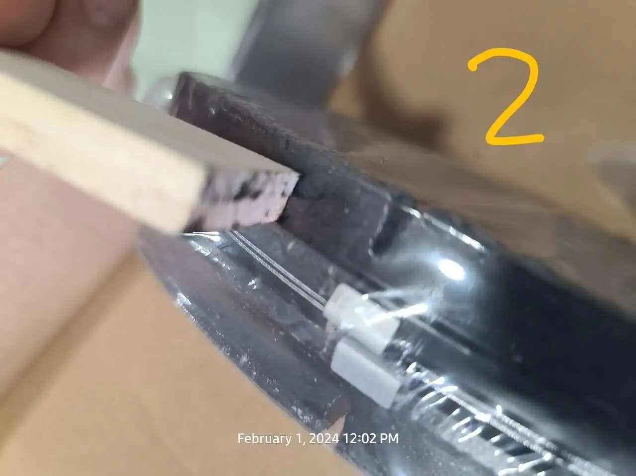

Hi eveyone. You might have seen my post already. Since we talked about rear brakes, I decided to copy post here too.
Tossing my data in cx 9 2016 at 105k. 80% highway drive. From 2019 to 2022 I added 70k miles. I also own a cx 5 2014. Purchased the cx 9 GT 2016 in 2019 used with 28k miles and possibly zero oil change...
First set of OEM Front lasted to 51k, I replaced it a bit early. Since I already removed everything and brake was cheap. I was lazy and left the rear for another day.
At 76k usage I replaced the back set, it was about time. Wagner OEX
The good: At 105k, (52k usage) front look amazing. I don't have a those tools to measure.. But I use two of those 1 gallon paint sticks. That gives you an good idea on how new it is. I'll show you the same on my unused one.
Back looks horrible, I heard some sounds and decided to remove / add new brake grease. It was worn down at 28k usage...
I had a lot of rust dust / brake dust. It clogged piston a bit ( I had to tear it because I over extended it...).
I attach a few pictures.
1) Current Front Wagner OEX at 52k usage
2) picture of new front unused Raybestos eht1258H with the paint stick 👌
3) New rear raybestos eht1934H
4) Old rear Wagner 28k miles
5) The build up of the dust powdered on the pad
PS) My rear Wagner for Cx 5 didn't last as long also. I think about 35k and was metal (6) main issue was the brake caliper not releasing and destroy my break rotor and pad. There was a bit of life on it. Maybe 5-7k more. If everything had no issues. But it 100% wear out faster then OEM

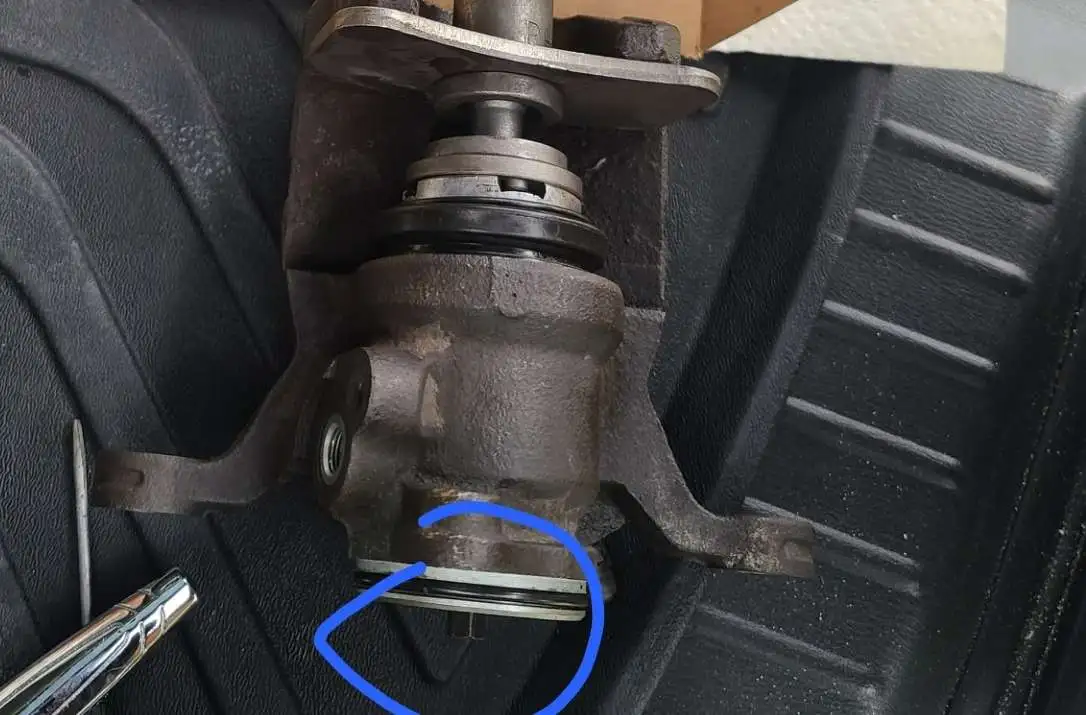

I had the wheel locked without going into service mode. I did try the service mode to see if I could restet everything . Obviously Im way past that now and need to manually release the caliper piston to rotate the wheel
I must have missed the part that you didn't enter service mode on purpose. So It is probably the caliper that's not releasing. It happened to me on my CX5, I posted how it destroyed my pads and my rotor. Lucky it want a EPB. Old way is so much easier.
The blue I circle show just the metal, no pads

If you going to swap out the caliper or rebuild. Be sure to bleed correctly. I had to leave engine on, make sure bottle is on top, and grease the drain nipple to prevent back flow of air. It was a lot of bleeding for it. Over 200 pumps. Then you need to do other four. Literally just did it two days ago.
And it was a caliper issue. I think you should rename title if possible. "Rear brake caliper failure and fix".
I wish I was able to detail more on it. But it was a messy job and can't keep asking wife to take picture of my fix.
