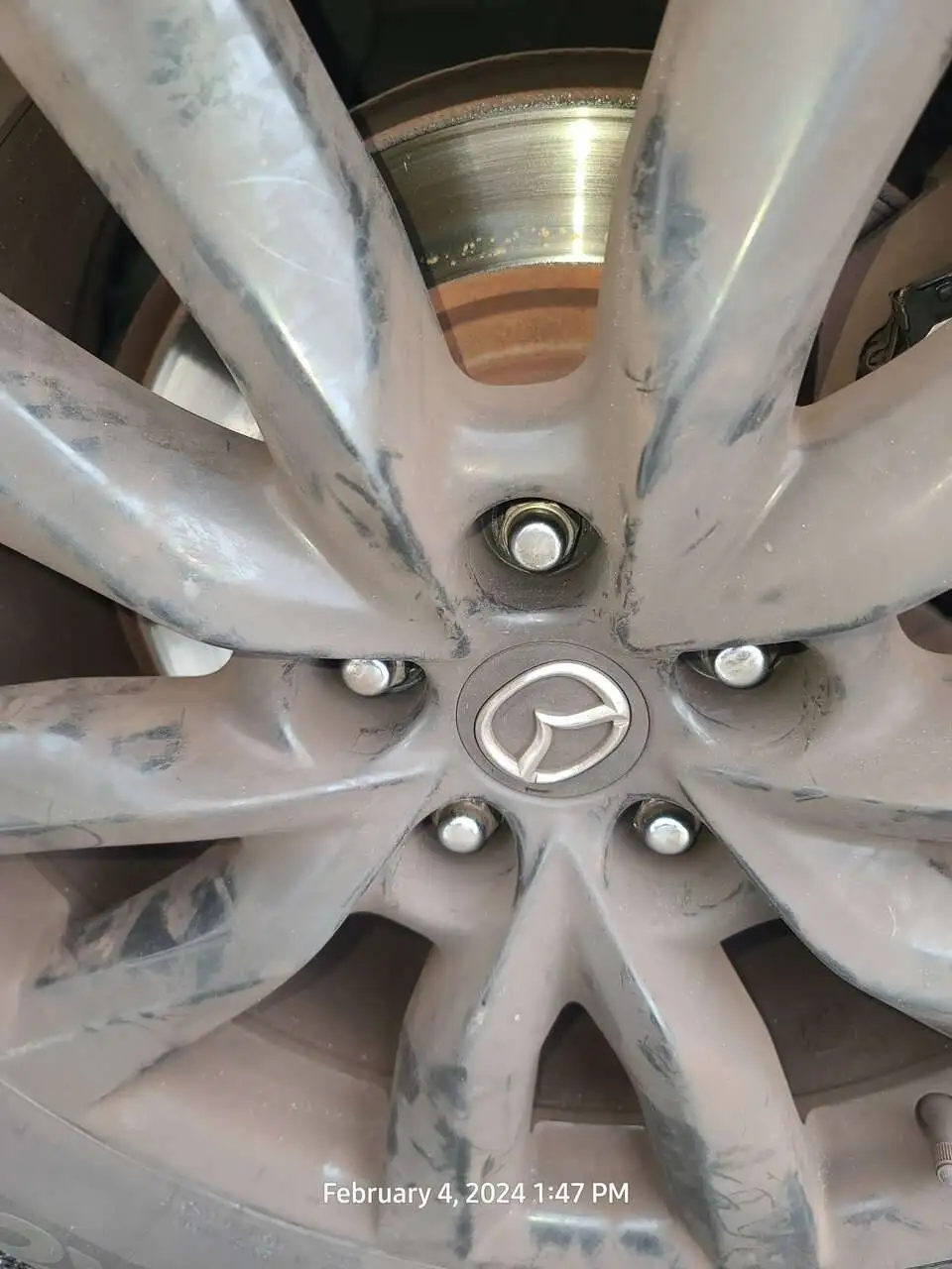

I'm on the same boat as you I have a July 2016 model, FWD, currently at 105k. My two cx has calipers issue with Wagner OEX. Can't be 100% sure, but I decided to switch to another rear break. Oem got me 72k, Wagner got me 28k. Did you switch to non oem pads? I attach how bad my dust issue is. Wash car about 3 weeks ago. Less then 400 miles. It doesn't surprise me if dust mess my piston up.
During the rebuild, I did notice dust inside my calipers.

Lots of dust indeed
