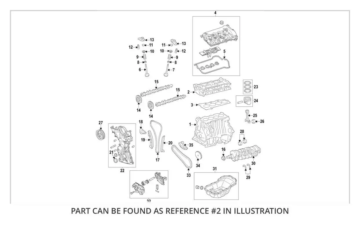

One of the members of the FB CX-5 owners group was able to take the VIN of a non-CDA listed CX-5 and pull the BOM of parts. The part number in the brand new 2024 CX-5 without CDA was: PYFA-10-100E
If you look that part number up on the Mazda parts site, it states that it fits: "3 models, 57 variants between 2018 and 2020."
That's not very reassuring that the 2024 non-CDA models are any different. Why are people saying these will be any different? It appears to me that the CDA parts are truly part of a supply chain shortage and the cylinder head is still the one with the 2mm wall.

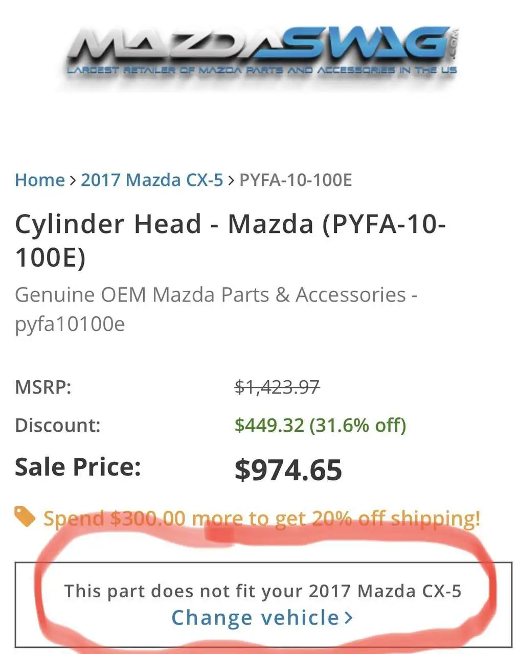

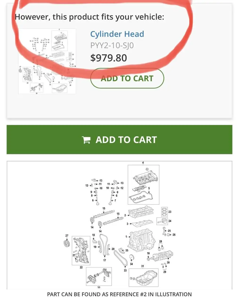

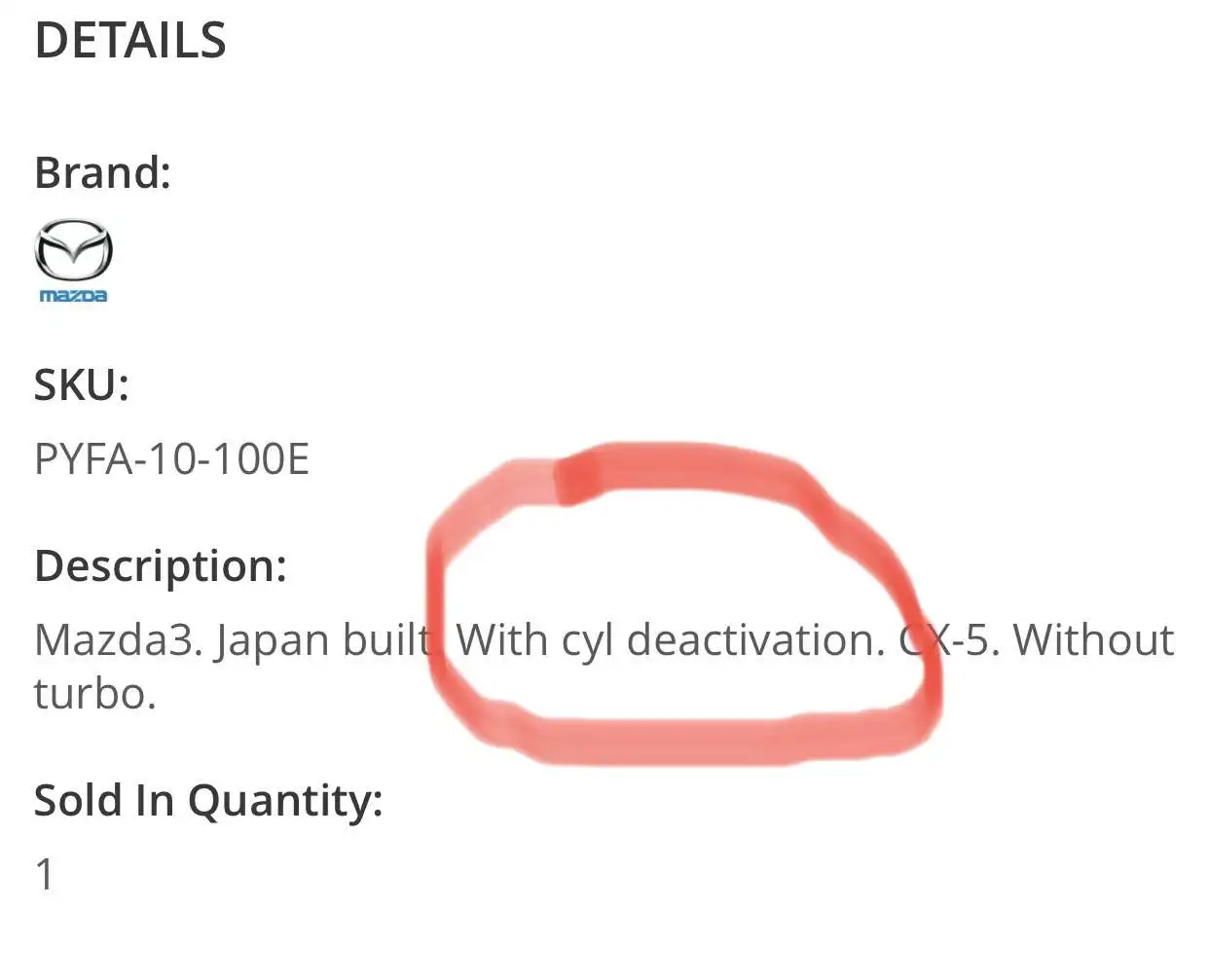

This’s incorrect. PYFA-10-100E is the cylinder head with cylinder deactivation. There’s no way the cylinder head is interchangeable between the 2.5L NA with CD and without CD as explained above.
Cylinder head PYFA-10-100E is for 2.5L NA with CD:
Cylinder head PYY2-10-SJ0 is for 2.5L NA without CD:
So if the head is cracked on a 2.5L NA with CD, dealer needs to order a cylinder head set kit p/n 0000-99-SCX5 which included a “loaded” head PYY4-10-SJ0 and all other necessary gaskets and washers to replace the cracked head.
No, PYFA-10-100E is only for 2.5L NA with CD, see above.

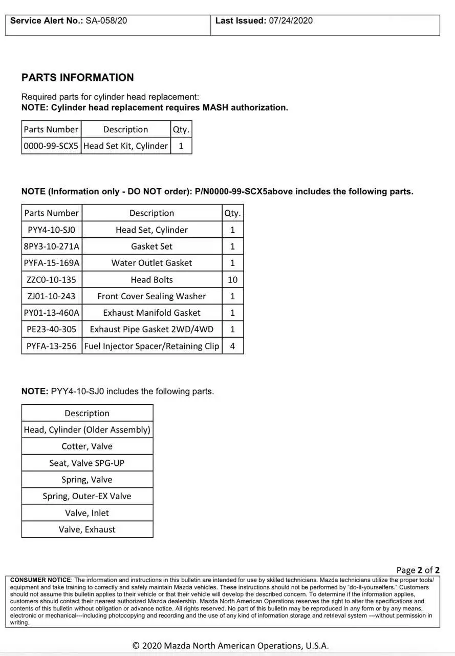

SA No.: SA-037/23 New Cylinder Head Assembly Established
