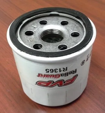

My dealer charged me for a Mazda filter but used this generic Reliaguard. Sounds like they use these all the time. One other reason I normally do my own service. I personally wouldn't chose these but if the dealer uses them, don't you think they meet the minimum Mazda spec?

I think this oil filter comparison is blown way out of proportion. I like to use quality products on my cars, but in hindsight there are thousands of regular cheap oil filters sold that meet the spec and don't blow up engines.
I can't find exact details on this one, but here is their website.
https://www.fvpparts.com/files/4713/8377/1413/Oil_Filters.pdf

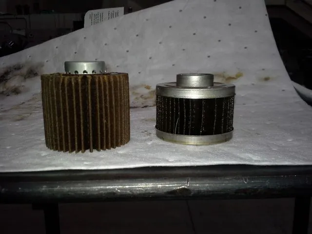

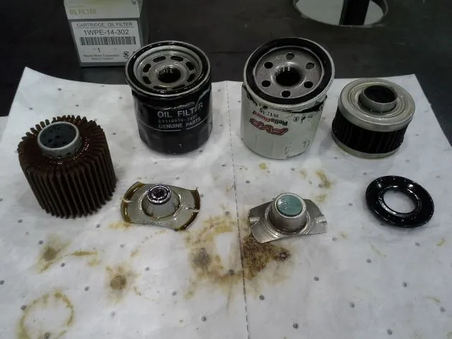

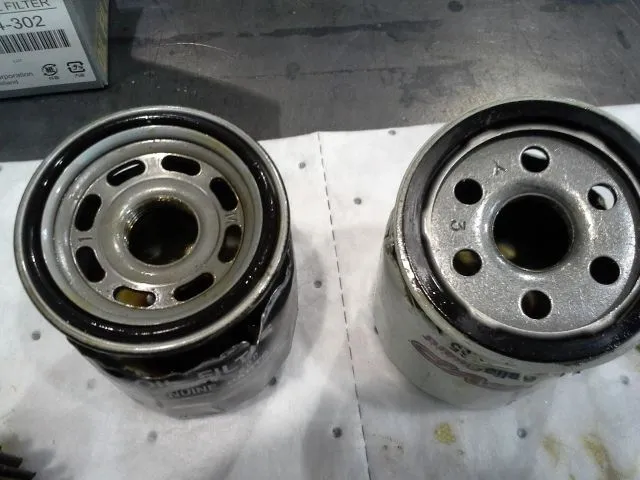

Here are a couple pics compared to a Mazda OEM filter. Not sure how you guys attach pics, but mine always show up as a link
Based on the pictures, the Mazda has double the filter area and double the hole area for flow - seems to be a significant design difference. I am not sure oil filters have to meet any kind of manufacturer spec. If they do, I am not aware of it. I found this dated article that mentions some SAE specs, but nothing about individual manufacturer specs. If Mazda has specs that are above and beyond SAE (likely they do) then we should use Mazda filters, or filters that meet Mazda requirements.

I don't think Mazda or other engine manufacturers publish external specs for filters. The filter from an SAE standpoint has to remove particulates of a certain size. But when i look at that mazda filter compared to the other brand, the mazda filter seems more optimized for flow/throughput. That other filter could cause an increase in Oil pressure and reduced oil flow. This could be meaningful in our high compression engines.
