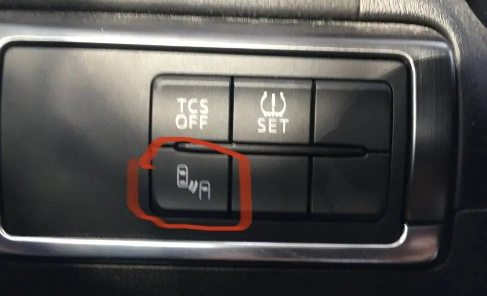

Recently I’m trying to have a habit to press the “TCS OFF” button each time I drive the CX-5, and I accidentally hit the Blind Spot Monitoring (BSM) button a couple of times. I noticed the button has no effect to turn off the BSM, and didn’t see any “BSM OFF” indicator light lit in the instrument cluster. And the BSM and Rear Cross Traffic Alert (RCTA) seem to keep working and can’t be turned off by the switch.
Owner’s manual says:
“When the Blind Spot Monitoring (BSM) switch is pressed, the Blind Spot Monitoring (BSM) and Rear Cross Traffic Alert (RCTA) systems are turned off and the Blind Spot Monitoring (BSM) OFF indication/indicator light in the instrument cluster turns on.”

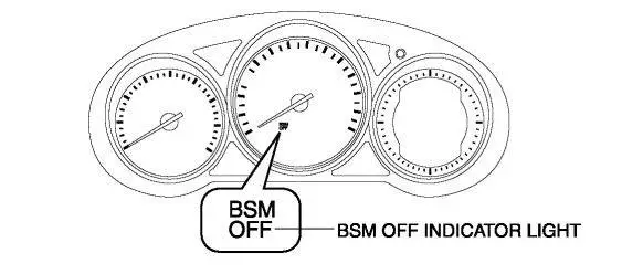

The above link has a picture that shows the BSM OFF indicator near the center of the speedometer.

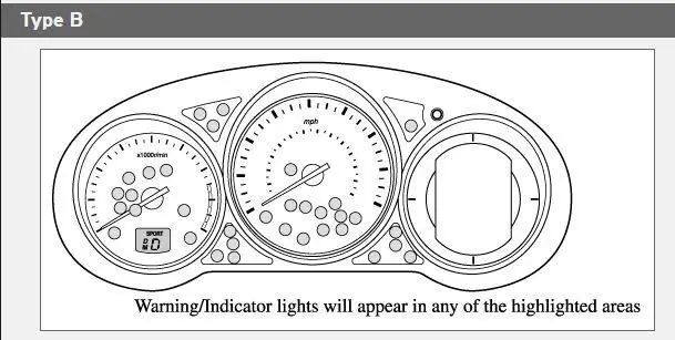

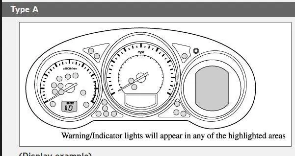

I checked the 2016 CX-5 Owner's Manual on Mazda.ca, and it shows the following:
Type A Display:
Type B Display:
And the indicator looks like this:
Type A Display:
Type B Display:
The dash location of “BSM OFF” indicator showed in the Service and Repair Manual on my 2016 CX-5 GT AWD is either “High Beams On” indicator or the “Charging System Malfunction” warning light as seen in my 2016 CX-5 Smart Start Guide. And I can’t find the “BSM OFF” indicator icon in instrument cluster illustrated in the Smart Start Guide either.

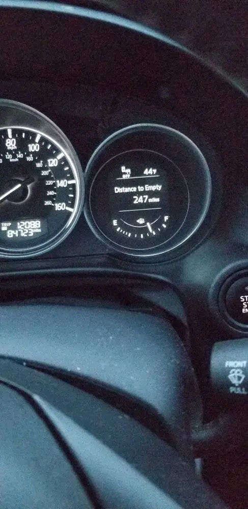

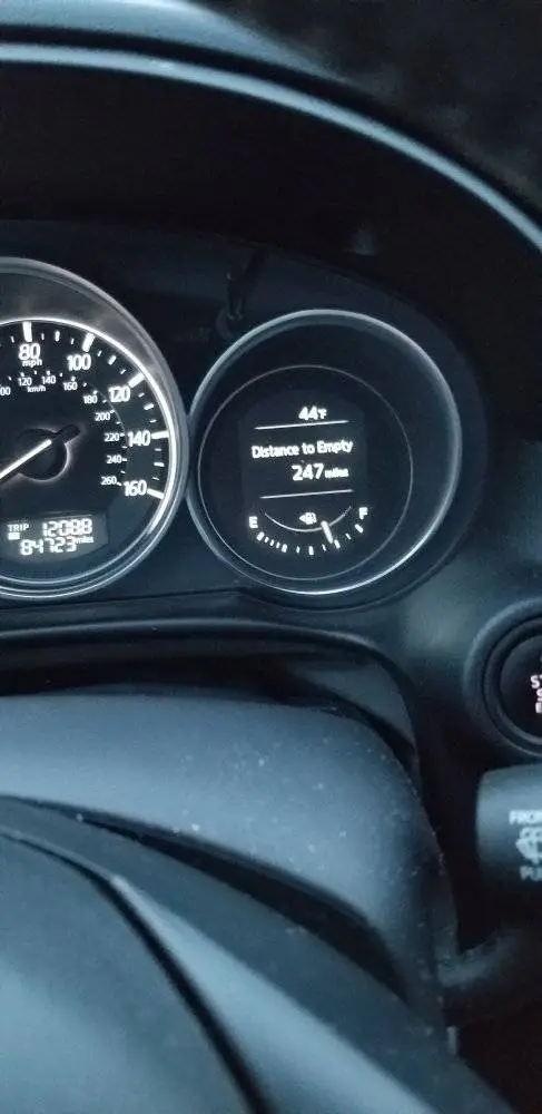

I don't even have the BSM switch on the panel in my 2019 GT-R

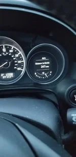

Look to the left of your temperature indicator in the fuel gauge area.
Thanks for posting pictures! Currently my CX-5 has red wrench indicator and “Oil change due” in that dash area which apparently prevents the display of ambient temperature and “BSM OFF” icon! That explains why I can’t find the “BSM OFF” icon. Besides, the “BSM OFF” icon on the 2016 CX-5 GT with Type A instrument cluster is not an amber-colored light like on rockethead26’s 2019 CX-5 GTR and the glossary in my Smart Start Guide, but a black-and-white LCD icon with “OFF” wording at different position as showed in manuals.

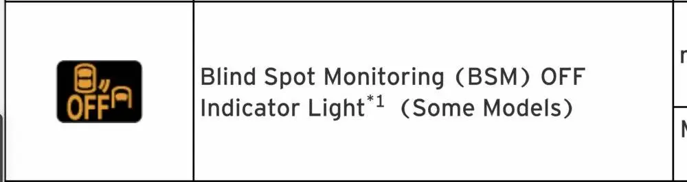

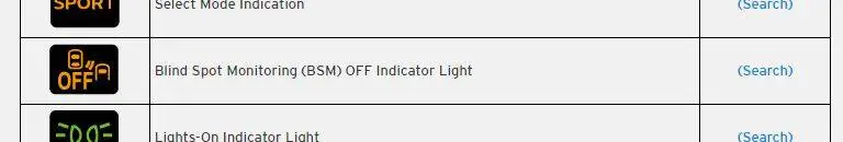

On my 2016 CX-5 GT AWD it’s interesting to see that the “BSM OFF” icon looks different among glossary of warning and indicator lights、illustration in Smart Start Guide、and the actual icon displayed on Type A instrument cluster.
Glossary of warning and indicator lights (amber / yellow color):
