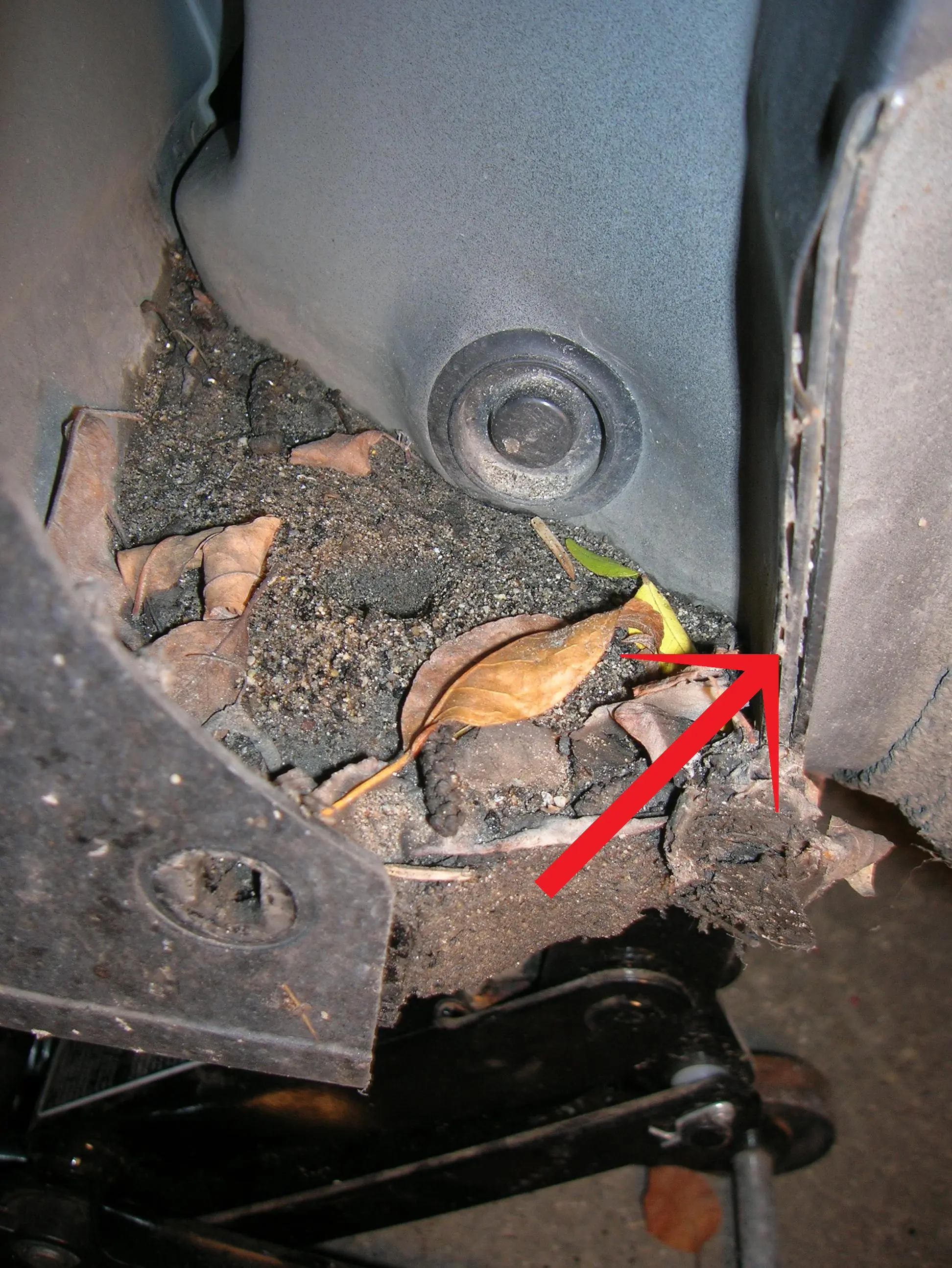

Here is where my leak was. Not the giant arrow. That seam, packed with road s*** and split open. I know it isn't the greatest, but it is looking from the front to the back of the car.
Alright, found the source. It is coming through a seam. I pulled the passenger splash guard, put a light in there and looked for it on the inside. Sure enough, parts of the seam had light pouring through.
I am going to seal them up again but is there any particular sealant I should use?

Opened up the wheel well and none of the seams are open. Unfortunately the water in my wife's car is originating from somewhere else :(
Last time I pulled her carpet up I could see a trail of water coming from behind the firewall, so I suspect it's a windshield leak somewhere.

Check the drain for the vent cowl. Leaves can get caught in there really easily and water can come through the heating intake duct. Also, it is hard to tell the seams are sealed just by looking inside the wheel well. Mine looked fine until I got a light on the inside of the car and looked for light through the cracks.
