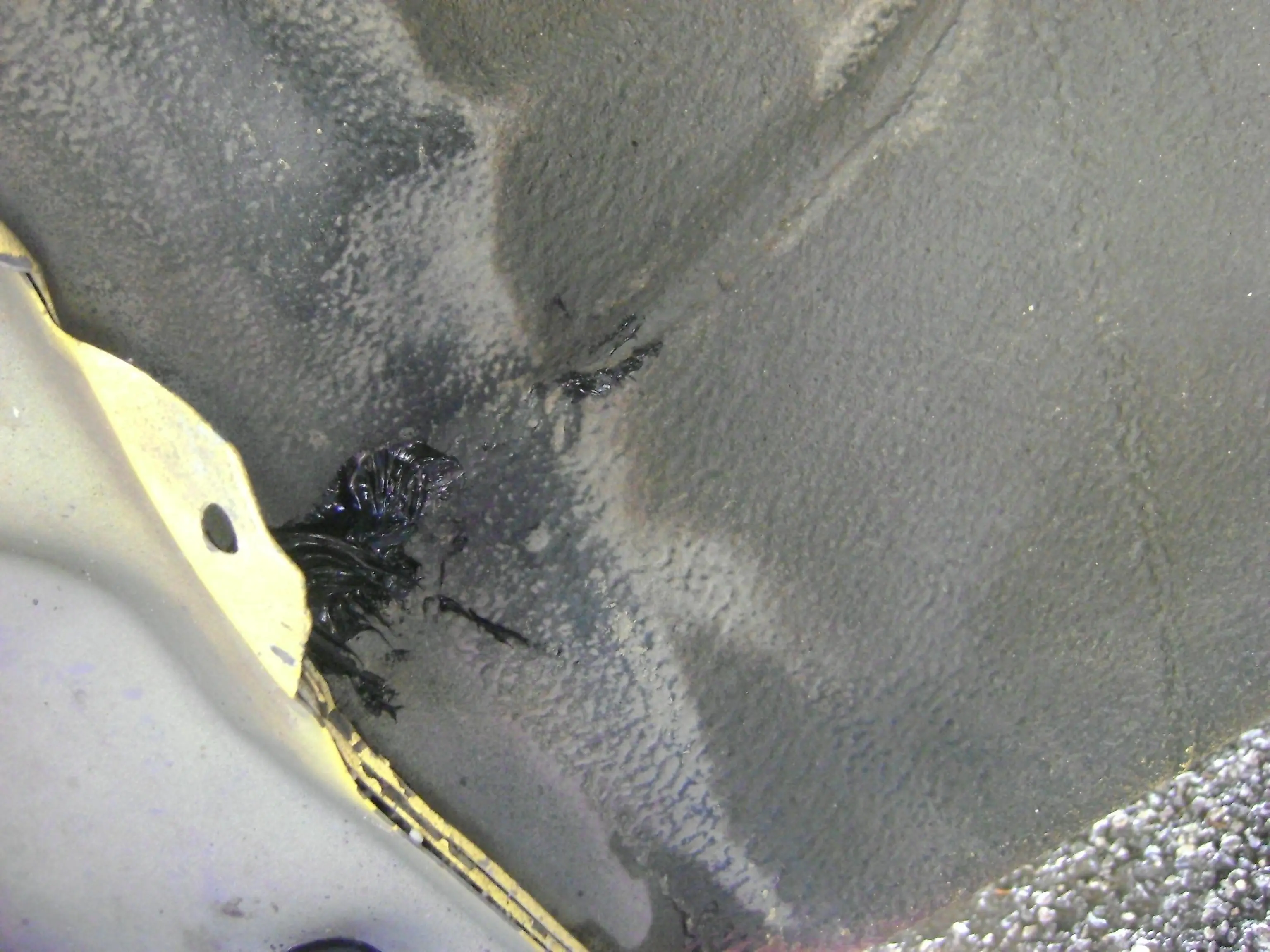

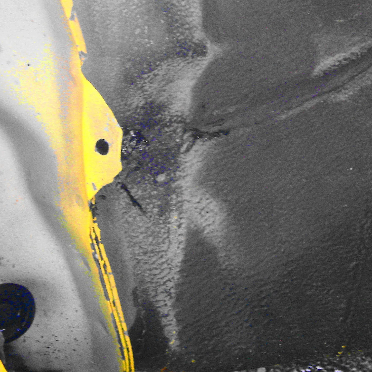

Alright, found the source. It is coming through a seam. I pulled the passenger splash guard, put a light in there and looked for it on the inside. Sure enough, parts of the seam had light pouring through.
I am going to seal them up again but is there any particular sealant I should use?
3M fast and firm sealer. Look for some at your auto parts store or go to an autobody supply store for it, unless you find an equivalent.

broken seam
