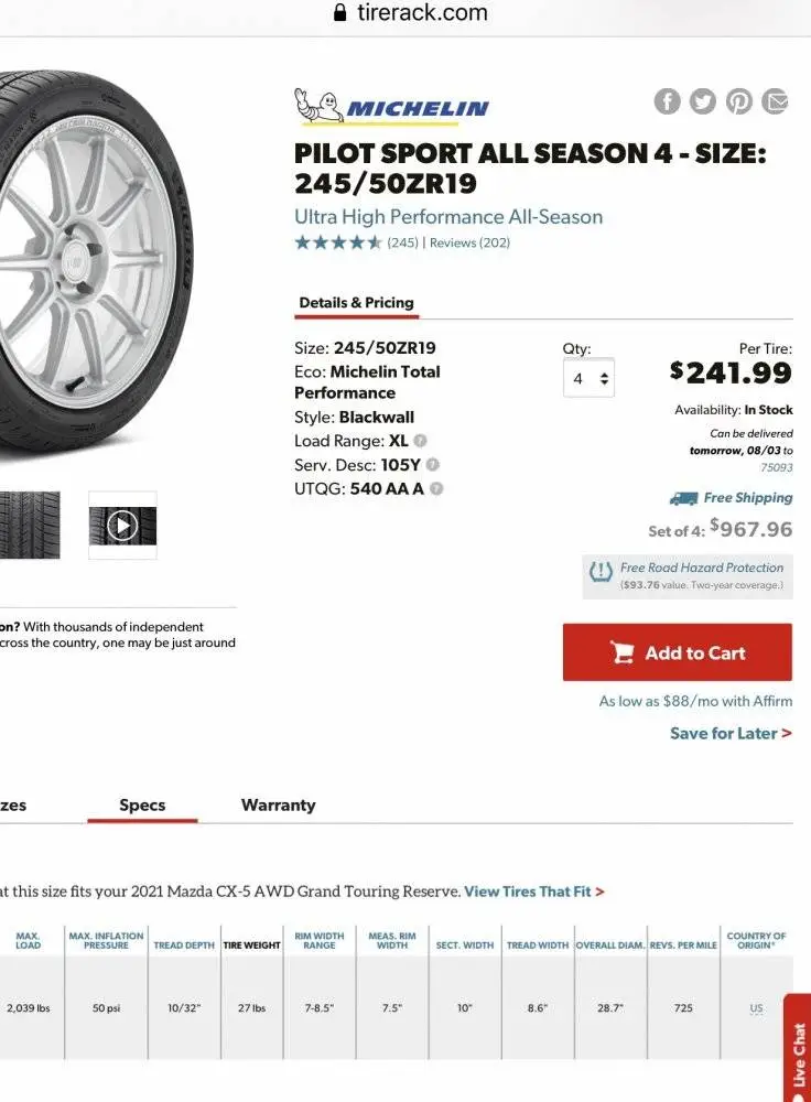

The PilotSports are popular tires with no complaints like yours. In fact TireRack rates it as the second best tire in that category. I’ve run the non-all seasons on another vehicle for years with great success. If yours are rolling over as you describe, are they actually 245/50-19s? The recommended rim widths are 7-8.5”. What is the tire pressure?

The measuring rim width or the tire’s “design rim width” is 7.5”; and the rim width range is 7” ~ 8.5” for Michelin’s Pilot Sport All Season 4 245/50ZR19 tire. The factory rim should be fine, and the best rim width is 7.5” to the tire.

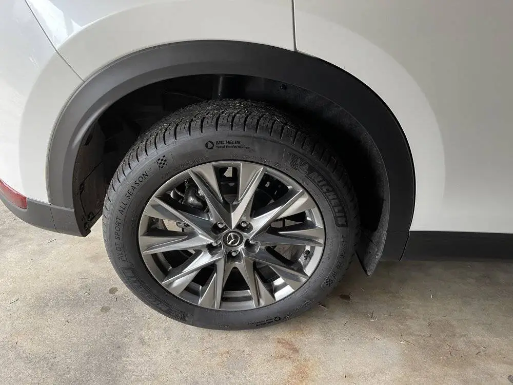

Since Michelin Pilot Sport All Season 4 features “an advanced tread compound molded into an innovative asymmetric pattern”, can you verify if it’s a directional tire? You should be able to see a “Rotation” with an arrow on the sidewall if the PS AS4 is a directional. If it is, then verify if the tire store mounted them correctly.
Not sure where did you get your Michelin PS AS4 tires. But the tire store like Discount Tire you can always return the tires and get different ones in 30 days if you don’t like the tires.

I did check, it does not looks like there is an arrow. It just says outside. I will attach a photo. Let me know if you can see it
