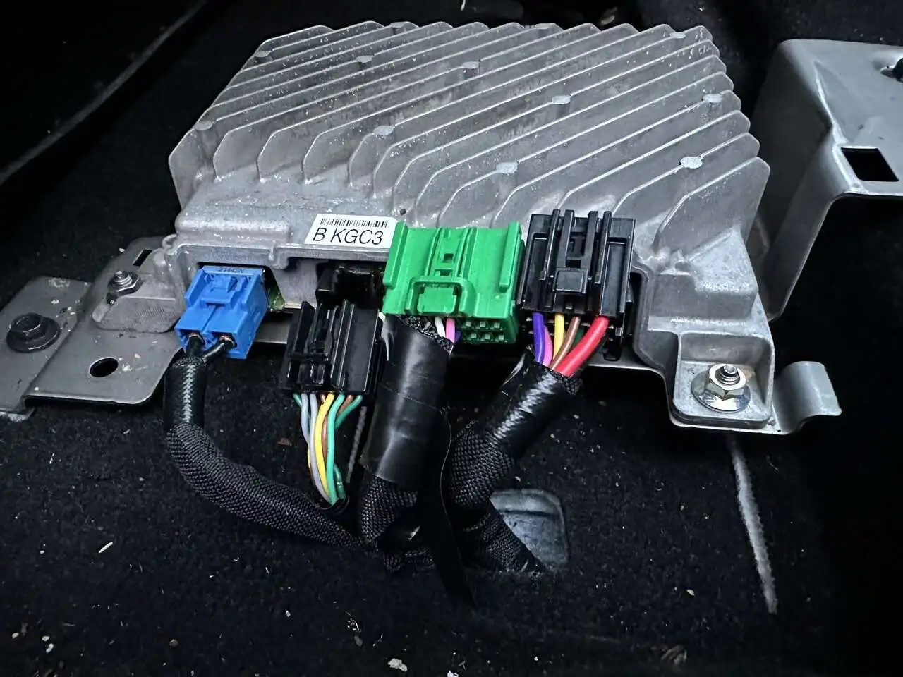

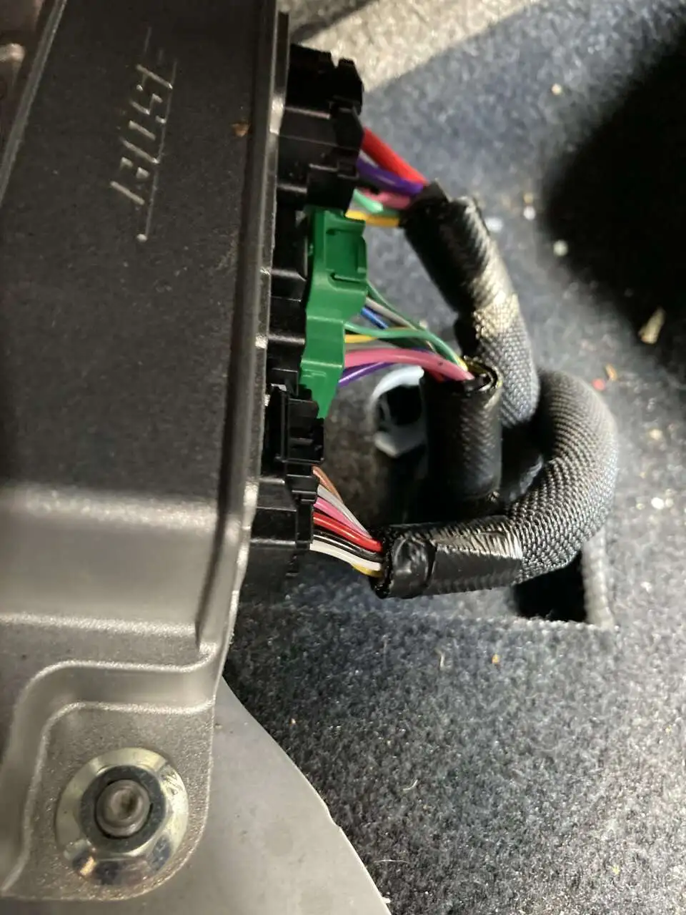

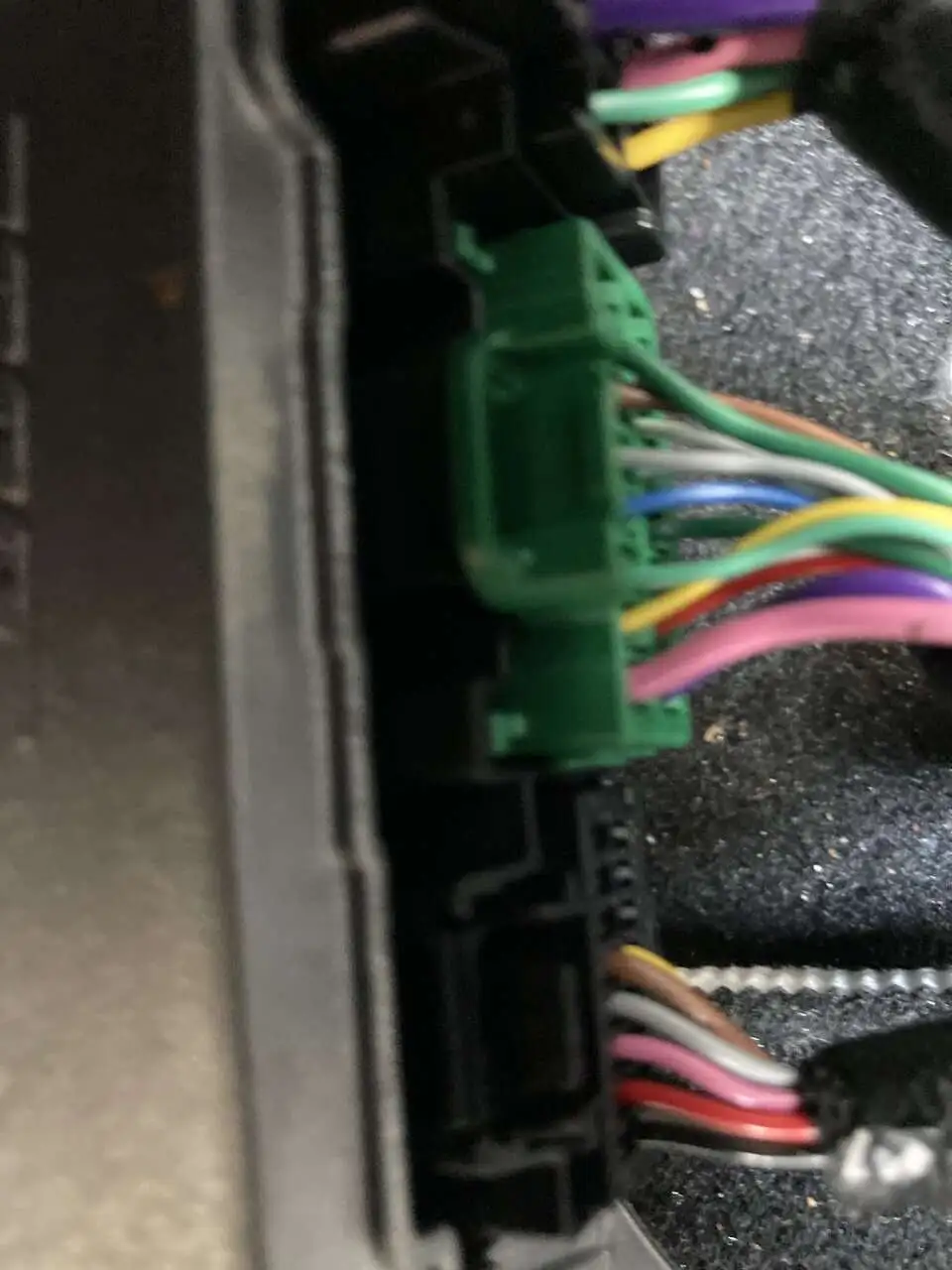

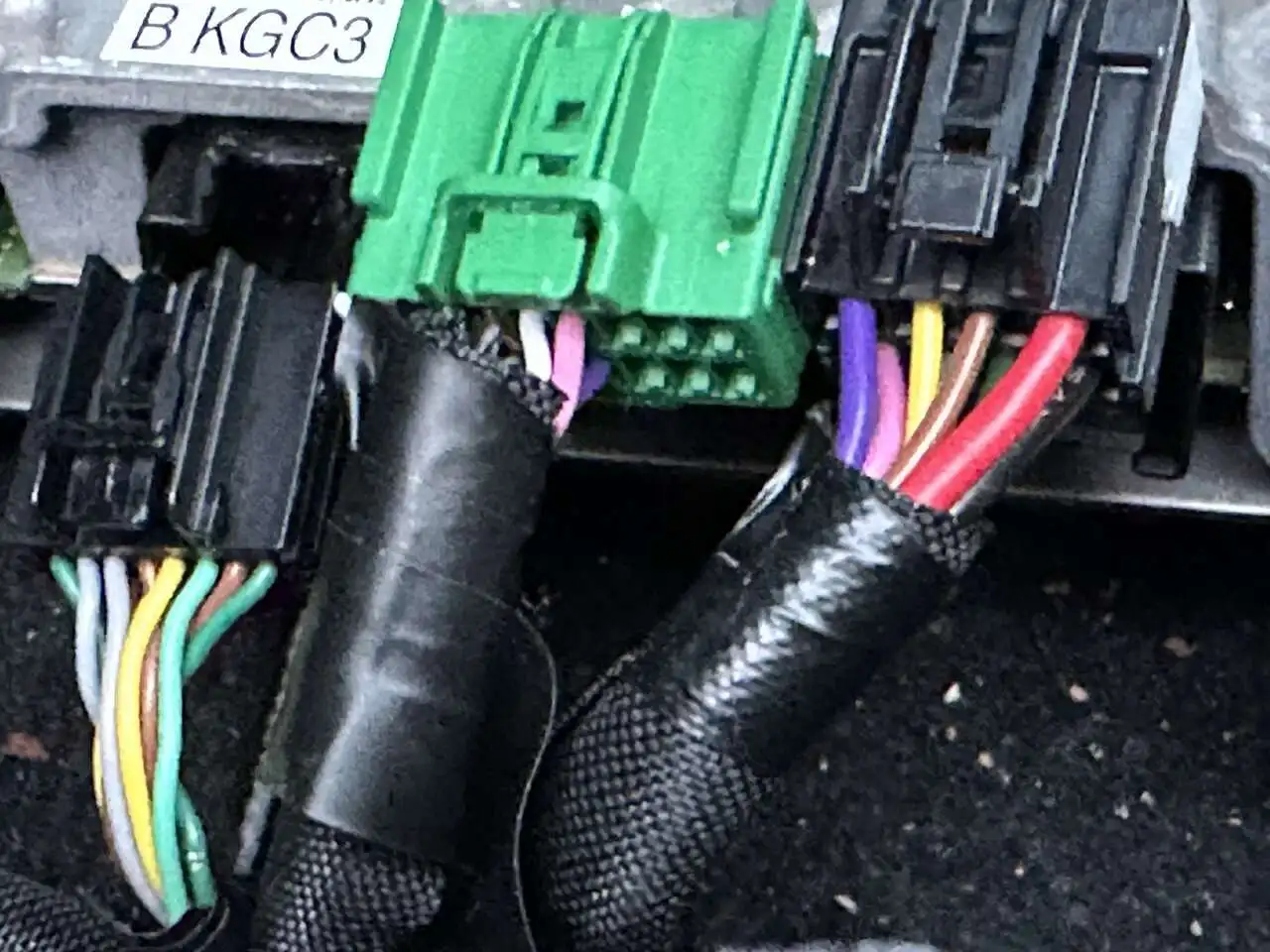

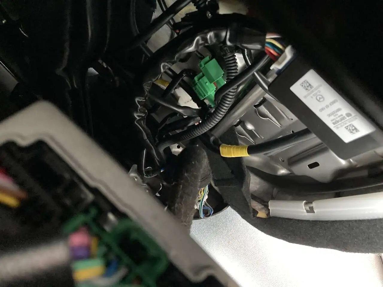

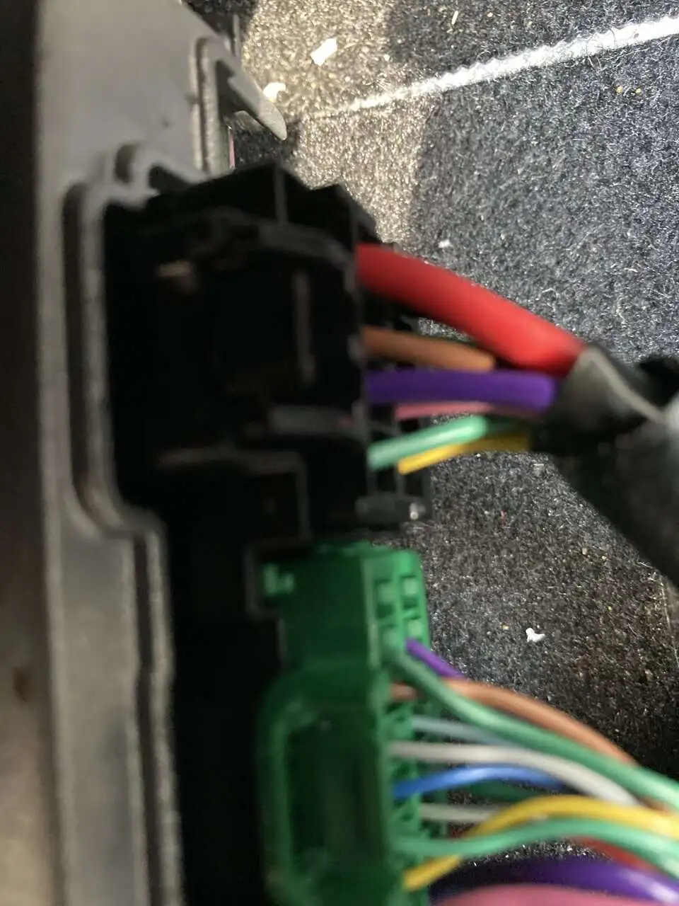

The 2024 Mazda CX-5 with Bose has different color connectors and different colored wires in different locations from my 2019 CX-5 with Bose. Here are some current pictures of the above from my 2024 CX-5 at the amp.
If anyone knows which connector is for the audio or has a correct pin out of the 24 Bose system, please let me know!
I want to wire in before the amp.[\B]

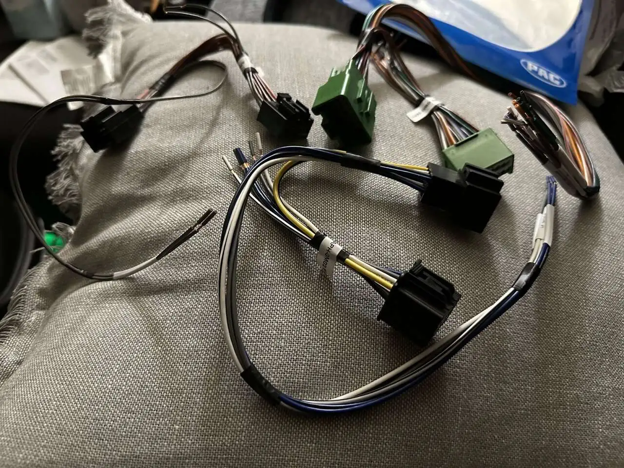

I purchased PAC APH-GM02 from Crutchfield and the connectors perfectly match (connect at both the harness and the Bose amp) on my 2023 CX-5 Sig (so no need to cut factory wires). Connector & wire colors do not match the factory connectors & wires at the Bose amp.
*got delivered with 20 minutes of lights left today and only had time to check connectors and colors before it got dark.
Upcoming days I will spend some time and figure out if this is a viable option for Mazda CX-5’s with Bose Amp…
which connector is for line level rear/front speakers and if the wires trace properly/match the OEM wiring harness. Will report back later with more information.

I purchased PAC APH-GM02 from Crutchfield and the connectors perfectly match (connect at both the harness and the Bose amp) on my 2024 CX-5 Sig (so no need to cut factory wires). Connector & wire colors do not match the factory connectors & wires at the Bose amp.

21 carbon with the Bose system. I just tapped into the sub amped-signal with some wago interconnects into the high level input on my amp. It definitely adds some good bass, but the signal is definitely tuned for the factory Bose sub.
I came to the conclusion that my car must have the updated TAU, as it has different connectors than the post for 2019s that I made the T harness based off of.
It would be nice to be able to get the signal pre-bose processing.
I got this from Crutchfield. Page 4 of 5 details the connections at the amp.
* please note this is for a 2023 and above CX-5 with Bose.

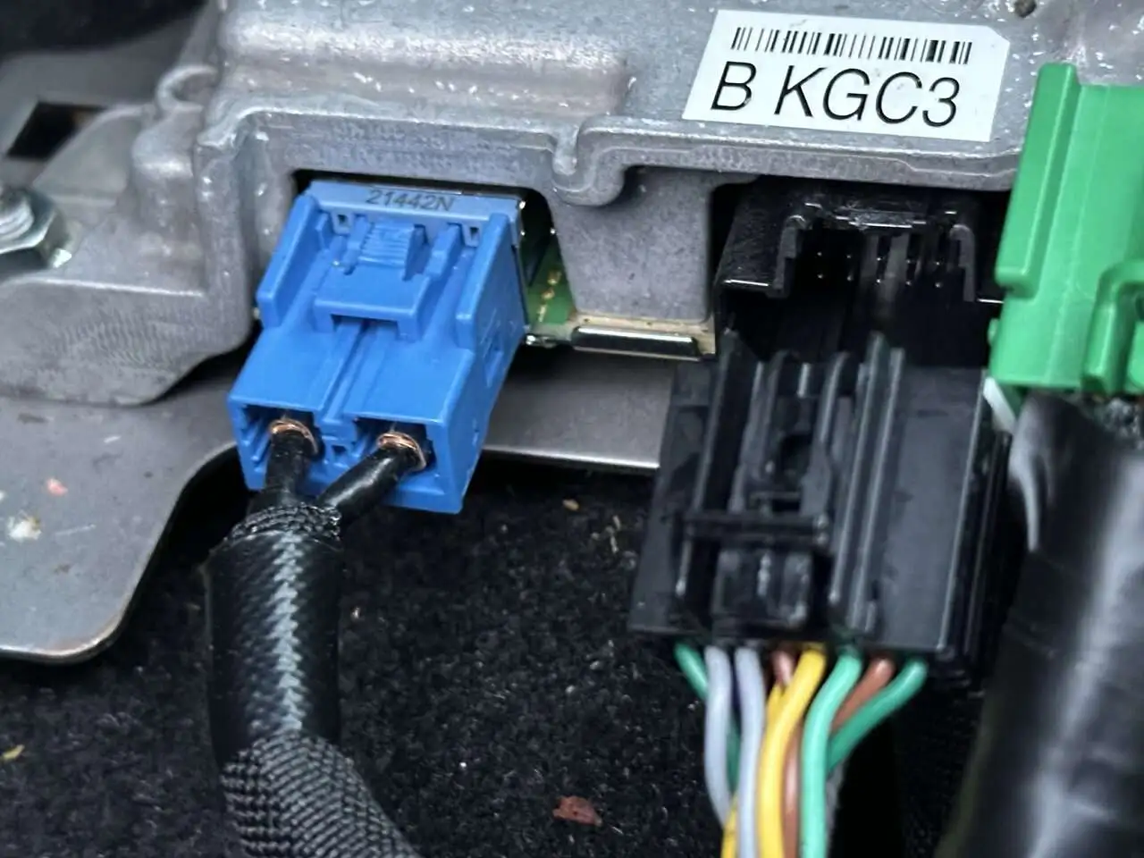

After taking some time to review the schematic - I believe the audio signal is through the optical MOST Bus connection... not low level RCA like older models.
This poses to be an issue to pull the audio signal from, without additional devices.
this thread talks about it a bit, mid way through:
I was reading on another thread and they were saying that the blue connector all the way on the left is actually can bus optical audio from the Bose head unit to the Bose amp. The connections that we are tapping into/on are the outputs to the speakers, etc.
