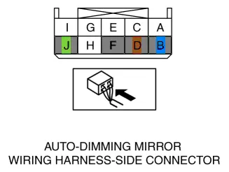

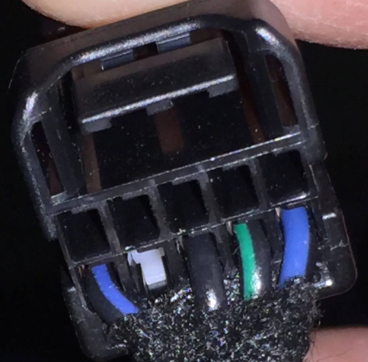

If you want to tap into your Homelink mirror I have taken a photo to help. It's simple!
Unplug the harness. Simply press down on the pressure clip (on top) and pull out. Plug the red wire tap into the bottom row solid blue (B) (bottom row far right - switched power) and the black tap into the solid black (F) (ground - right side of dead hole).

Fellas - the mirror tap took about 17 seconds to plug in and the radar mounts just perfectly !!!

Can someone confirm please that the wiring is exactly the same on a North American 2017GT w/Tech? Or did they switch the wires/colors around?
Thanks!
Thanks!
I think the colors are switched in a 2017 and its purple instead of blue. I just tapped my mirror to install a dash cam and I had to find the right one to make it turn off with the ignition. I can take a picture later for you.
I think the colors are switched in a 2017. I just tapped my mirror to install a dash cam and I had to find the right one to make it turn off with the ignition. I can take a picture later for you.
To get switched power tap the solid black and the one closest to the driver (when the plug is plugged in).
