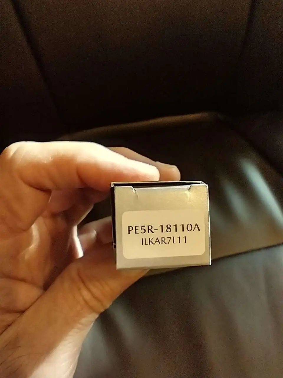

So, I just got a set of OEM plugs from MedCenter Mazda. Part number on the plug is PE5R-18110A. I'm guessing the "A" is representing a new rev? Anyone see this before?
Yes most online Mazda parts sellers have updated to this new part number on 2.5L / 2.0L NA spark plug. The added “A” definitely means something has changed. It could be Just as simple as the packaging change only Mazda knows.
There’s another new OEM spark plug PE5R-18-110-MV from Value Line parts. I asked my Mazda parts guy on the other day and would like to see it in person. Unfortunately he’s never been aware there’s such plug available. Nothing in stock and couldn’t see it in person to find out more info on this “Value” spark plug.
