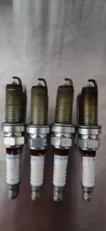

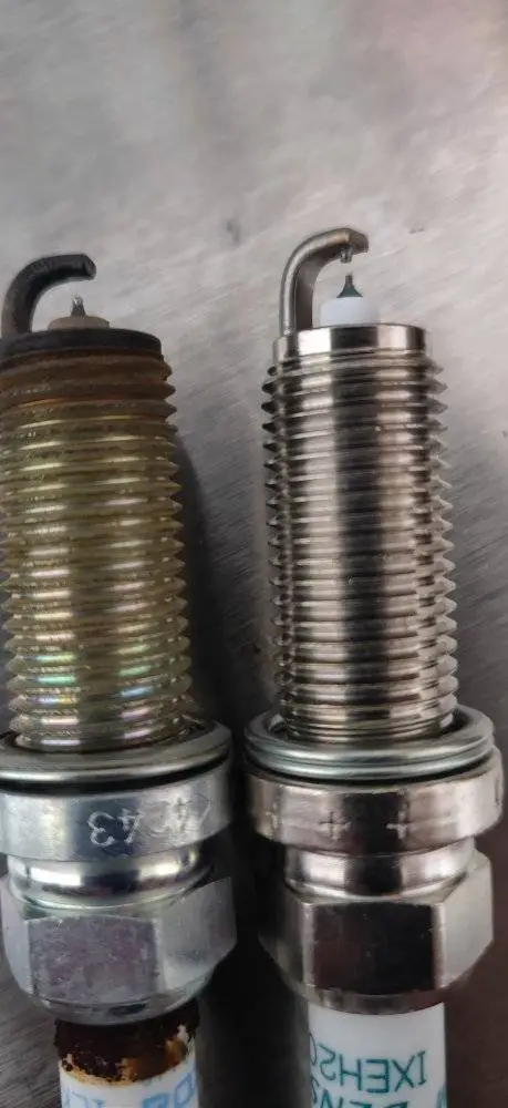

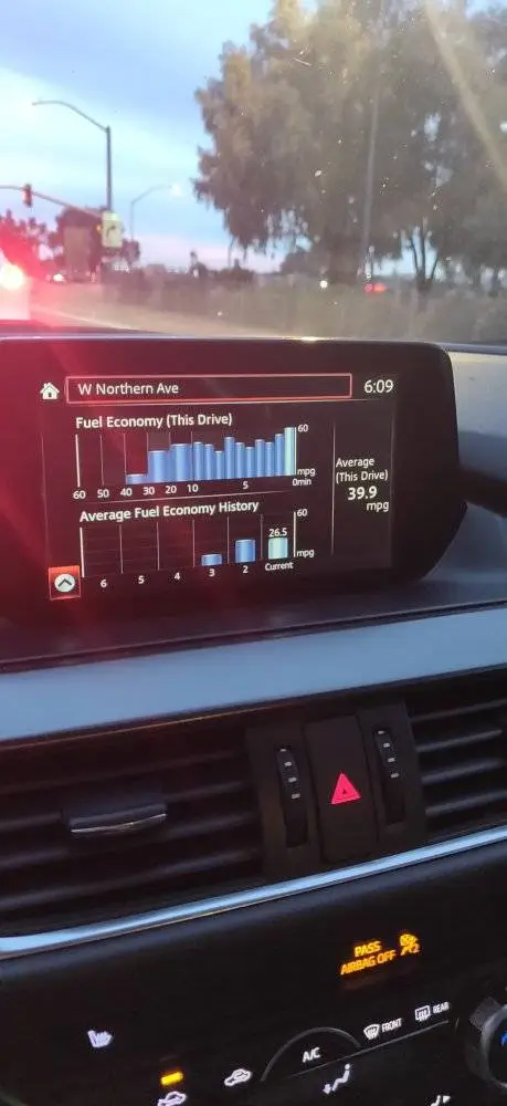

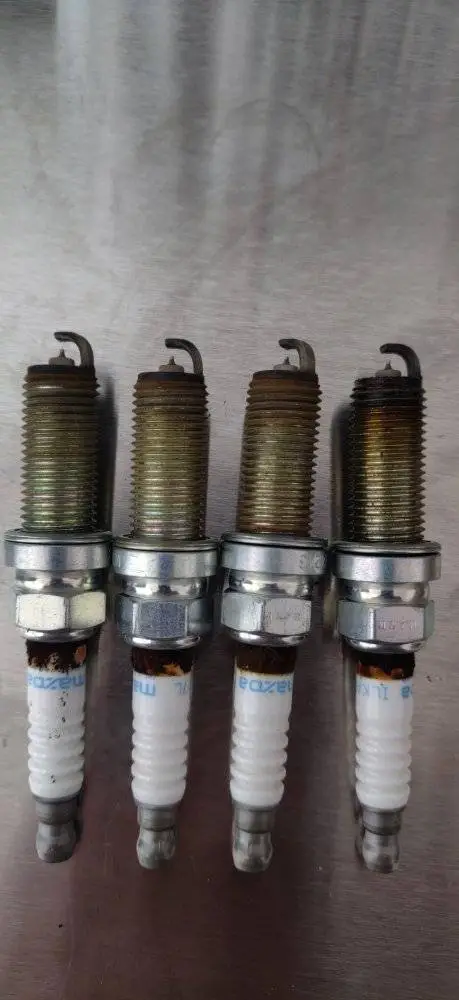

I'm happy to report that the Denso Iridium TT (4711) plugs purchased/installed this past weekend is indeed performing well for me in my 2.5l skyactiv Mazda 6. My idle is smooth which is a good indication (wasn't really bad before). That said something felt off but only the first day.
Day 1 I got mediocre mpgs on my normal drive home. I usually get about 34-35mpg I only got like 32.
By Day 2 and 130 miles later I noticed the engine was back to being peppy and this time got 38.5 mpgs by the time I got home from my regular 33 mile commute. 1/3 of my commute was stop/go due to freeway crash, 1/3 was 65mph, 1/3 was 80mph. So fairly normal commute and driving habit. (mpg pic was 3 stop lights from home). I don't get into the high 30's unless I purposely hypermile and doing 65-70mph.
Notes:
- I'm coming off a string of good luck getting parts from local AutoZone. I actually came in to purchase the NGK iridium laser plugs and the employee let me compare both the Denso iridium TT's with the NGKs side by side. I thought the Denso's looked cool with their twin tips so I purchased them. $10.29 each.
- Original OEM NGK plugs shown are from a 2.5l skyactiv engine @83k miles. Pretty decent condition but they likely don't put out as much spark as new plugs would.
- When I installed the new plugs I did not apply anti-seize. I actually inspected/removed the original plugs back at 20k or so. Then again at 83k. No issues removing them back at 20k miles...no issues removing them at 83k miles.
- My install method was to hand tighten until I get resistance from washers...then 1/4 turn.
- I cleaned the ignition coil rubber boots which will continue sealing dirt/grime from the engine bay getting into the chamber.
- The original OEM Densos that came from my CX-5 are NOT these same Denso twin tip 4711's. The said original OEM Denso from my CX-5 are conventional looking iridium plugs. So 2 different designs.
- It appears the NGK Ruthenium plugs are NGK's answer to these Denso iridium twin tips.
- These Denso Iridium TT (4711) plugs do not have the same OEM gap of .044 but rather a .040 so if that matters to you go with the OEM NGK's or OE NGK's.
- I did not purchase these simply because they were cheaper but rather Denso's claim their twin tipped Iridium alloy was marketed to produce a better ignition. I've seen many reviews of Mazda owners using these plugs so more of a curiosity for me.
- I gonna try switching from Costco 87 to 91 octane for 1 tank to see if it makes any difference in peppiness and or mpgs in combination with these plugs.
