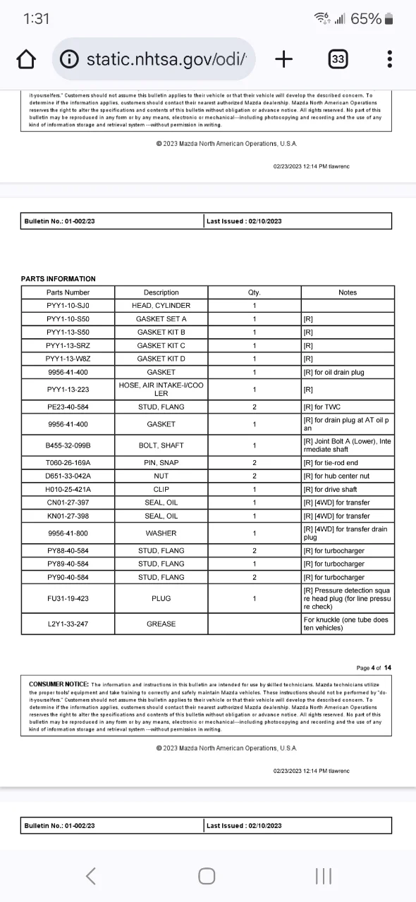

You don't need a new engine if there is no coolant mixed with the oil and the block is OK Only the head and gaskets needs to be replaced and the new oem redesigned parts are available for under $1k. Go to an indy shop and your total bill will be less than $2500.
I've been out of the loop for a while. Can you please refer me to the source info for the new OEM redesigned parts? I was not aware that Mazda had made these available. I'd like to have a 2018-20 Mazda again, but the cylinder head leaks on my old one have really put me off as at the time the only replacement parts were the same ones that failed before.
Here are the new parts:
Head link:
