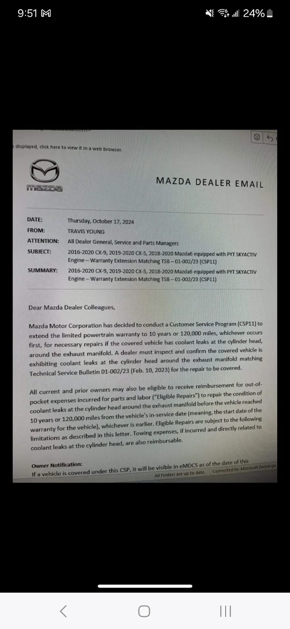

Good news all, checkout what came down from Mazda!
