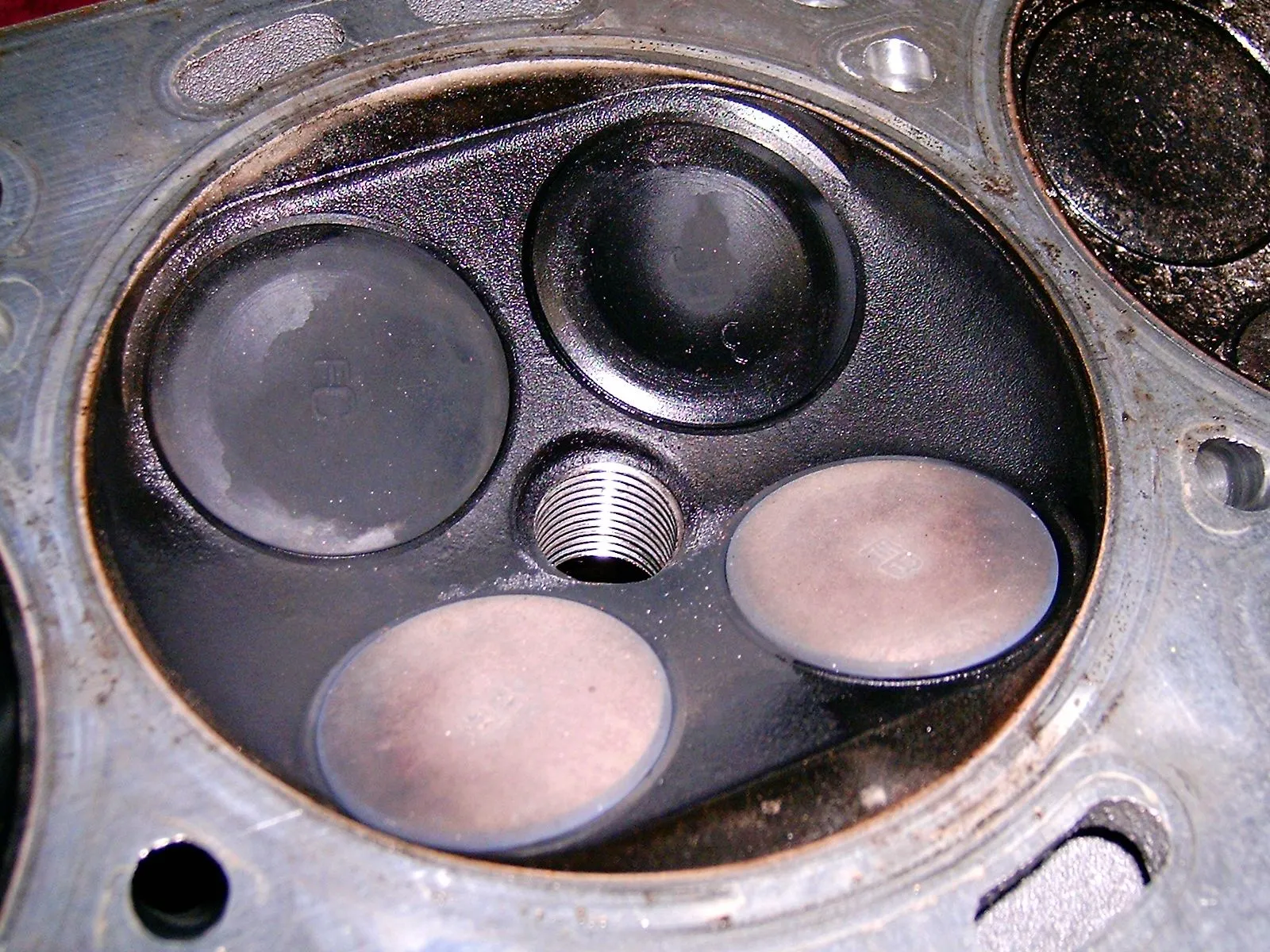

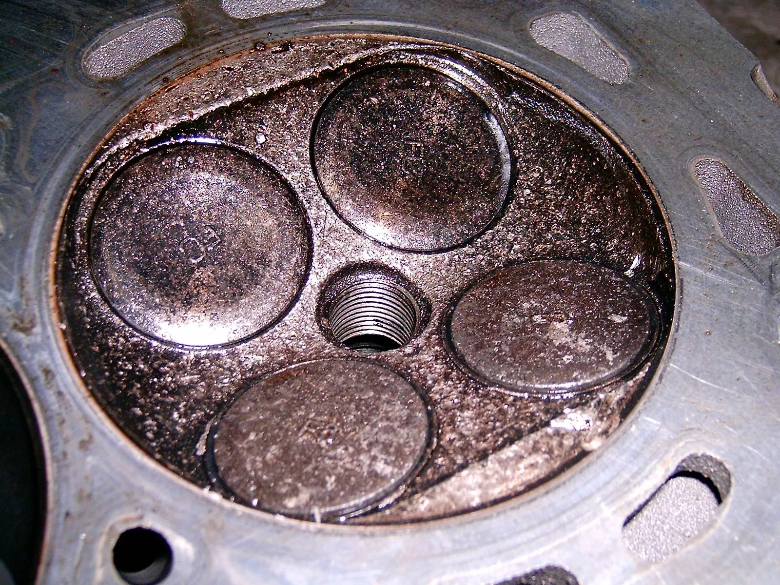

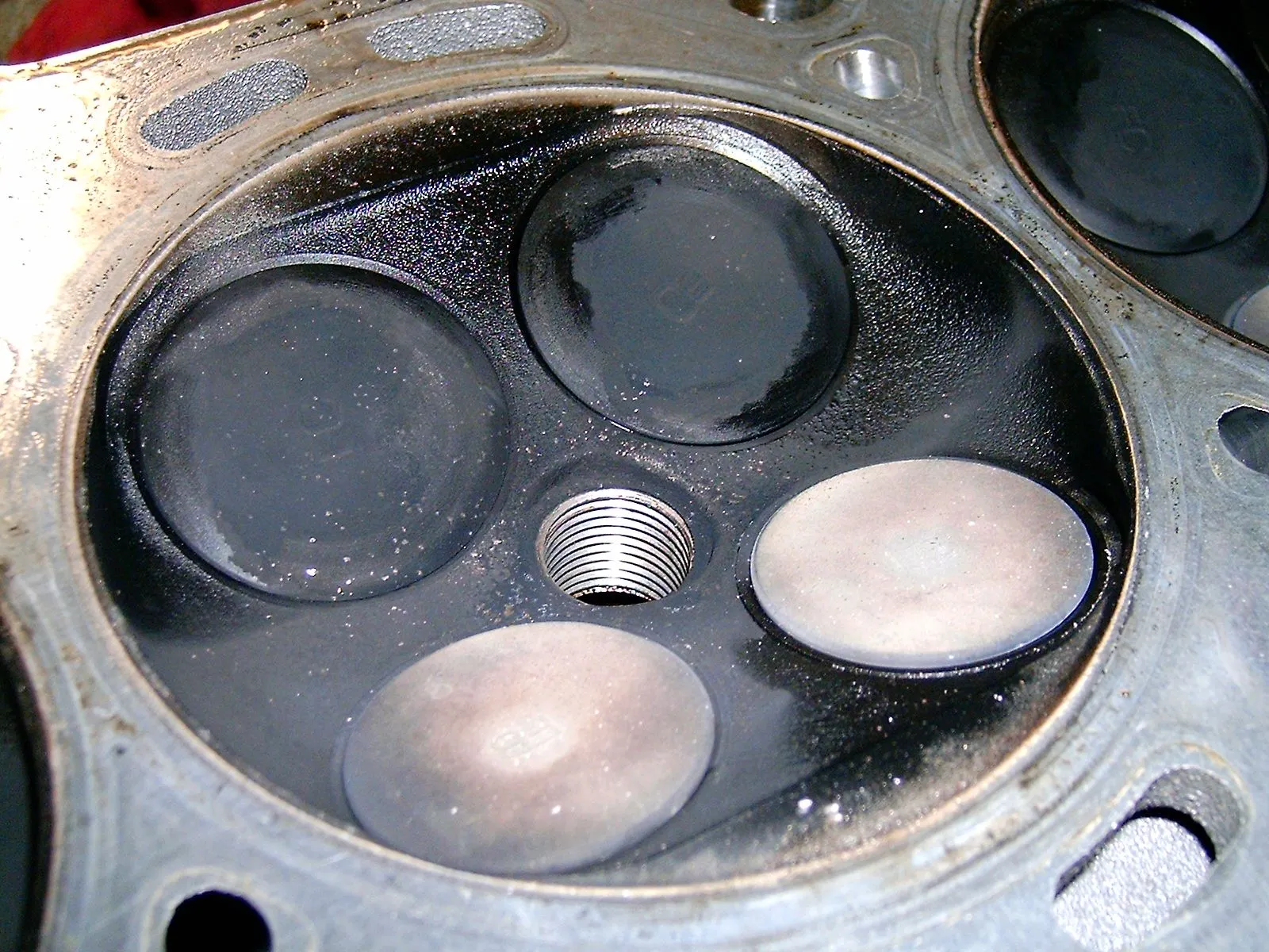

Zoom zoom BoOm x2.
cyl2. 3. 4. 1.

Looks like there was too much clearance, the rings were consequently not seated far in the grooves, they then bound with the cylinder walls and snap! Broken piston lips. Dang, I feel sorry for you man, that was an expensive build.

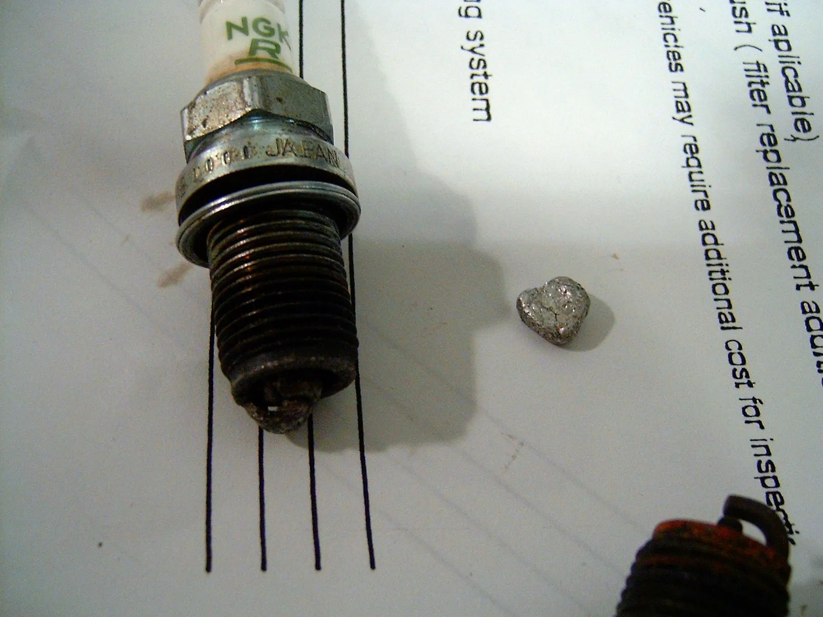

Heres the plug and a chunk of piston that came out of cylinder one.
ddogg7- There is very little scoring on the cylinder walls, very little. Even on cylinder one. I believe the block can be used if I were to give it a good hone job.
Not sure on that. It's only on 1/2 the piston lip.
Is that the plugs electrode and tip fused together ?
yes. Well at least bent over. The camera makes everything look like detonation marks. I didn't use a lint free cloth when cleaning the oil and fuel off.
However on cyl.1 I have no idea. I do know that you could hear pieces flopping around inside when I drove it off the dyno.
Well sure, it wouldn't bind everywhere, just in one spot. Especially if the clearance was too much, the piston would be against the wall on one side (impossible to bind since the ring would be seated furthest in the groove here) and the extra looseness on the other wall would cause the ring to fail and bind, thus breaking the lip in that area... (rockon)
