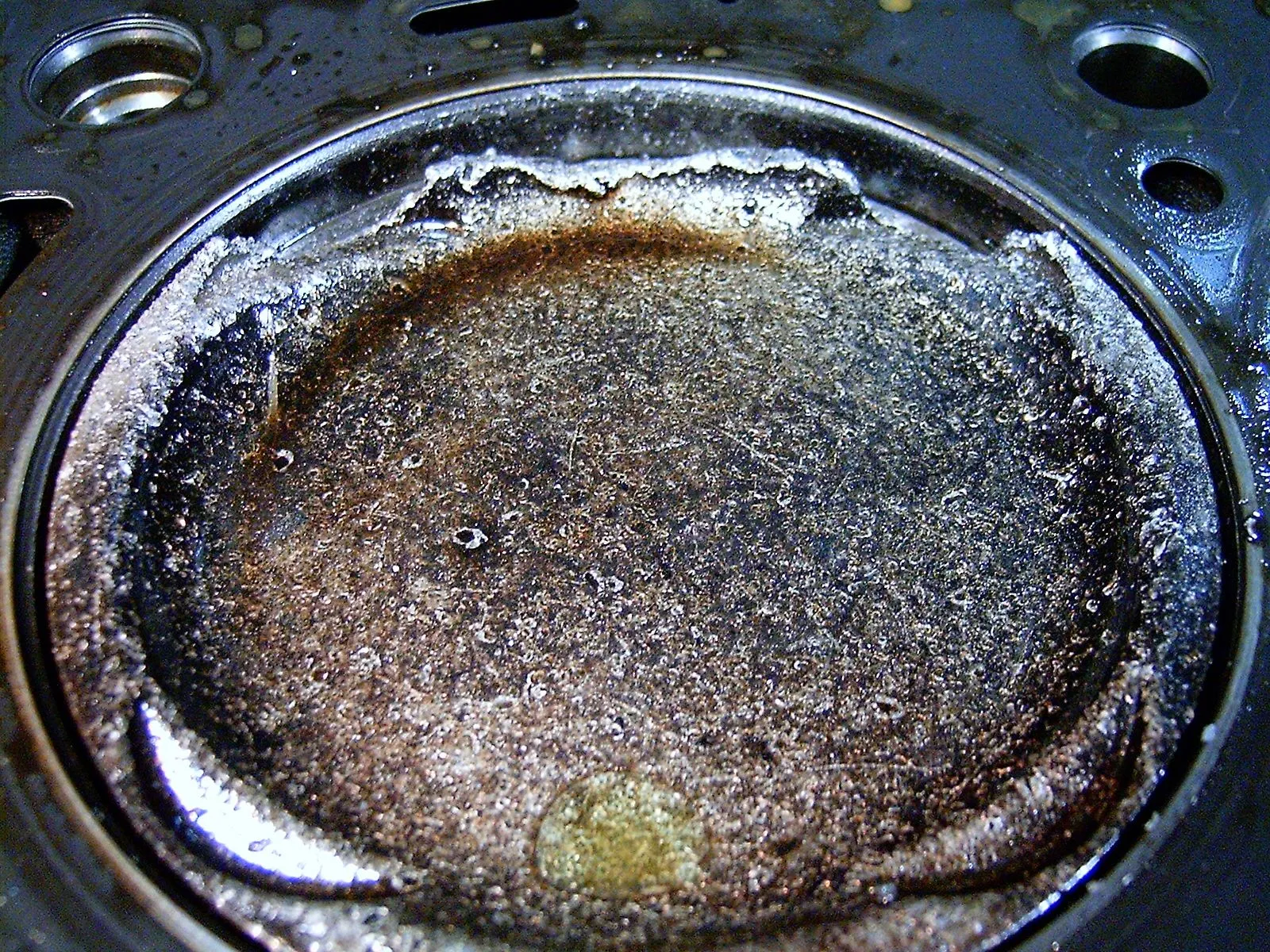

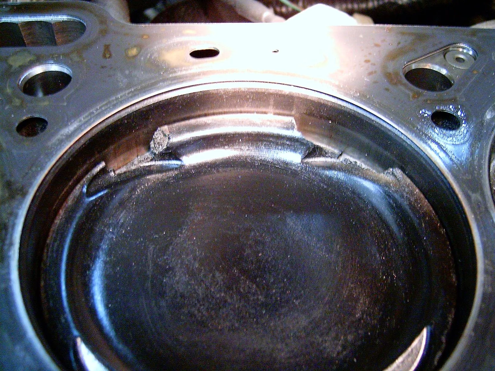

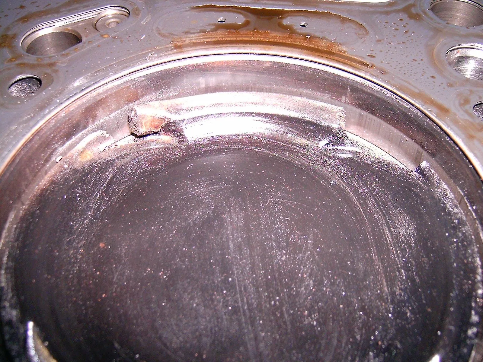

I will post pics. up later tonight of my disaster. No valves hit any pistons. The only thing I can think of is the pistons rocked in the bores and broke. Again, no detonation marks whatsoever.
I didn't get a copy of the dyno sheet. I was only going by what I looked at, at the dyno. I could have sworn I saw 263whp at or below 4200 but the guys that actually took the dyno sheet told me it was more like 3300. Either way it was doing good...until.
I believe pdhaudio just had the bottom end done. I don't think they touched the head. I did every trick I knew, and some I didn't. What it put out doesn't really matter at this point. It is still a pos, and slow.
The rings probably got toasted when the engine over-revved. Our longer stroke means very high speed piston movement. They then could have destroyed the pistons...What piston/cylinder clearance were you running and what rings did you have?
I have no idea what the piston/cylinder clearance is. Thats one thing I didn't/don't have the tools to acurately check. I am thinking it was alittle too much, and once you see the pics. I think everyone will agree. The rings were the cp ones.
However Cyl. 1 broke before going on the dyno, maybe during the 140mph jaunt that I did on the way to the dyno.
You mean we will be able to tell by the pictures that the clearance is too much? That isn't good... :)
Thats not what I meant. I meant by the way they broke....Anyways here we go with the horror show.
Cyl2. 3. 4. and 1. Maybe 1 didn't get any fuel?
