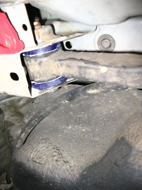

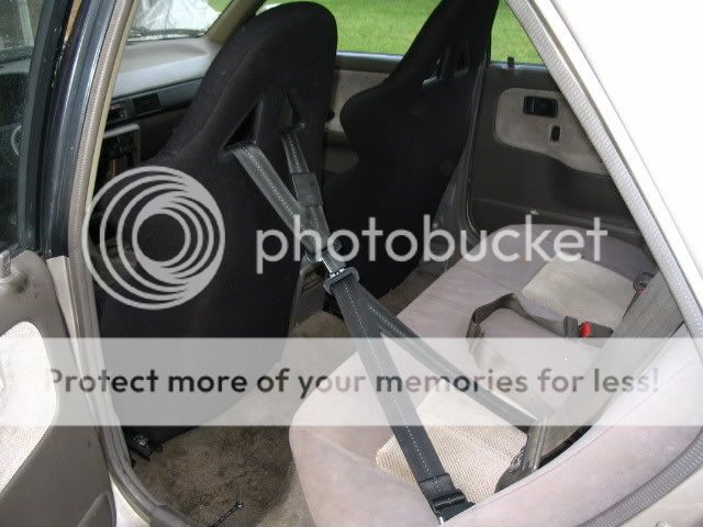

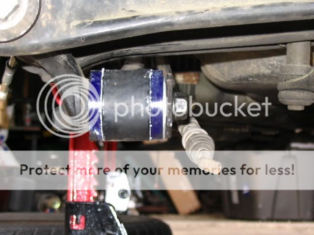

Progress is a little slow right now. Waiting on some money and parts to come in. Seats are both in and driver's harness in. Trailing arm bushings done. The rear wheels should be on their way after the 20th. Header should be ordered next week.

The Momos are only 15lbs each so not much weight savings. I've driven a car with the Summit seats in it and I really didn't like it at all. They weren't very effective at holding you in while cornering. That was a DSP car.

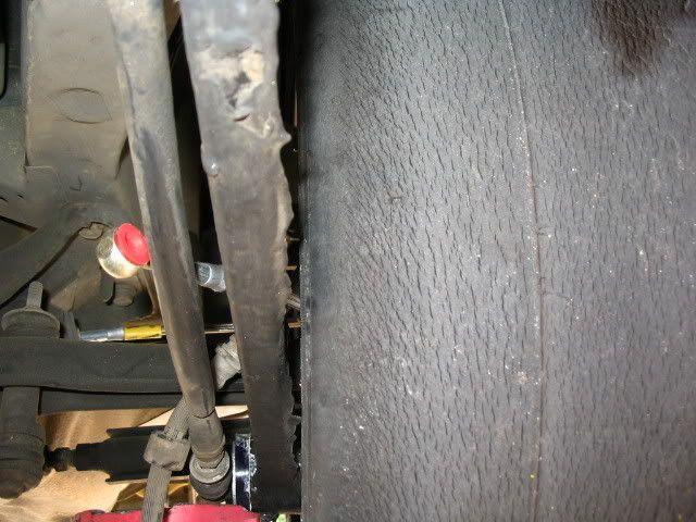

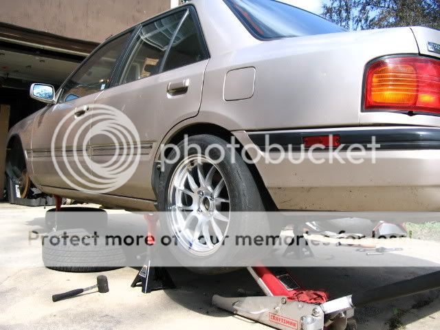

Rear wheels came in today. 949 Racing 6UL 15X8s.
Looks like I'll need a very thin spacer (around 3-5mm) to make sure the tires clear the struts.
The tires sit really close to the trailing arms, but I'm thinking it might be toed in a hair on the rears making it look worse than it will actually be. The pictures were taking with the lateral links level with the ground. It looks like I may be able to get away with not having to hack up the rear quarters.
