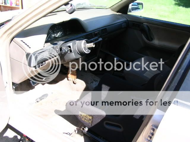

Not much going on this week. I'm waiting for my paycheck/rebate check to order the header, exhaust and wheels. I did get around to installing the driver's seat and steering wheel hub.

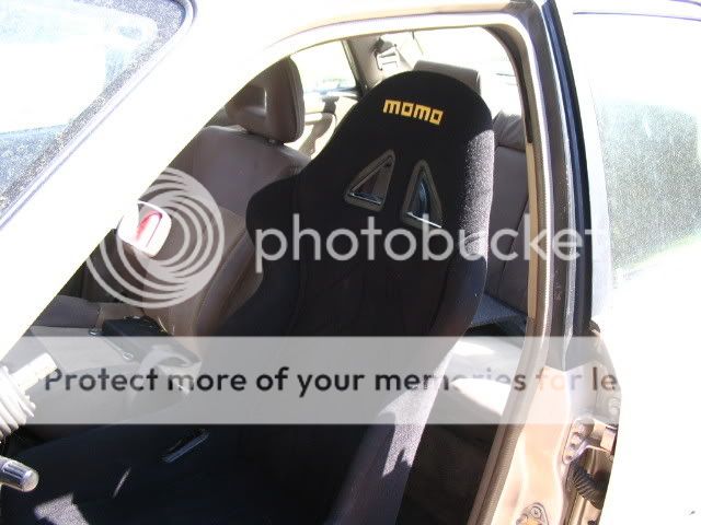

My SanDisk card reader for the digicam isn't working so no new pictures. I'm not doing much at the moment. Waiting on some parts from Cali and Atlanta. The Momo seats are in and the steering wheel in. I installed a set of poly bushings in the rear trailing arms and got all 4 struts in and bolted down. The only big things left are Exhaust, wiring, swaybars, wheels/tires.
