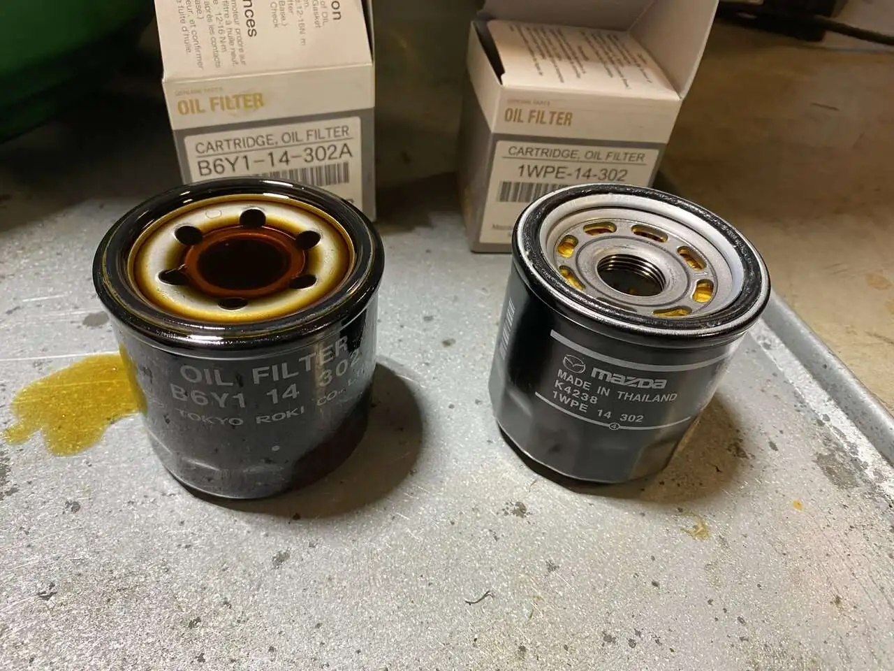

I screwed up. Just changed my oil in a 2015 CX5 and put on the same filter as last time. I used a Genuine Mazda B6Y1-14-302A Oil which I believed was the correct filter and I just discovered it isn't and I should be using the 1WPE-14-302 filter instead. It fit fine and was the same as all the other filters I ever installed but wondering if I should take it off and put on the correct one. I couldn't find the difference but if I look up cross references to other brands they both point to the same filters for both the correct and incorrect Mazda filters. It appears the B6Y1-14-302A is for older Mazda models. Should I dump the fresh oil and install the correct filter or just leave it until the next change?

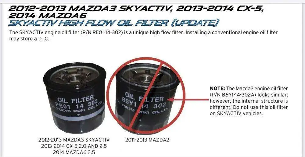

Here’s a document from Mazda North American Opetations:

Like Madar said above, since you just did the oil change you can simply remove the B6Y1-14-302A oil filter and install the correct OEM 1WPE-14-302 (Denso made in Thailand which superseded the Tokyo Roki made in Japan PE01-14-302A/B) and you won’t lose much oil during the change. Just keep the old filter straight up and you can dump the old oil in the filter into the new filter before the installation if you want to save about 0.3 quart of the fresh oil. Keep in mind you may still need another 0.2 ~ 0.5 quart of fresh oil even if you did that because there’s oil situated in the filter element which won’t come out.
Honestly, I may just feel lazy not to do anything about it if I were you, as this’s no different from a lot of people who use “one-size-fits-all” aftermarket oil filter on the SkyActiv engines. Just plan to change the oil as early as you can next time with a correct OEM oil filter. But this’s definitely an ill advice if you want to keep the CX-5 as long as you can.
I agree with the others who are suggesting to just change the filter. At most you'll lose half a quart.
I went to the dealer and got the Thailand filter, was only $8 and hardly any oil was lost just changing the filter. Thanks for all the info.

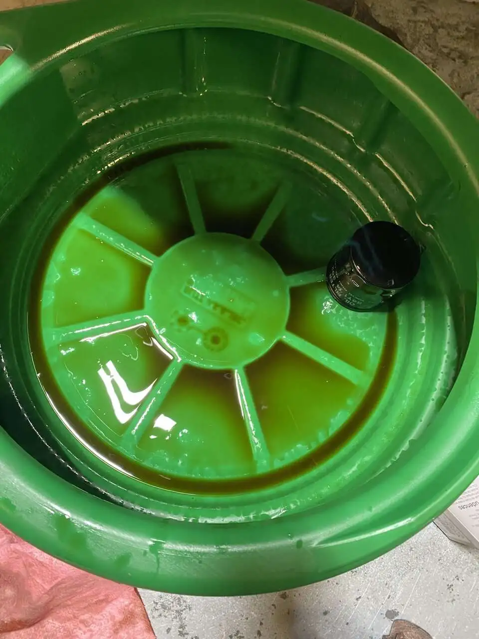

Added a small amount, this is all that came out.
