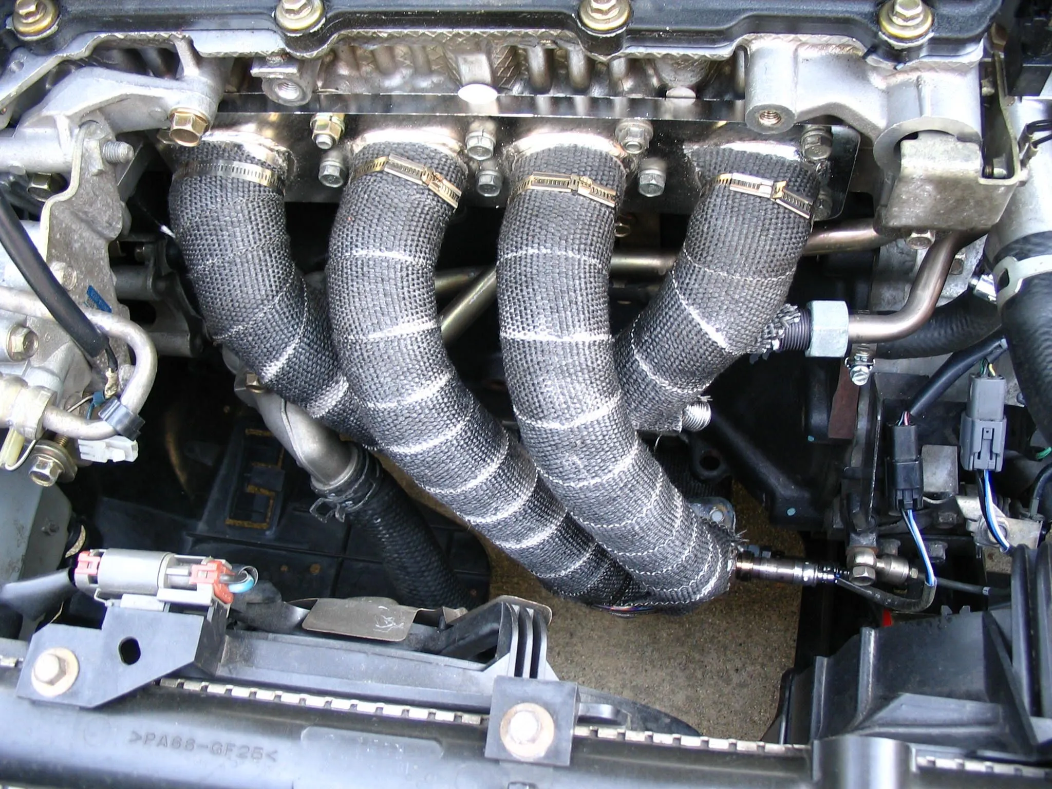

Here is the wrap on my header. It doesn't look bad if you take your time with it.
