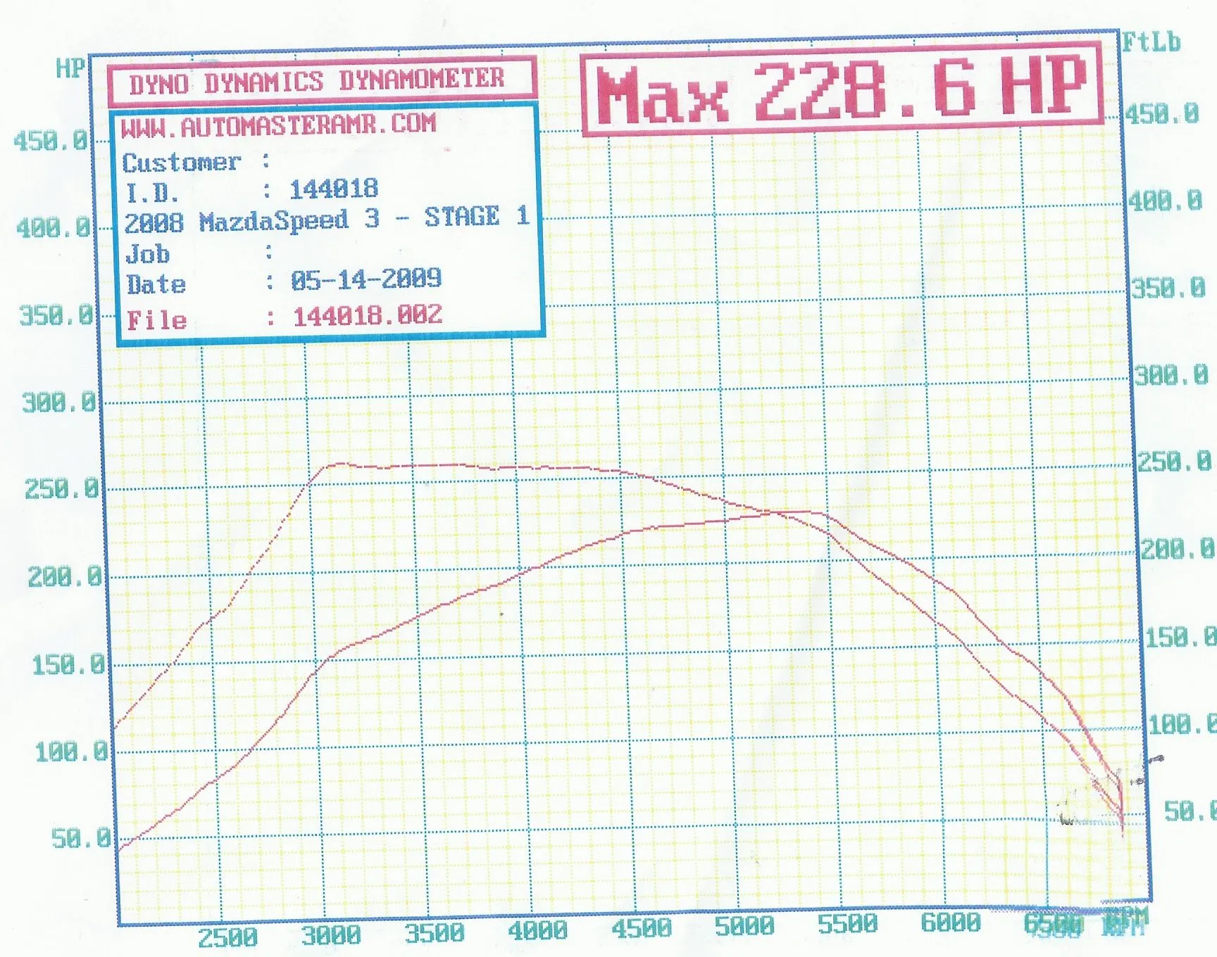

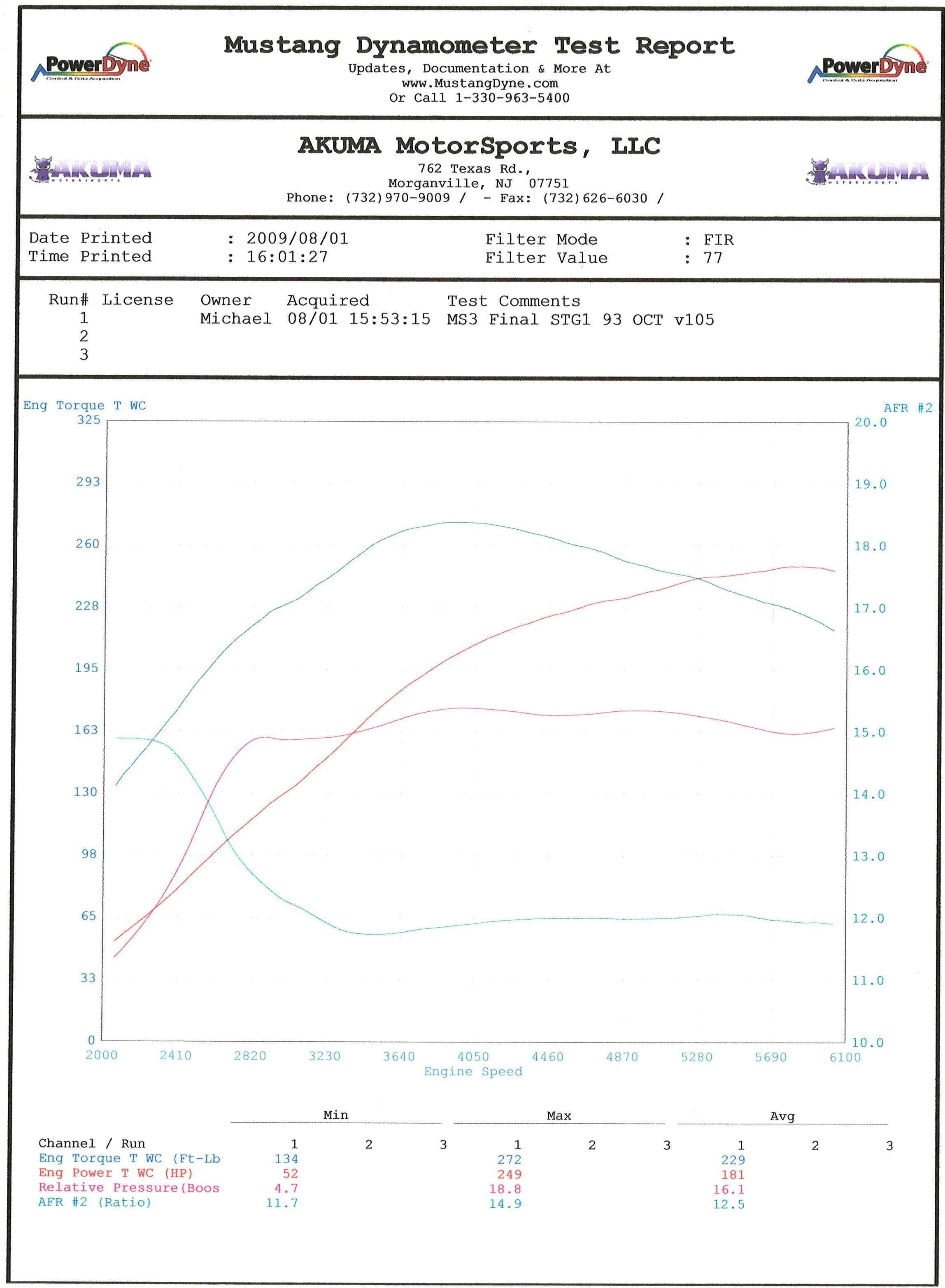

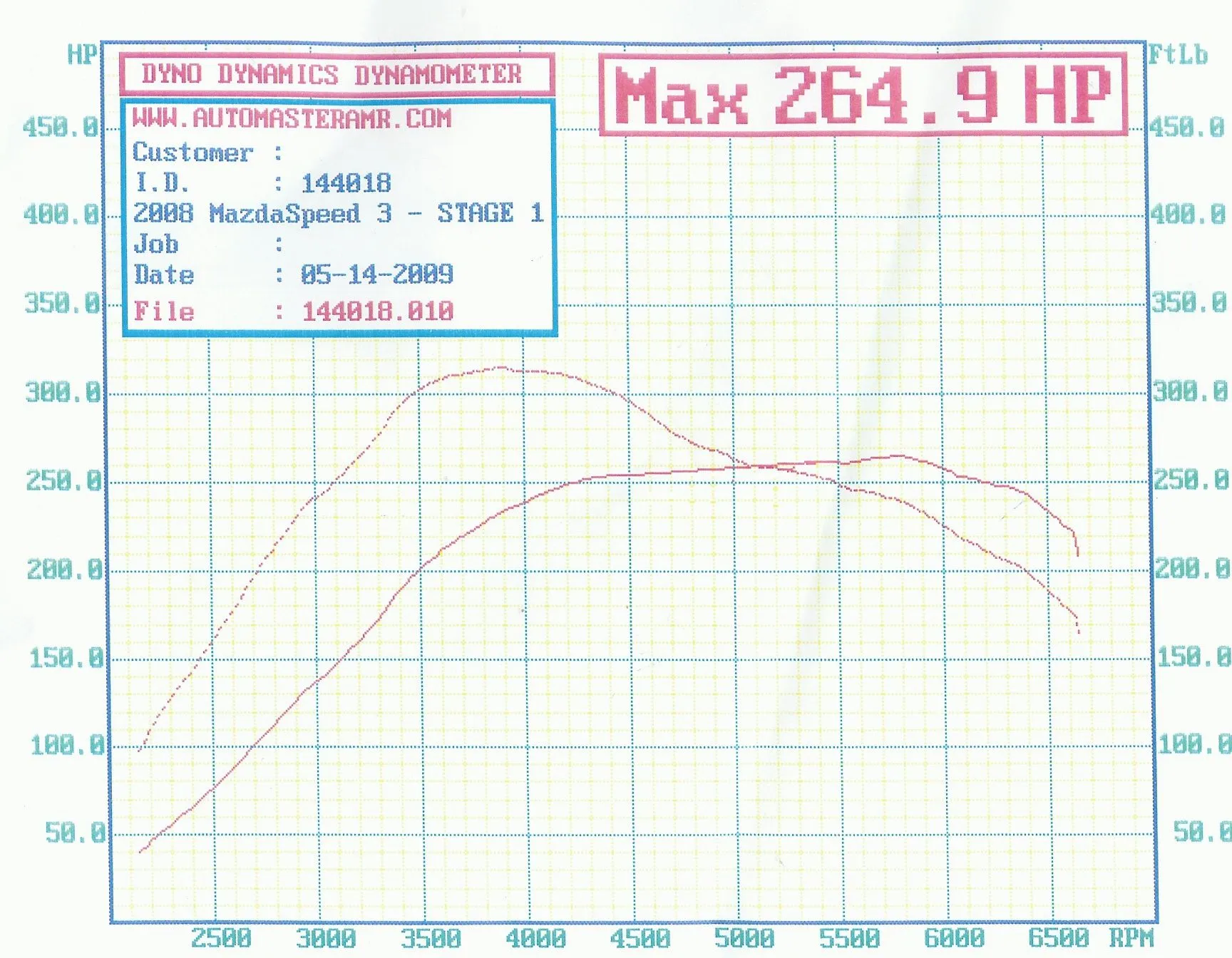

I call shenanigans. The only way that an AP would give you 50 HP is if the holy spirit manifested himself in the form of an AP, and then found its way to your super jesus car.
see attached dynos, ive since been retuned and put down 250whp/275wtq on a mustang dyno. the AMR tune put down 230/260 on the same mustang. so ive got a bit more power now. Jesus Rocks!

there is no way you gained 50hp. maybe you had a boost leak on the stock air box or something and when you got the intake. you sealed up the leak somehow but 50hp gain isnt happening unless your car is a superduper factory freak
a leak wouldve caused trims to be off, not power. this is a protune not OTS. The first pull was with all my mods on and no tune. if I had any sort of power robbing problem it would show in both pulls since nothing was touched under the hood.

suprised no one bashed the 100whp/tq increase at 6-6.5k
not bashing man, just sounds really inflated. one b/c it looks like you said you achieved these numbers on different dynos.
50hp doesnt sound possible with an intake and tune.
i shouldve elaborated. the first two dynos were at the same shop when i got my first protune. I had all the mods in my sig already on the car. first run (228hp) was on the stock tune. tuned run was amr's custom map (265hp) set to 20psi. I then went to akuma and did a baseline pull of that map on his mustang dyno. That dyno rated amr's tune at 230whp/260wtq. this is expected b/c a mustang reads lower than any other dyno. I was then retuned at akuma and put down the 3rd dyno graph posted. The reason i got retuned can be found here: http://www.mazdas247.com/forum/showthread.php?t=123743268
