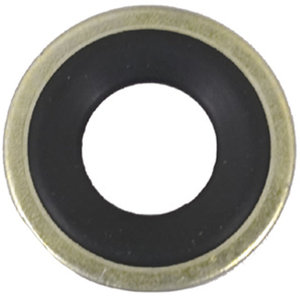

I've been using these - drain plugs with rubber gasket. They seal very well. I get them at Autozoone - about 4 for 3.00
you mean "drain plug washer" with rubber gasket? That's what it looks like, anyway.
