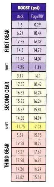

IMHO, the best alternative to the stock BPV is the stock BPV. If it ain't broke, don't fix it. The Grass Roots article can be read two ways: Under lighter load in the lower gears, the Forge seemed to have quicker release and recovery. But under fuller load in third gear where the ECU's engine nanny is not holding power back, the stock BPV actually held boost as much as 1.5 pounds higher than the Forge. Go figure.
Unless the stock BPV can be shown to be leaking there is no performance based reason to replace it. The ECU nanny, if you have stock tune, is not going to let you produce any more power in first and second gear anyway. That negates any paper advantage of the Forge, IMHO.
Give me more boost from third on up. With my mods I'm spiking to 21-22 psi and holding steady at 17 psi, occasionally 18 (with load cut when that happens), so I'm very, very happy with the stock BPV and have chosen to spend my hard earned cash on mods that actually make power.
Grass Roots chart attached.
MSMS3, just for the sake of discussion and not for any other reason. The point of the Grassroots graph is that the Forge closes quicker. Make no mistake folks, a better valve does Not make more power, but it might get you down the track quicker! Thank you for taking the time to put up the real info, sir! My rule of thumb is, also if it ain't broke do not fix it but if it does break, upgrade!!
