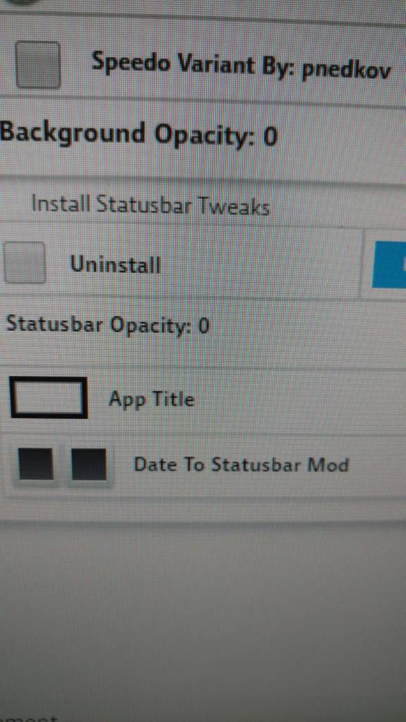

Did you download the app yet? Please do that. You can freely play around with that and hurt nothing. Every feature has 2 little check boxes.
INSTALL and UNINSTALL. Check off the things you want to install, and hit compile. However, before I hit compile, I took a picture on my phone of the screen of what I turned on. Which was only 2 things, but I am kind of anal about doing everything by the book and perfect when it comes to hacking anything, phones or cars.
I then saved that picture in my Dropbox in my "CAR" folder. ;) So when I want to revert, just in case I somehow forget what I've installed I have that pic to do the uninstall.
Open program, check uninstall, compile.
Easy Breezy.
I think there is an even easier way to uninstall \ revert but my 'system' seems pretty foolproof. Just like I like it.
