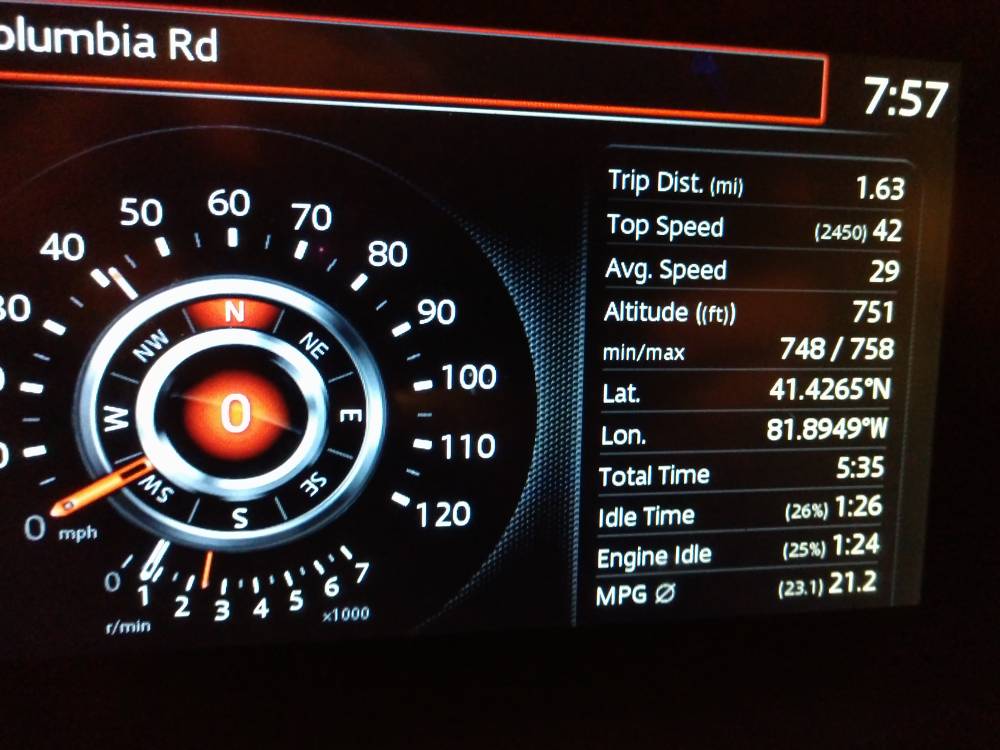

I do like having a different wallpaper. Sucks Mazda won't give you any choices like some companies do. The Speedo is neat. I'm surprised how much info it pulls. Where does it get altitude from?

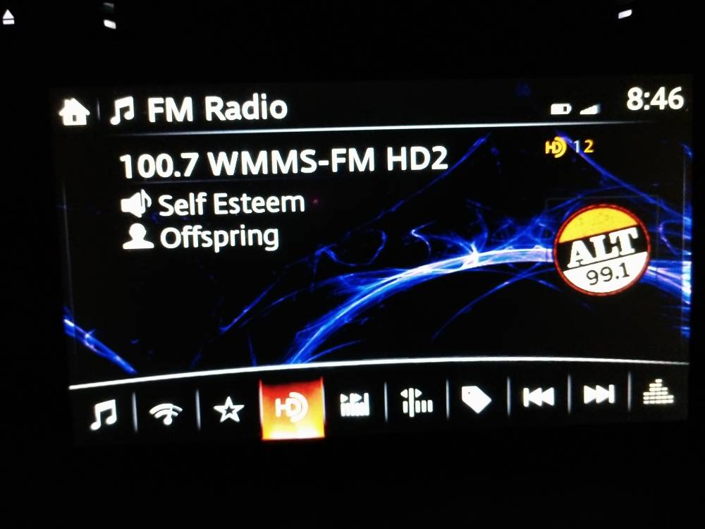

7er... stop posting screenshots and making me jealous of what I can't have :p
+1 jelly of 7er AIO shots post hack

OK, no more pics. (spin)
That speedo is REALLY neat! Now I want it.
Altitude [elevation, actually] comes from GPS.
