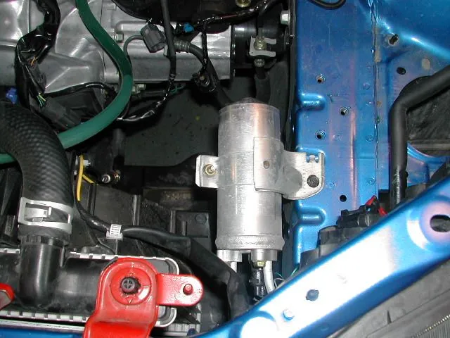

hmmm i made an assumption. The intake side of the turbo is facing the AC compressor ... i thought id have to remove it to put my intake piping there
if youre careful, you can bend it. her ei swhat i did on my first turbo kit.

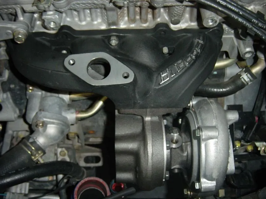

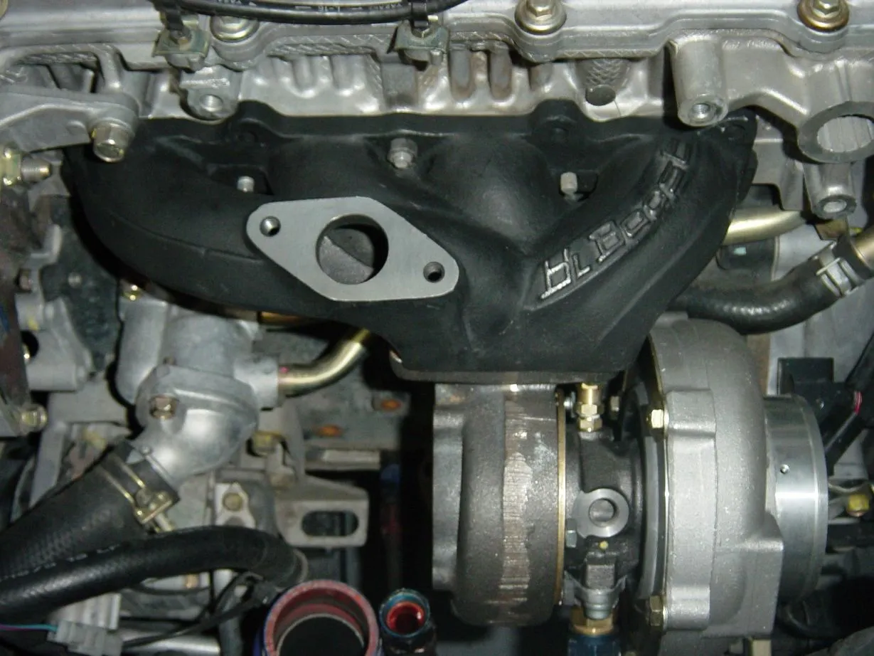

You do not have to take the AC off the car. The short manifold makes the turbo to spool faster and the difference is not noticeable between the short and the equal lenght manifold.
Here are some pics:
