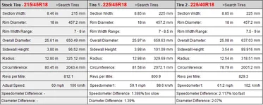

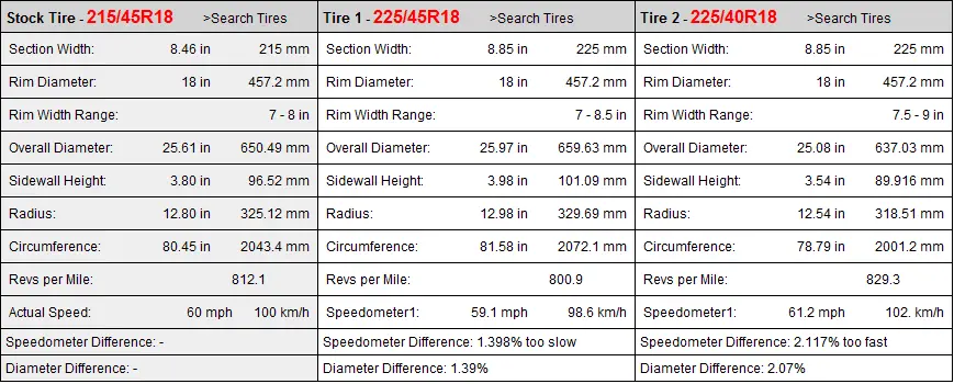

actually 225/45/18 are closer to stock size.
diameter
215/45/18 - 25.61"
225/45/18 - 25.97"
225/40/18 - 25.08"
with 225/45/18 your speedometer will read 1.398%
slower diameter differences is 1.39%
with 225/40/18 your speedometer will read 2.117%
faster diameter differences is 2.07%
with that said, i have run 225/45/18's since i ditched the stock tires and have never had any problems.

The stock tires are 215/45 which makes the sidewall height 96.75mm. The reason it is encouraged to go with a 225/40 instead of a 225/45 is with a shorter sidewall on the 40-series you will be going slower than your speedometer says. Whereas with the 225/45 you will be going faster than what your speedometer says. Does that make sense?
Yes that does make a lot of sense. Thank you very much to both of you. I guess I will go with 225/40 now. That is what I was hoping to be able to get in the first place. So I guess it is okay that the diameter difference (around 2%) will be greater with these as opposed to the 45's? I think I saw that less than 1% was desirable but less than 3% is acceptable.
