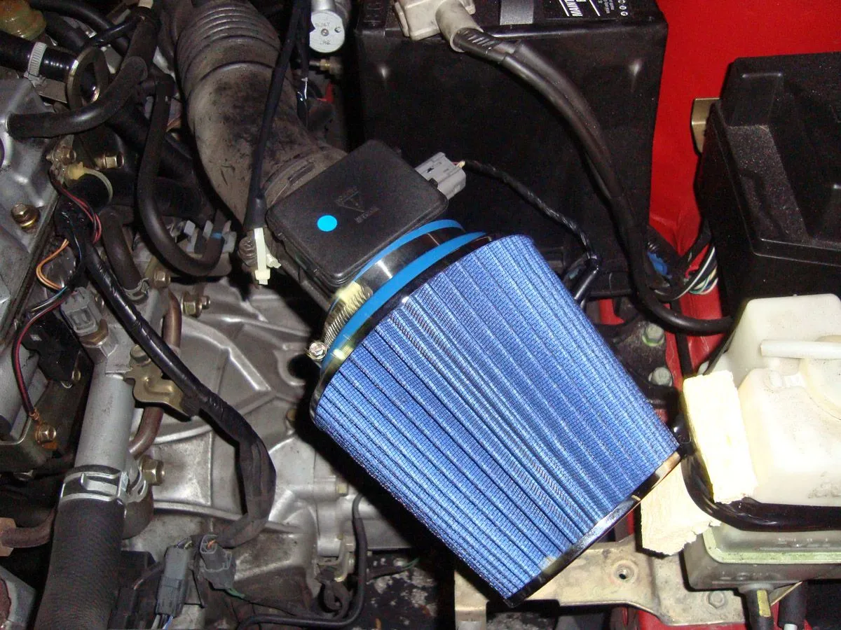

ok lol i couldnt stop laughing while taking these after work.

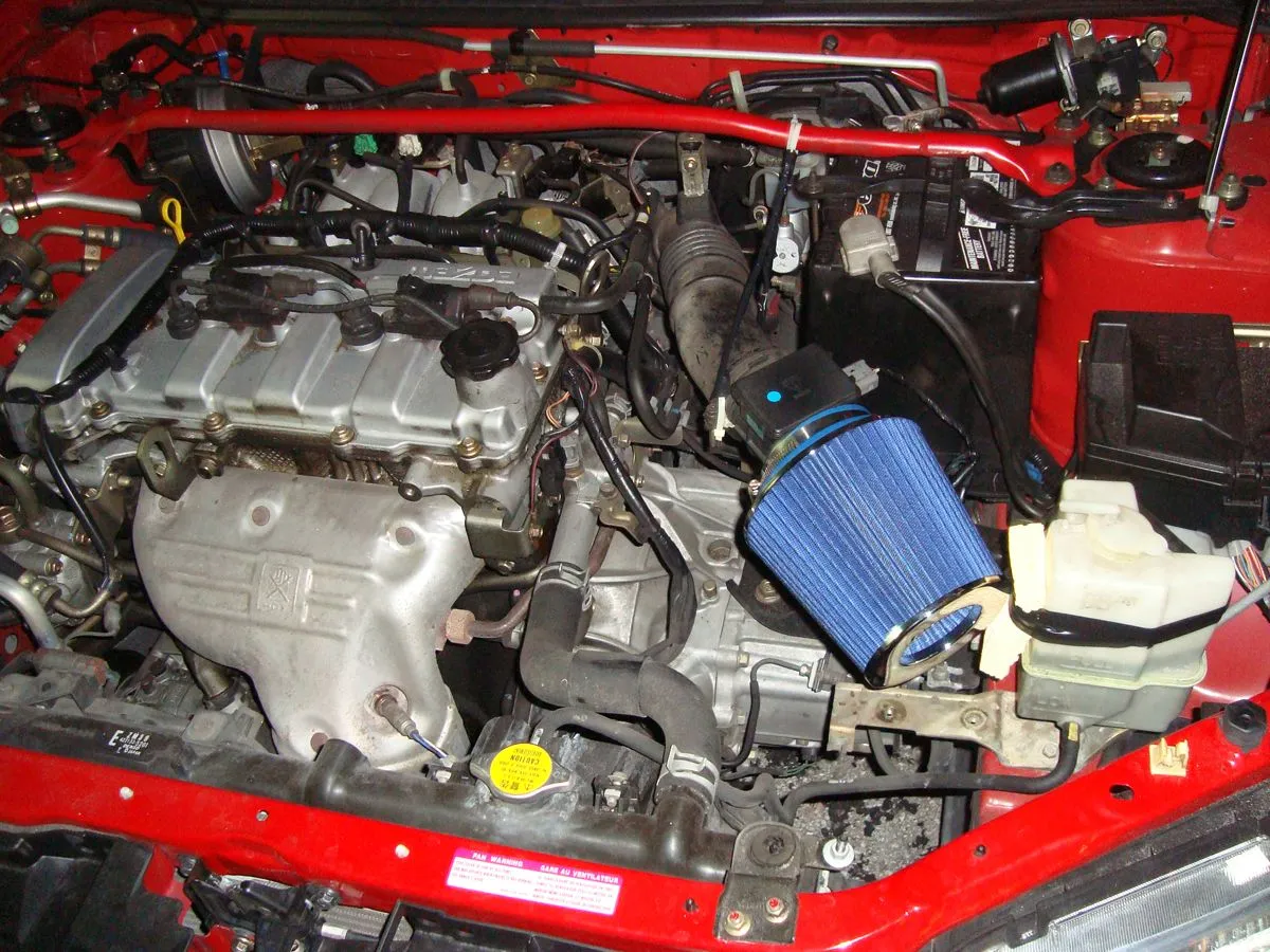

So the first picture is a shot of the whole engine bay (duh)
As u can see in the second picture that IS a sponge cushioning the cannister from the intake. The reason we did that is because it was the only position we could keep the intake from moving.

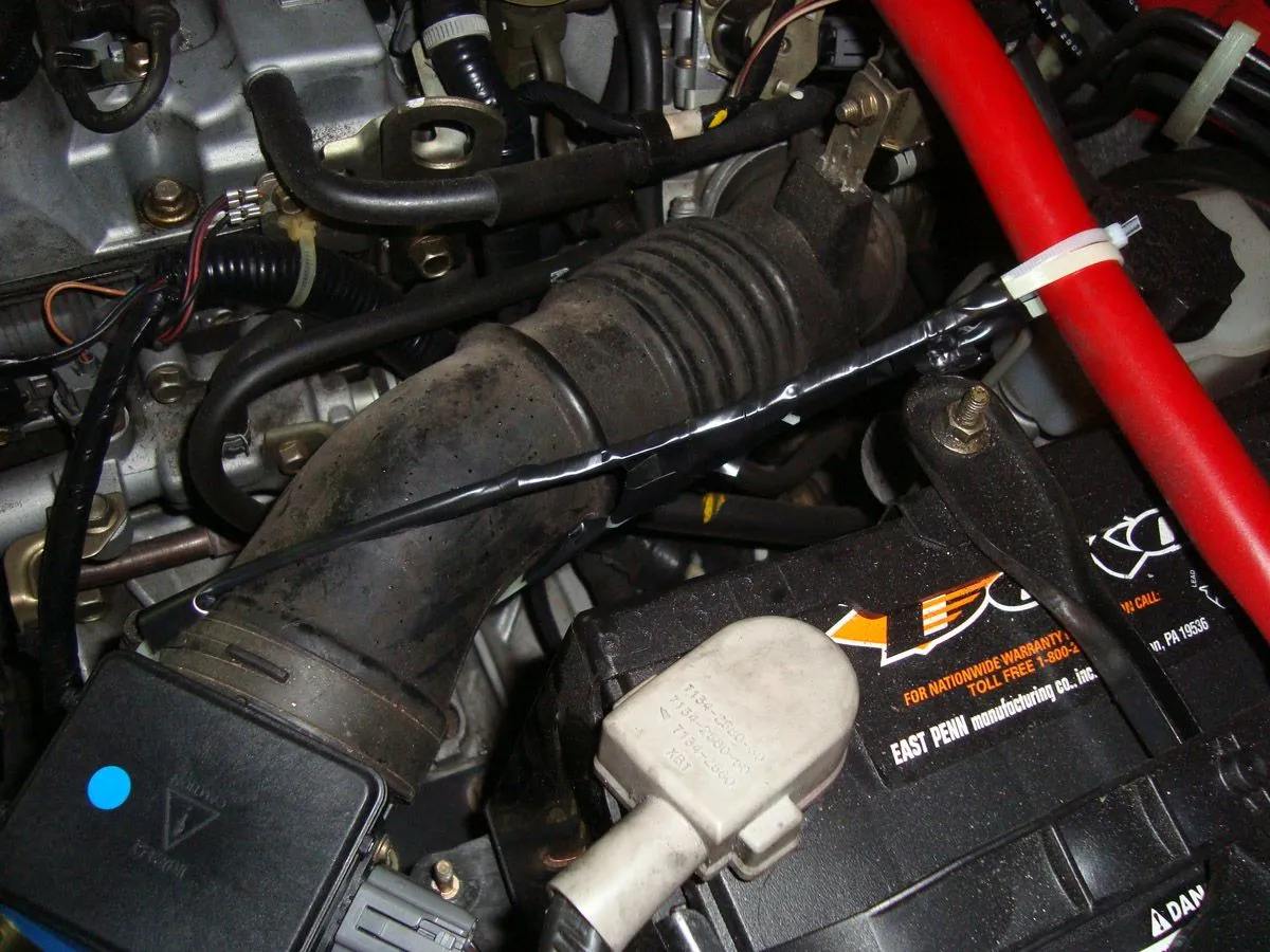

The 4th picture shows the rigged zip-tie hold wrapped in electrical tape for heat resistance. lol(yupnope)

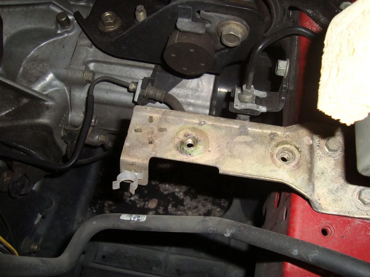

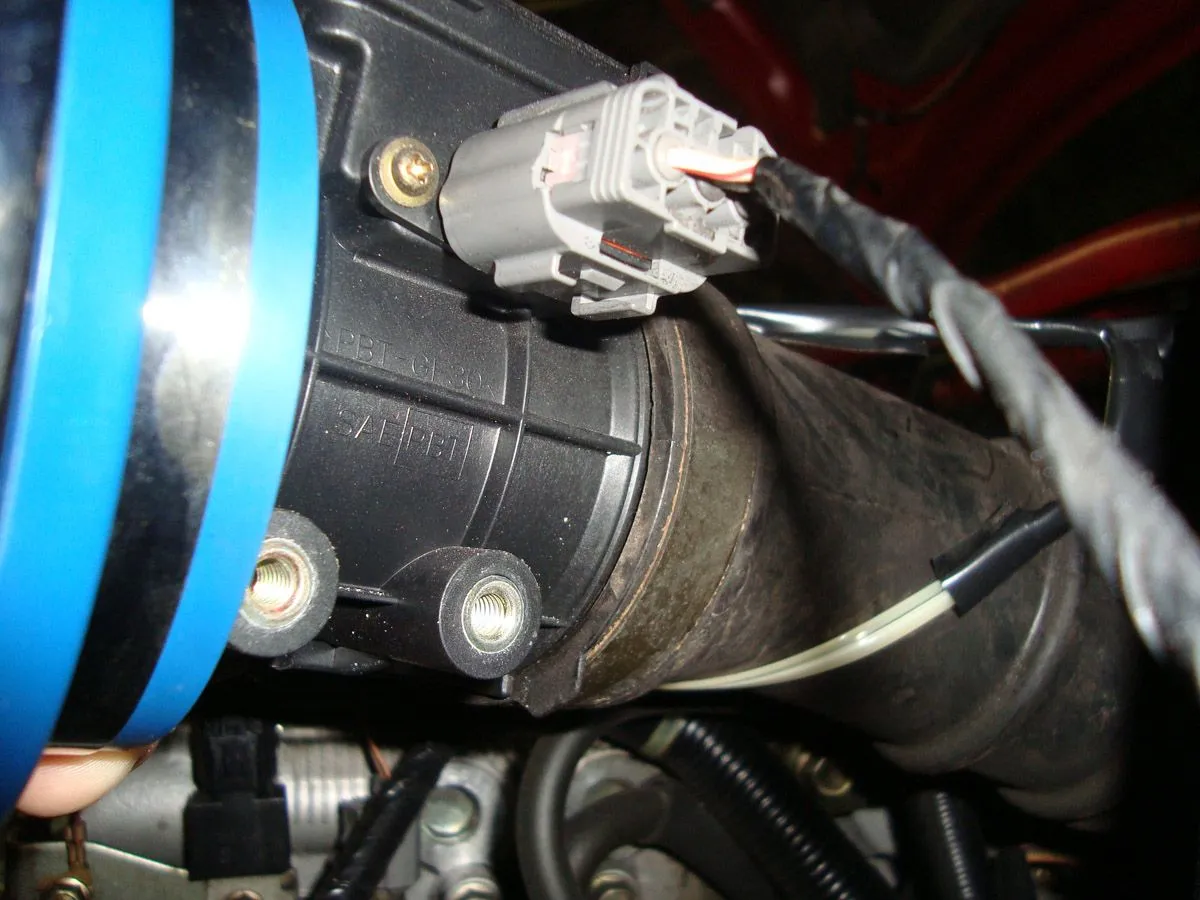

What i was thinking of was to buy a peice of metal thin enough to bend and drill through to connect to the MAF screw inlets in pic 3 to the bottom of the stock air box holder in pic 5.
when I am able to do this, it will also allow me to take off the zip-ties and move the intake a bit closer to the engine. That way it's not hitting the cannister.

I made a bracket out of some steel that bolts to the holes in pic 5. I welded another piece on it to make an L and i put a small flat piece on the top to have the piping on my short ram intake rest on it. I ran a brace from the top of vertical piece down to the base at 45 degrees for extra support and welded all the joints. It works great.
Go to home depot (or any hardware store) and buy "L" mounting brackets. They make them in various sizes, and they aren't expensive. They are just pieces of steel bent at 90 degree angles with 2 bolt holes on each side. Like a glove.
