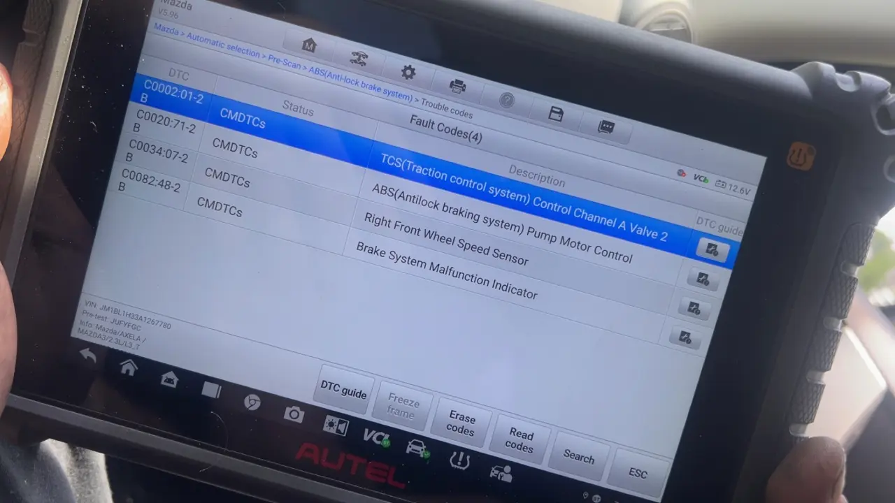

Here are the codes it’s throwing

Looks like one of those speed sensors popped up. I would go back and look at that one. As for the other original lights, did you check the brake fluid level? What if any codes did you get prior to changing sensors?

Brake fluild level is good. I checked the codes at Autozone with the 3 lights on and there were none (or so said the employee). It wasn’t until I called a mobile mechanic today who had a way better diagnostic tool that was able to read everything and tell me. That’s where I got the C codes from. He said he suspects the abs module and pump. Does this sound like he may be right before I go spending money?

I think you should go back and check that wheel speed sensor. One being off can cause all of the symptoms you describe. A real mechanic would be able to properly diagnose, rather than "suspect" and have you throw serious cash away

I bought a new one for the front right (again) so I’m gonna try my luck there again and see if the 4 pack I bought before just had a bad one in there.
But would a faulty wheel speed sensor cause those specific codes?

I replaced the front right wheel speed sensor again, and the symptoms went away. Must have gotten a bad one in the set of 4 I originally got.
Now I’m just curious about the triple dash light situation and if anyone else has any experience replacing their ABS module/pump that could lend me some advice.
