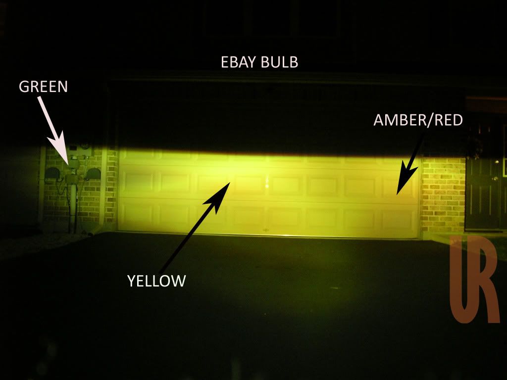

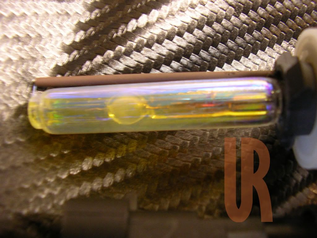

Ebay/ddm tunning 3000k bulb

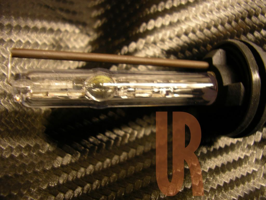

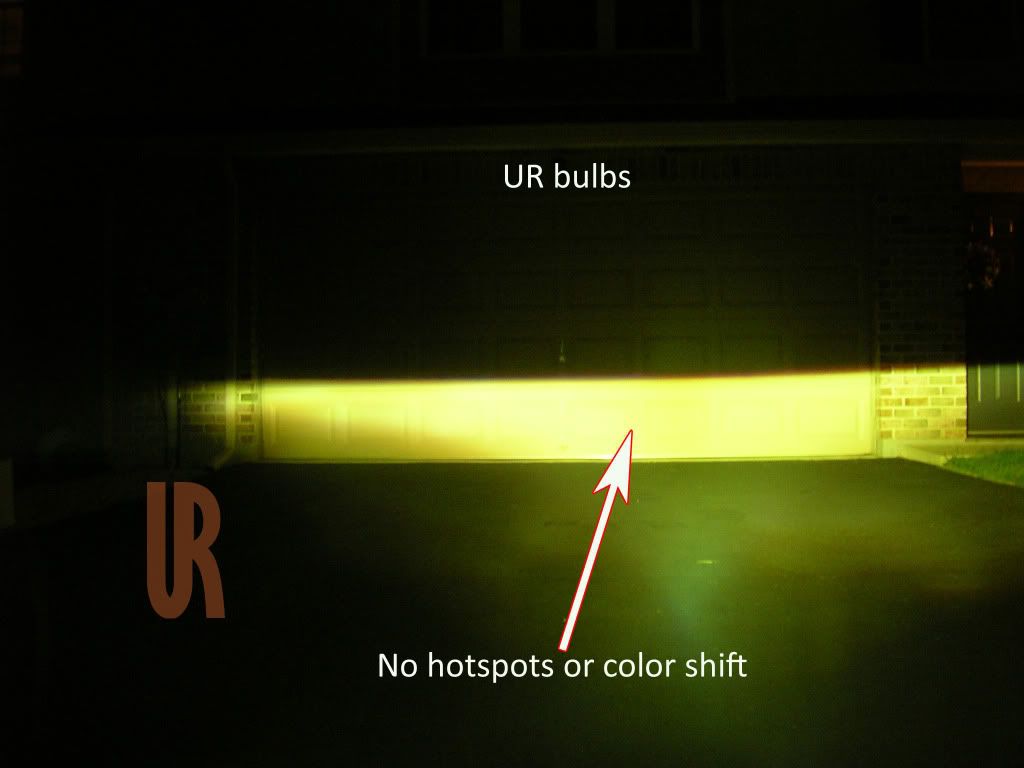

Better bulb, still china made, still a 3000k bulb
Can you see the difference? If you need a bit of help. The ebay bulb is painted yellow. The better bulb is built by using the correct amount of salt to create the reaction to make the yellow color.
Outputs from the bulbs using the same projector.

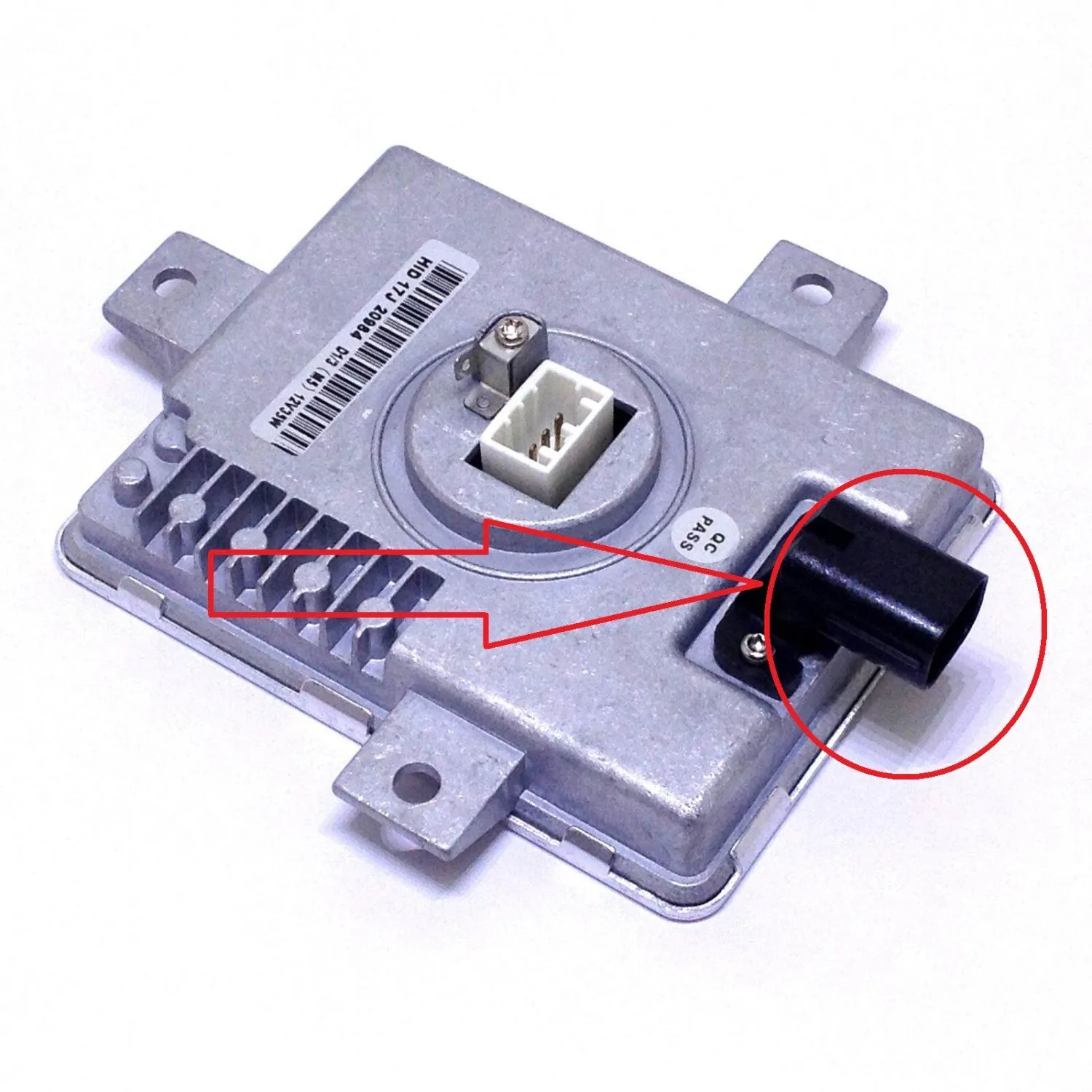

What type of connector is this
H11 or something else?
Thank you very much.
