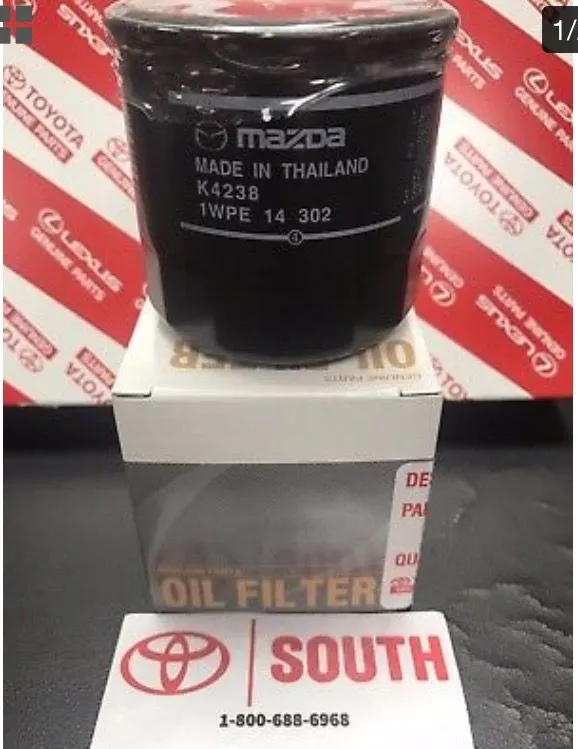

Honestly, if I ran out my Japanese oil filter, I'd definitely get 1WPE-14-302 Thai filter as it's really well made and looks as good as Japanese filter other than manufacture location. It's made by Denso and it carries Japanese and Toyota's quality. We can get those from Toyota's OEM p/n 90118-WBA40 oil filter for Yaris iA (rebadged Mazda2).
The only problem for me is I need to get a different cap oil filter wrench or something else, as the diameter is smaller on Thai filter.
While looking for OEM oil filter for my newly acquired 2018 Toyota Yaris iA (rebadged Mazda2), I found Toyota's OEM p/n 90118-WBA40 oil filter for Yaris iA / Scion iA is rebadged Mazda (Nippon) Denso Thai filter 1WPE-14-302! 25% of Denso now owned by Toyota. So there's an alternative getting better quality Mazda OEM Thai oil filter from different sources may be with lower price.
