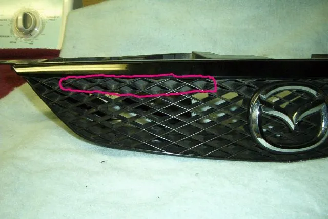

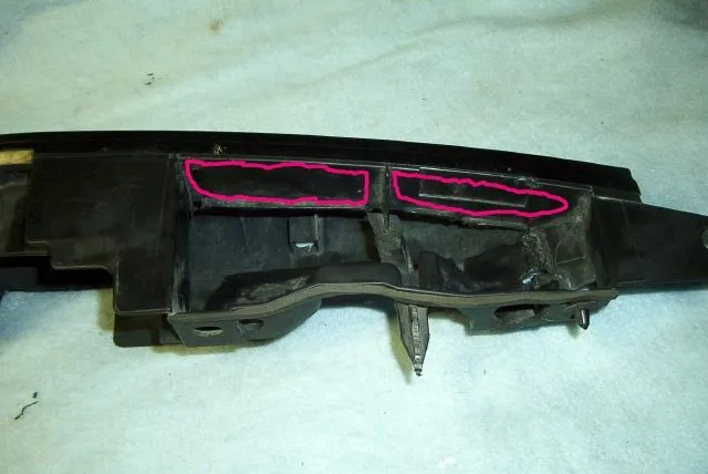

sorry about dragging up an old thread but I just got around to doing this mod.
I cut along the front and sides of the locatiion indicated in the thread http://www.clubprotege.com/forum/sh...77&page=5&pp=15 and using a grill lighter to soften the back edge I bent the plastic down to direct the airflow up toward the intake snorkel. My question is did anyone that did this also drill holes through the front of the grill as well? see attached pictures
