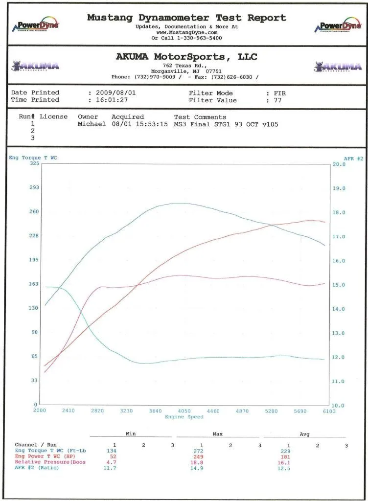

and to show it is in fact still making power above 6k please see attached dyno chart and datalog. power is beginning to drop at 6100rpm, but that is due to flow limitations of the engine itself, the turbo is still pushing 18+psi at 6200 in the attached datalog
  • 4th gear WOT Pull.xls

Perfect example of what I was talking about. Compare where the factory motor torque peak is VS that dyno graph. Move the powerband upward to have more at higher RPM and what do you know, low speed power and response diminishes. Yes there's a lot more power up there with that setup but the character of the motor is completely different. I bet that motor goes from lazy to HOLY s*** in no time. Probably a lot of fun but I wonder how it would be to live with as a DD car.
I be thinking the best answer is to make more area under the curve with this engine. "Powerbands" don't just move laterally. My focus has been to move the curve up and create more area under it. This intensifies the hilarious stock engine characteristics while adding a touch better performance at high rpm, as the falloff is held off slightly longer.
I am making a conscious decision to stay with the stock tune and stock major hard parts but, by opening up the intake and exhaust, I've shifted the curve upward from stock, without changing its basic profile. This is the easy way to at least decent, cheap, reliable DD power in this car.

That post does not mean much. Who's car, what are the mods, what tuning solution did they use etc. etc. etc.
Besides - That Dyno is of LaDouches car which everyone who knows anything about the MS3's (Including LaDouche) knows his car was pure fail and every single dyno he ever did was in question.
I can post up 10 BT dyno's and even a custom turbo setup with different fueling for the MS3 and they all drop between 5500 and 6200 rpms (depending on tuning solution).

Agreed +1+ . Darth and I have very similar mods and approach the power increase with the same goals: raise the power band vertically all across the board by reducing restrictions to air flow at the intake and the exhaust at the points where the most severe bottlenecks are located and sticking with the stock tune. This approach makes sense to me. I realize others differ and respect that.
The stock tune starts closing the throttle body by around 5,800 rpm as a way of protecting the turbo from overheating. I don't know if they did this for the same reasons that caused the aftermarket K04 tuners to revise their ECU maps after the Audi-VW K04 turbo shaft failures. But it makes sense to me that they may have been concerned with the same issues. Either way, I like that built in safety. I' m content to operate the turbo within its efficiency limitations and conservatively mod for more power under the curve.
