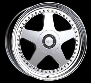

I just got a set of OZ futura IIIs on the way and I am hoping I can ride on them without rolling the fenders on stock suspension. They are 17x7.5 at 38 offset. Haven't picked a tire for them yet.
It depends on tire size more so than offset. The smaller the tire you run the more aggressive you can get with wheel offset.
