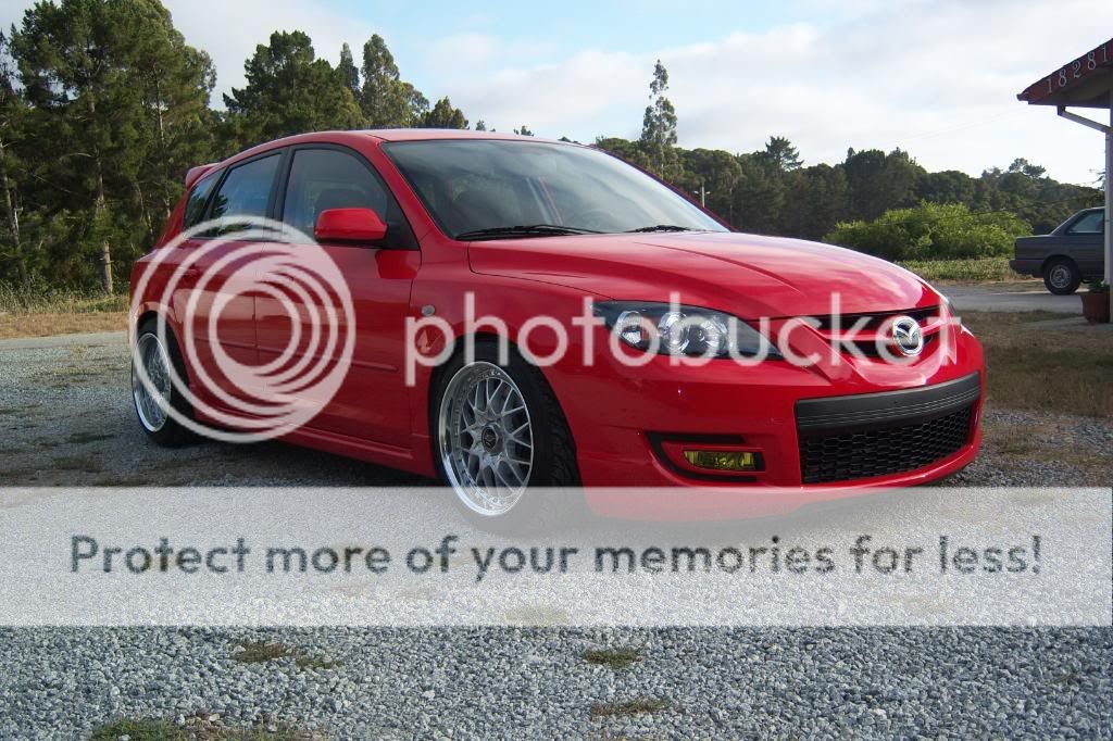

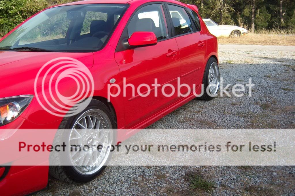

What is the most aggressive I can go WITH rear fenders rolled?
I think 18x9 with 40mm offset will be my next set up I think it is perfection!
Whose car is that anyway?
