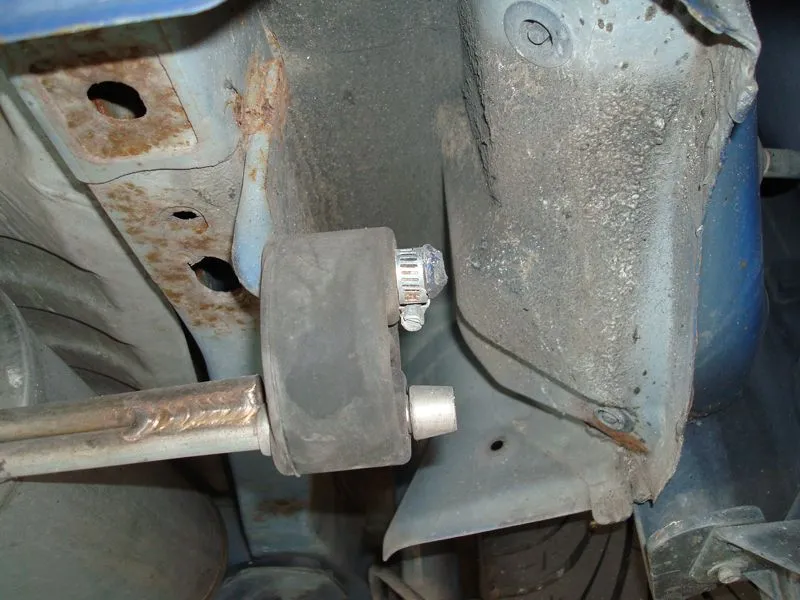

First off, pic request of my hose clamp holding the old exhaust hangers in place

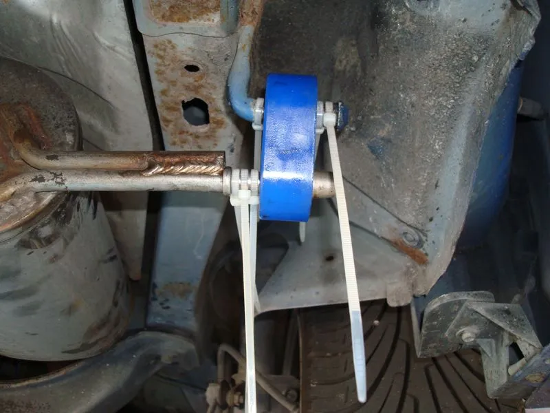

Next up is the new corksport hangers doing their thing

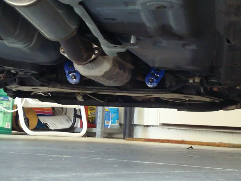

Also, the rattling I was experiencing was due to the drop brackets that came with the TWM. The cat visible in the third pic was vibrating against the heatshield. Took a hammer to it to bend it up just enough to be out of the way. No more vibes

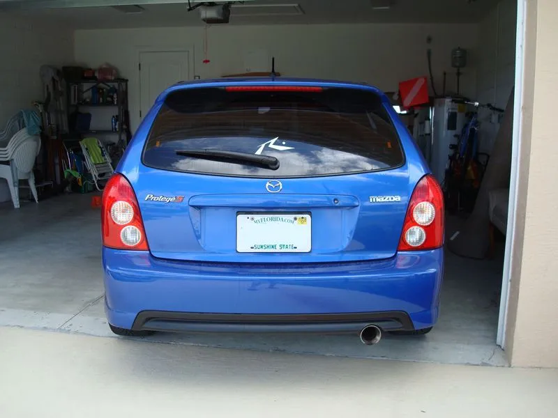

Then we have a tailend shot of the new mazda6 wiper, which made its way over to my wife's car right after this pic was taken. Also, the exhaust sits tighter up under the bumper now

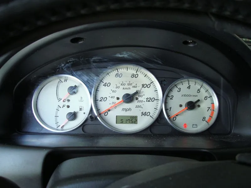

Here we have my new previously polished, now brushed daveb rings! If anyone can tell me how to get rid of the streaks in the plastic on the gauge face, I'd appreciate it!! windex, simple green, nothing I've used that isn't too abrassive will get it off.

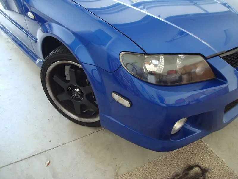

Also, last pic is of the Celica Markers now installed

Tylor, gauges looks great, but i must ask how did the streaks happen? Are they like scrapes? You can try PlastX from Meguiar's. Royal Satin has a abrassive effect. I would try that too, but first try the PlastX.
If you had Royal Satin, i would try it first then the PlastX for the finish.
the streaks were there when I bought the car. They REALLY REALLY detract from the gauge rings!! I am almost tempted to just order a new plastic cover
It's on the outisde. It almost looks like they tried to wipe it off with acetone or something ridiculous
I'll try the plastix though first
