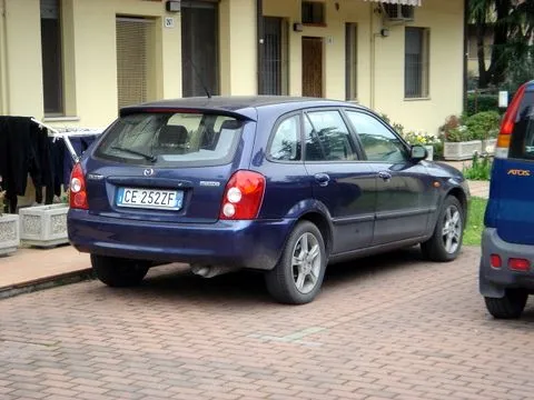

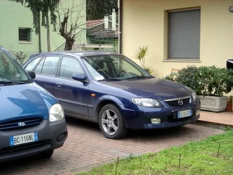

saw this a few days ago in Cesena...I miss my p5...EDM ftw though
