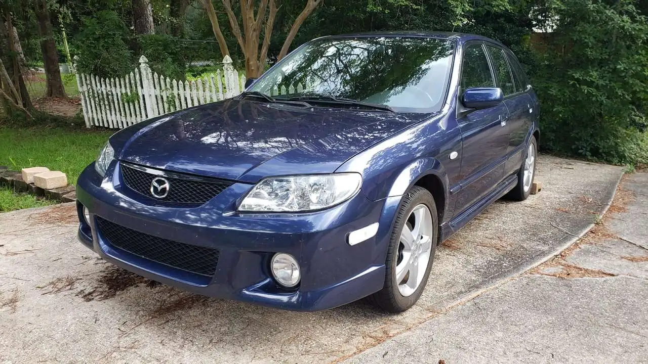

What did I do to it today? I sat in it after driving home from the store, wondering why I am getting a P0421, Low Cat Efficiency code even though the Cat is less than a year old, both O2 sensors are new, new plugs, wires, air cleaner, intake tube, and several other tune up parts, and no other codes at all. Car seems to run just fine and gets very good MPG. 03 with barely over 150k miles. I clear it and go several weeks, checking constantly with my Bluedriver OBD connection and a lot of times have the code pending, but other times not. It will actually set every several weeks or so and I clear it. Started about 6 months after Cat install. Any suggestions?

Which brand O2 sensors? I've read some folks have bad luck with cheaper or off brand ones.

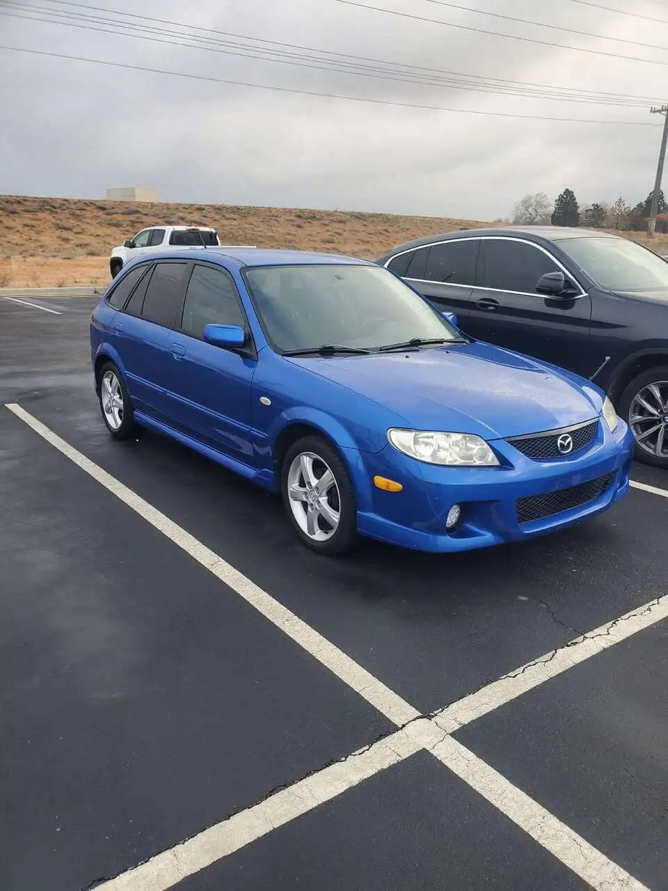

Found a really nice clean Yellow MSP at my local yard.

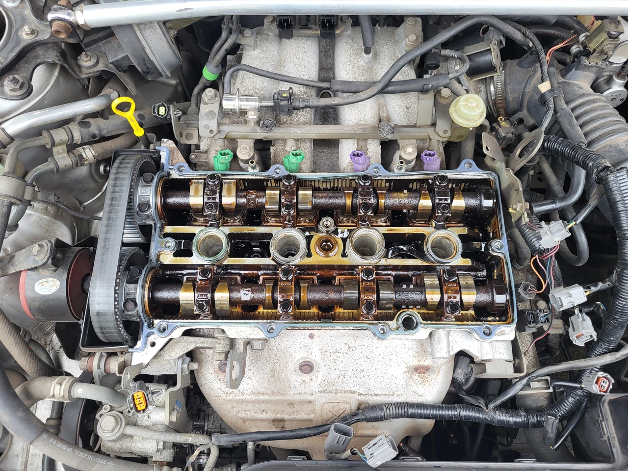

I grabbed the rear calipers, MSP floor mats and door sills, and an MSP engine cover which doesn't appear to fit even remotely onto my FS-DE, so going to have to figure that out.
The cover requires a valve cover from the MSP as its valve cover has areas for 4 studs to mount the cover on. You'll also notice the MSP's valve cover doesn't say mazda on it.

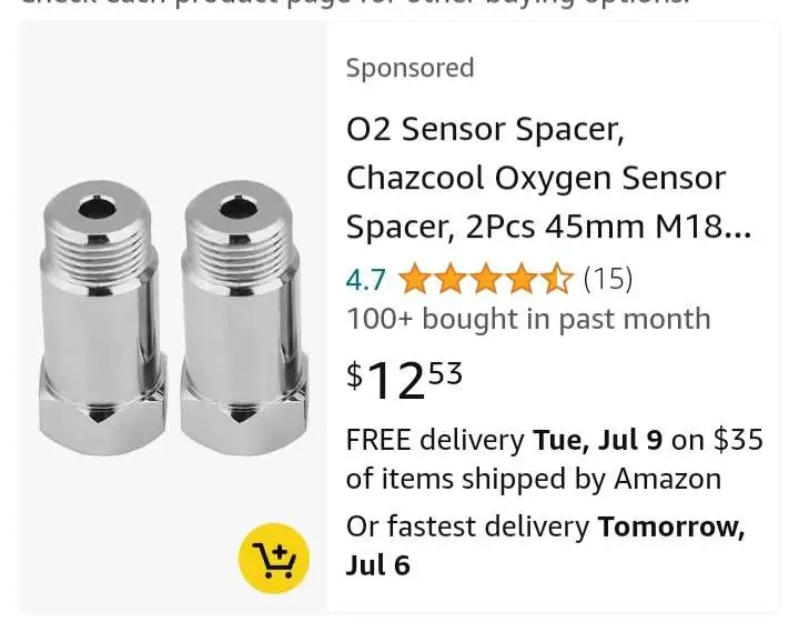

This will get rid of your code,..
(You should only need to use one.)
The only problem with it, is that one particular brand of O2 sensor doesn't fit inside the spacer.
And I think that it's Denso that's too big?
We used to have to drill out a spark arrester and stack it on another one, but they are available in the longer length now as an O2 spacer.
I just found this,..
It's the Bosch that's too big.

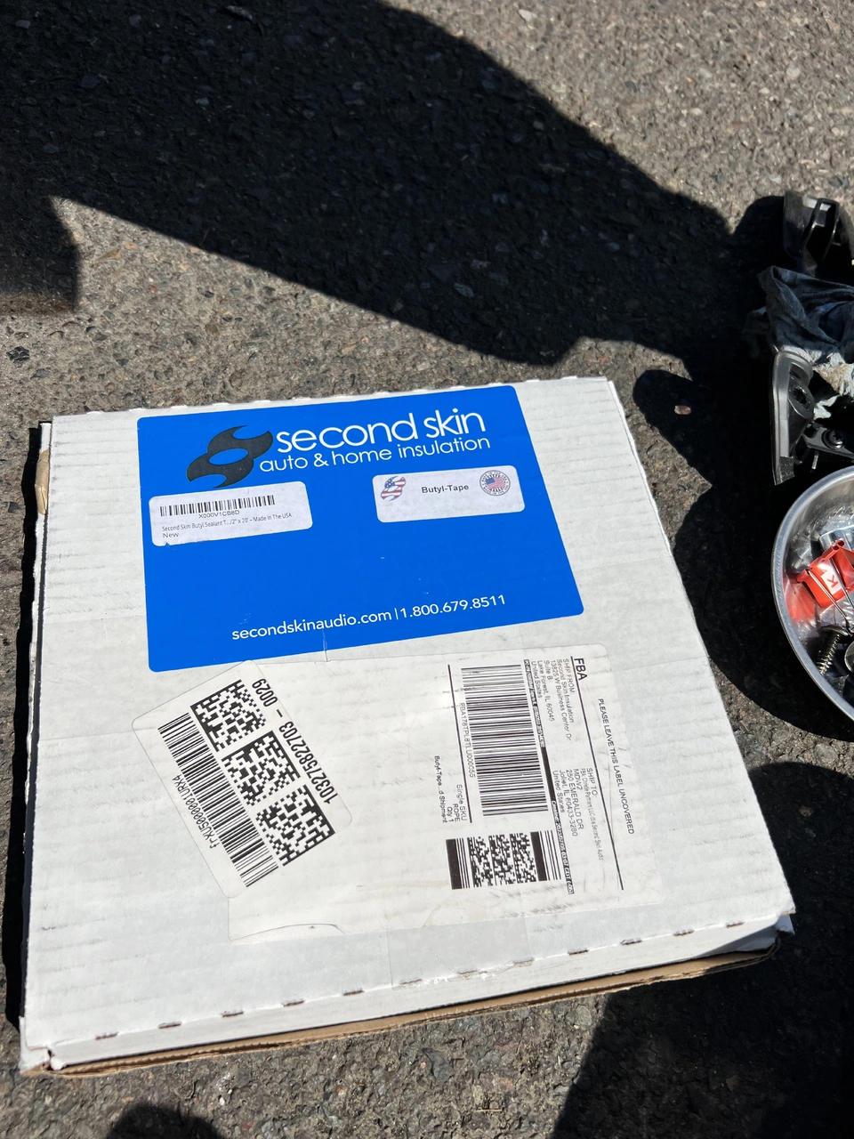

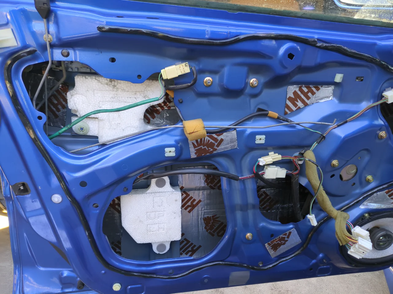

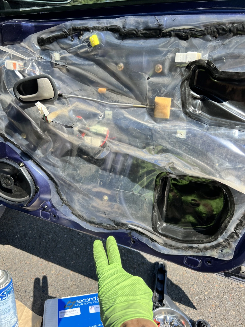

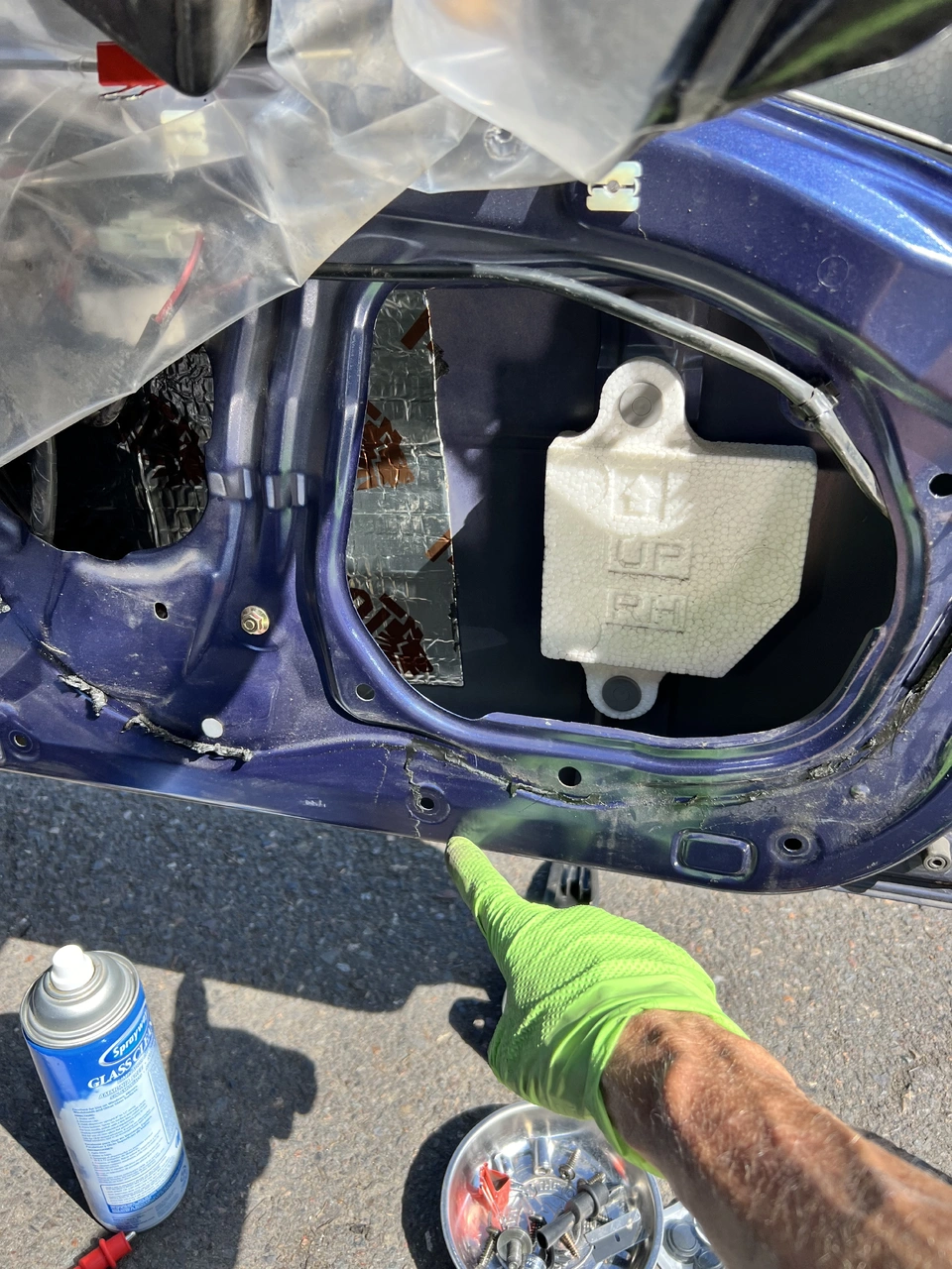

For anyone in rainy areas, this job is a MUST. Making sure your vapor barriers are intact so they keep moisture out. What happens is the black sticky goo that holds the plastic onto the door will eventually stop being sticky and the plastic doesn't stick to it or it sticks to the plastic, but not the door. This is how your carpets get wet and this is why your windows fog up over night after it rains.
Also, as a bonus, I installed several pieces of audio mat to the doors and they shut with such a satisfying European “thunk” now. Should have done this years ago. Now I only have to do it on both of the MazdaSpeed Proteges.

I always hated how flimsy the Protege doors felt when closing, even compared to other crappy cars like 90s Fords and Hondas!
I definitely need to do both of these on my P5.

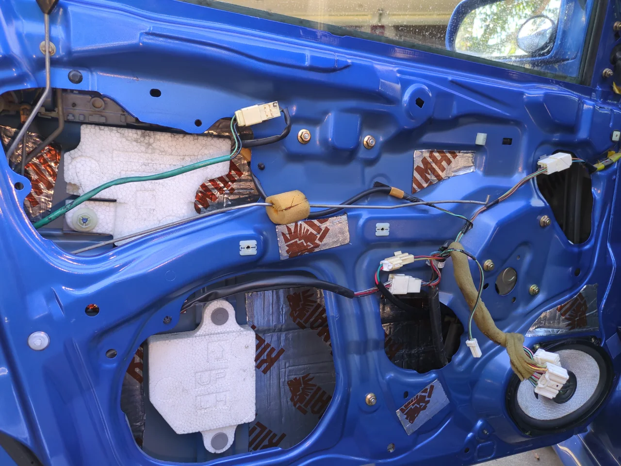

For anyone else who needs to do this, I replaced the vapor barriers in my msp completely, the material that holds on the plastic sheet is butyl, and with enough time and effort you can get it off pretty cleanly with a solution like Mineral Spirit. The plastic was completely shot on my car so I got some of those paining plastic sheets from Home Depot to replace the old. Also definitely put some sound deadening in there, kilmat is a good bang forbuck, I think i went a bit overboard on mine. So, once the butyl is cleaned off, you can place the rope in its place, after that I cut a square of the new sheet out- roughly the size of the door and placed it over. Make sure you push some plastic in where the old black cavities were on the old sheet, I ended up making mine a bit too tight- however it still worked fine. You can cut the sheet along the butyl afterwards with sharp scissors. The only gripe I have about the job I did was that I forgot to take a pic of where the door handle hole was in the plastic and ended up needing to cut all along the wire to get it to work- as i made a hole way too close to the end. And I would also try to make the plastic sheet a bit looser if I could do it again as you can hear the plastic rubbing when opening one of the rear doors since I put the plastic in too tight.
