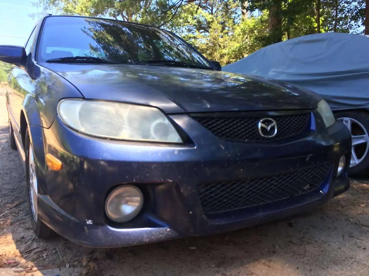

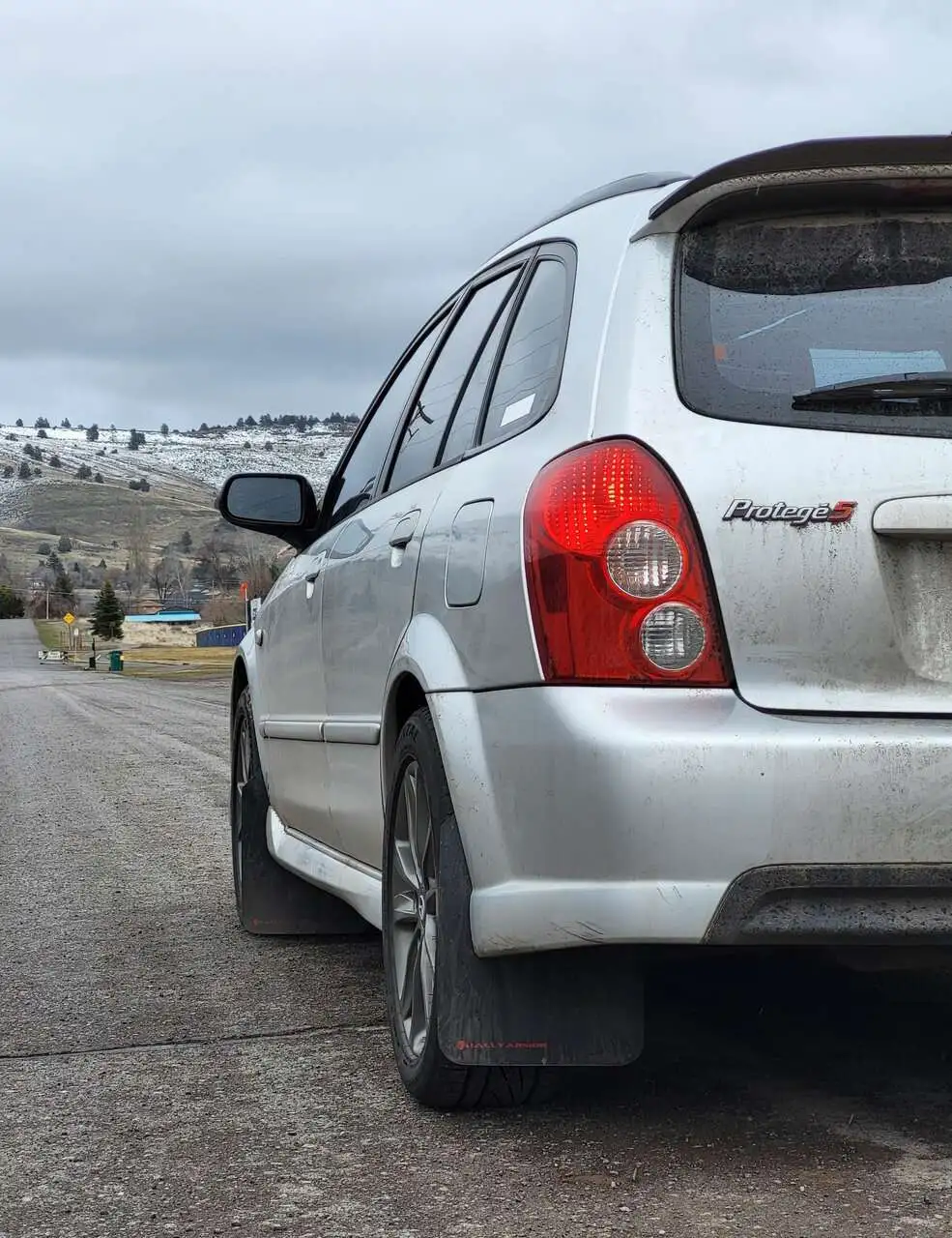

My P5 is still chugging along. Of late, it's just been doing daily driver duty. Haven't done anything interesting to it, but I've definitely got a list. Just passed 199k, on it's way to 200k. I'm going to have to start looking at what it'll take to do a timing belt. Paint has taken a huge beating from the winter and abuse from neighboring cars and people walking past...makes me sad but it's the reality of having an old car. Lots of scrapes and door dings.
Need to do brakes...again. I've got a rear caliper that likes to seize when the parking brake is used, so I can't use that until it's fixed. Also need to do rear pads. Front rotors are warped...I replaced them only a few years back but I drive the car hard so not surprising. Front Hawk HPS pads still have plenty of life left. I'll probably just do rear brakes and leave the fronts until It makes sense to do a Mazda6 swap properly.

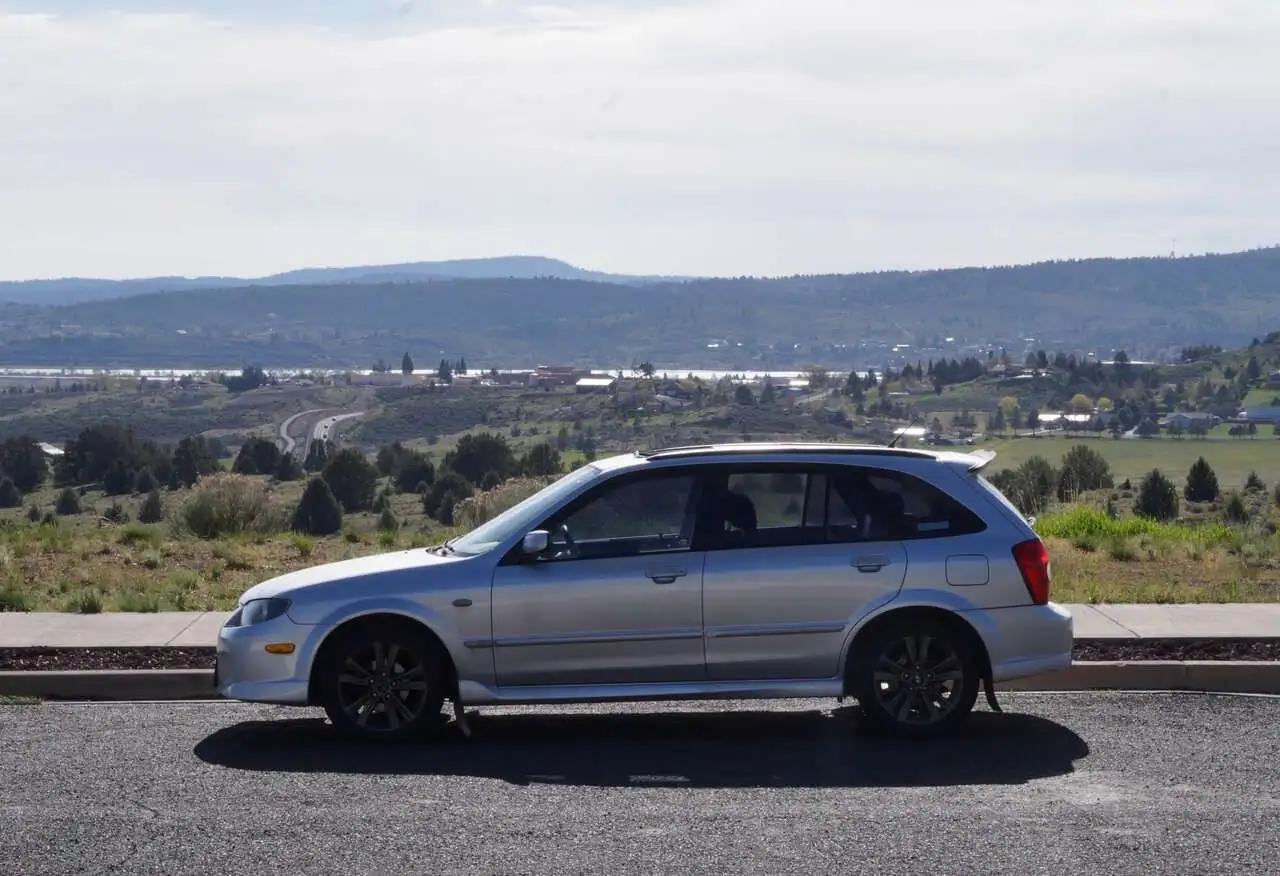

Couple of recent photos...cause why not
View attachment 327833View attachment 327834
This thing is such a hunk of junk but I still love it 😁

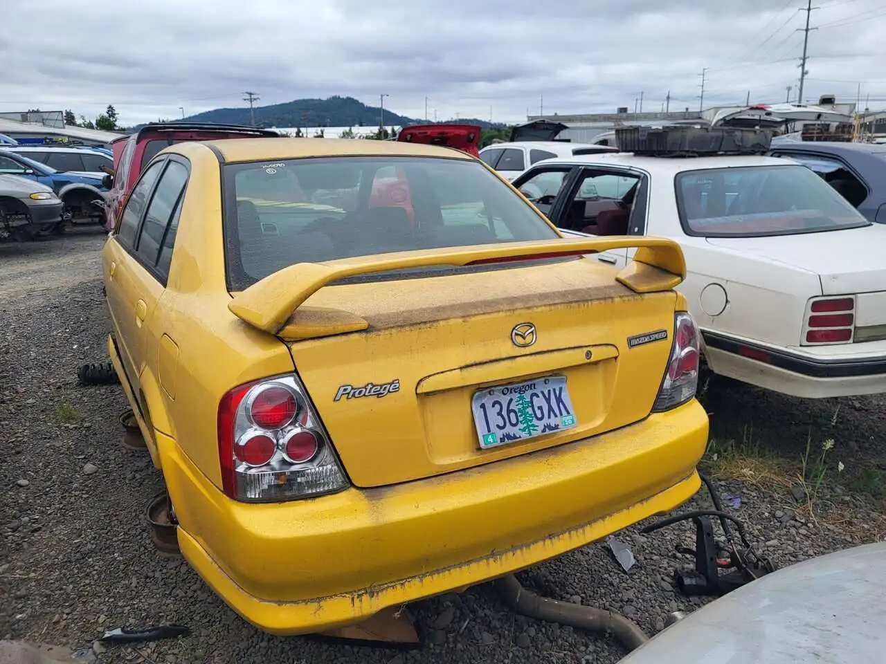

Found a really nice clean Yellow MSP at my local yard. Not wrecked and tags said 2020 so I would guess the engine blew and it sat. The owner definitely took care of it. There was a pile of receipts for Mazda dealership work as well as quite a few modifications.
Few parts I saw that looked good (I have pictures of most of them)
  • Vibrant muffler with what looked like a full exhaust
  • MSP stock short shifter and boot (knob is gone)
  • Front and rear MSP swaybars
  • MSP seats in phenomenal condition
  • Big front mount intercooler
  • Big aluminum radiator
  • Stock (blue struts, red springs) MSP strut assemblies all around, didn't look too closely but they look good
  • I believe the yard still has a full set of MSP racingharts, but they weren't on the car.
  • Engine was gone, as were the turbo bits. These yards usually pull engines immediately so I bet they have them in the shop. ECU and cluster were also gone, don't know they have those but they will be inventoried online.
I grabbed the rear calipers, MSP floor mats and door sills, and an MSP engine cover which doesn't appear to fit even remotely onto my FS-DE, so going to have to figure that out.
If you're local and clever with car-part, you shouldn't have a problem finding which lot this thing is in. It's only been there 5ish weeks so it'll probably be a bit until they crush it.
I am probably going to go back to grab some other stuff. I got quotes for a lot of the good stuff and the prices were pretty cheap. Not saying I'll pull things for people, but I could be convinced.
