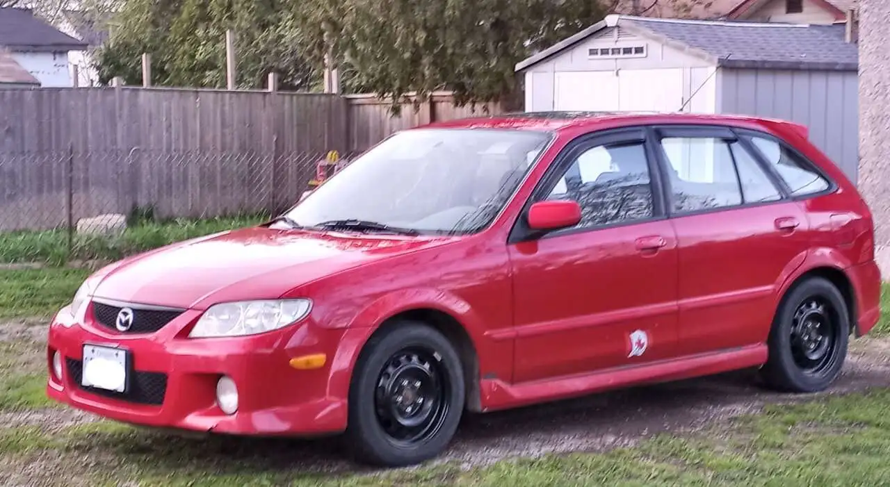

I washed my car today!
It's been over a year, so I figured it was about time. lol
I went to pull the sub from my spare tire to transfer into my miata and found evidence of mice living in the car :(. Granted it has been parked since December and hasn't been driven. Sadly I will be scrapping it this summer after 13 years of ownership and 188k miles put on it by me (its at 262k now).
Very sad. Love the car to pieces, but has rusted away too much to keep putting any money into. I'll have a few pieces to likely sell. Gauge rings, TWM short throw shifter, and anything else that may be of OEM value to anyone.
front lower grille would be of interest to me. and maybe headlights, don't care if they are hazed, my retainer on the left side is missing so it goes cross eyed when the bulb shifts 🤣 and fog lights mine got deleted for some reason.... Money is a little tight for me RN so I will prob miss out on it though. the grille is what I actually need since this replacement one the PO used is a lil restrictive.
I lost the front lower grill years ago doing this. Worth it!
For the headlights, they are a projector retrofit I did in protege headlights.
They looked great years ago, but have now hazed a lot and I cannot get them back to the original luster.
Fog lights are cracked! This car has been used and abused, with much love!

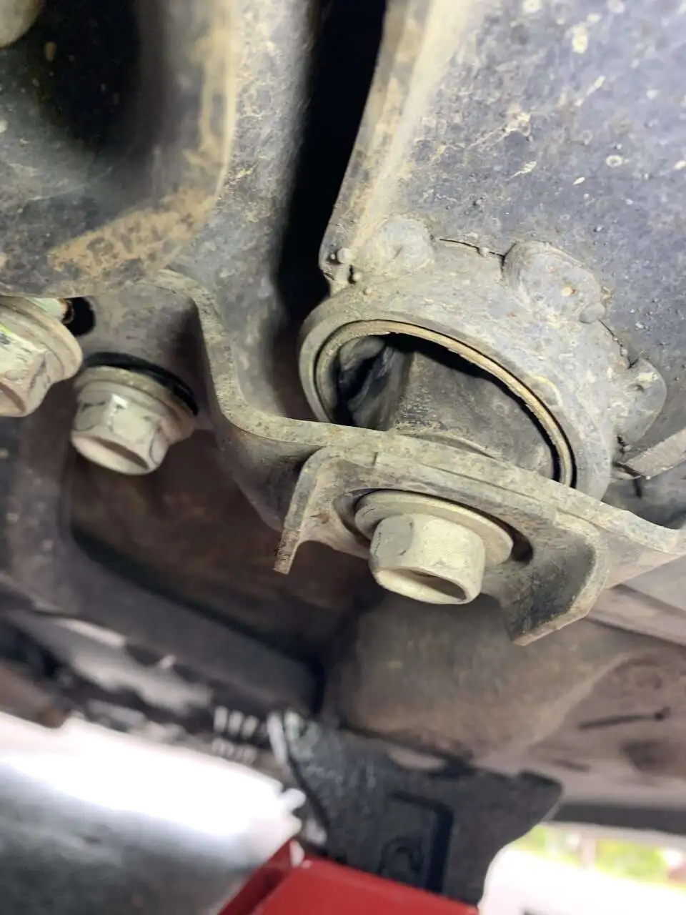

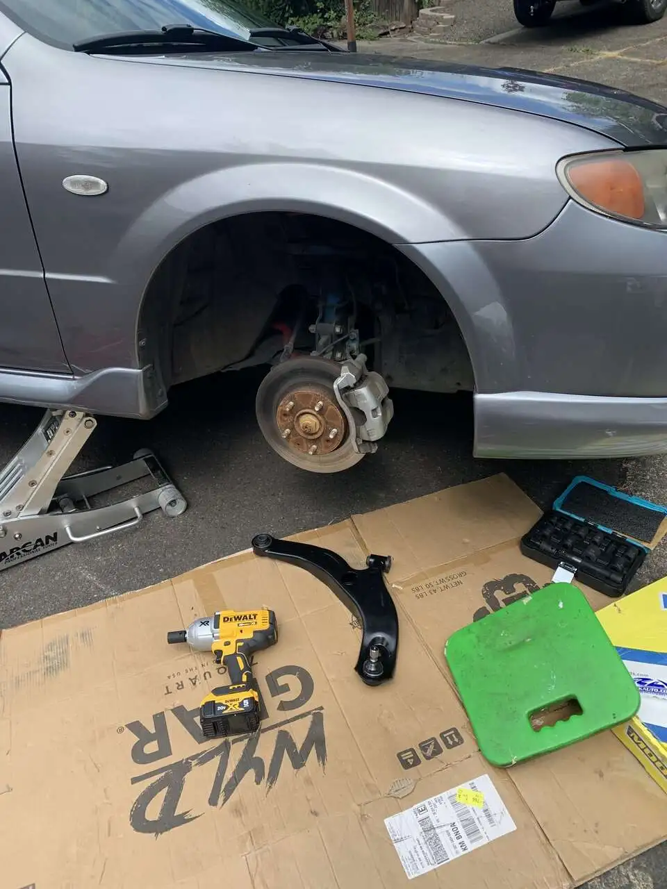

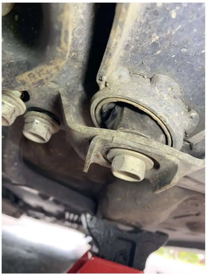

Have you inspected/replaced the Lower Control Arms? I just did this job in my MSP - on which the suspension sounded like a bag of broken crutches rattling and clicking - and the noise is gone and ride much improved.
Check the inner bushing to see if it is torn like this:
I have to say, this job was a long time in the making. I wish I'd done it earlier as the suspension has been rattling like a bag of broken crutches since I bought it 18mos ago. The toughest part is getting the inner bushing lined up properly. Had to use a floor jack to lift up the hub assembly and even then, you can't see the alignment of the bushing and the hole so you can be sure you aren't cross-threading. Otherwise, a very straightforward job (well, only if you have an impact wrench) and it doesn't change the alignment.
Funny you should mention that... I've been sitting on a set of LCAs I got last year. My bushings are cracked, but they don't look nearly as bad as your old ones did. I came across the very good video below that, along with the advice I've received on this forum, will help me get this knocked out soon. I just need a day below 100 degrees here in TX.
Since I've never done this job, I have no clue about how one could cross-thread when installing that vertical bolt, but I've certainly heard a LOT about that one bolt and whatever it screws into and how much trouble it can be. Is there a nut above it that's not welded/captured that can just flop around or something? Is this only an issue with cars with rust problems?
Thank you for the extra motivation to do this. I'd love to get this car back to its original ride. It turns 20 this year, and I've had it since new.

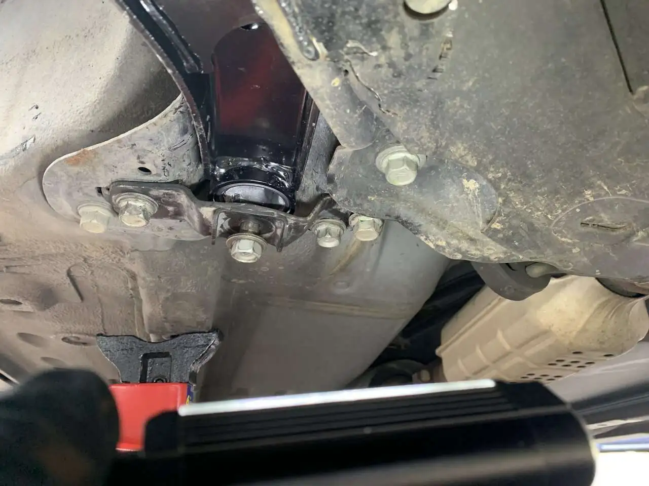

@katapaltes, referencing the photo below, normally you would think the bolt would go straight through the bushing and start catching threads, but the bushing is cocked to one side requiring you to reposition the bolt while attempting screw it in. this is where the cross threading happens so you'll just need to be very careful. of course age and rust could have something to do with it. there is a welded nut for that bolt and i've also read sometimes it becomes unattached
@katapaltes, referencing the photo below, normally you would think the bolt would go straight through the bushing and start catching threads,..
The bolt does line up pretty good with the weight of the car pushing down on the control arm, but it twists out of alignment when it is dangling in the air.
That's why @Diamond_Dave and I had to lift up at the hub assembly with a floor jack.
This is how the alignment looks with the control arm hanging,..
