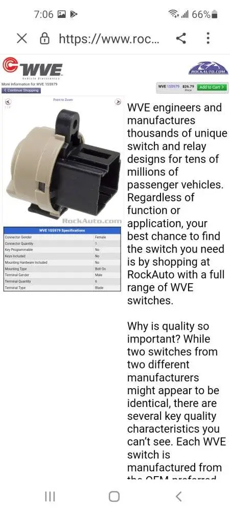

They're not much money and it might be prudent to just replace it regardless.

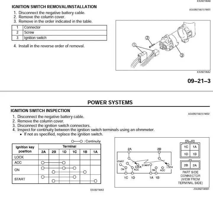

The backside of the ignition key cylinder connects to this point of the switch.
When the ignition key cylinder starts to get sloppy it starts wobbling at the connection point and wears out the plastic making the ignition switch sloppy too.

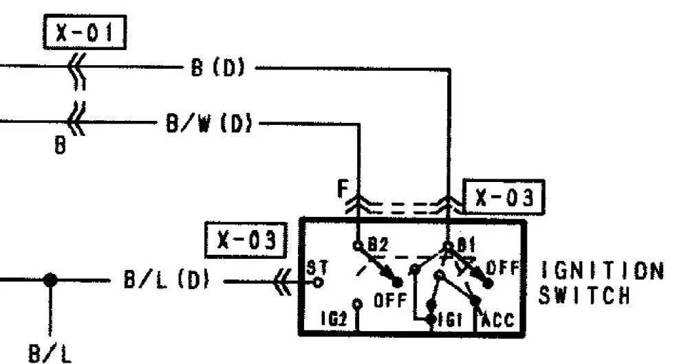

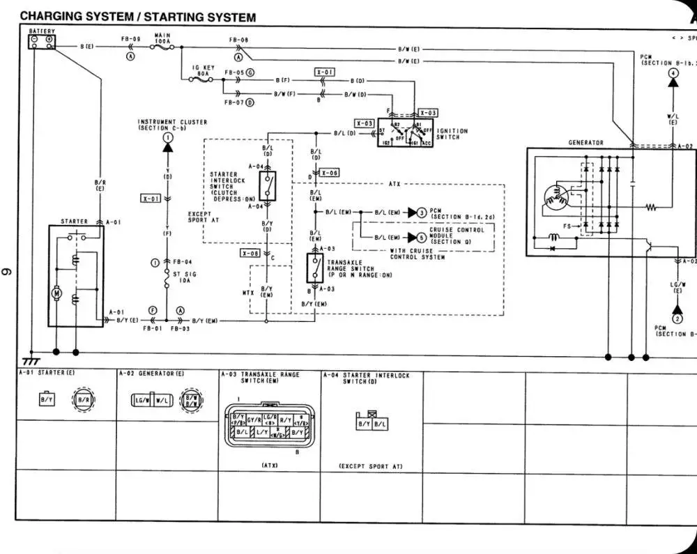

Maybe I'm just not understanding you, or my explanation was poor, but from looking at the diagrams, it seems like the only ignition switch-related thing that would cause my issue would be a short.
The battery was connected but the car acted like it wasn't until I disconnected and reconnected it. Think of tripping the main breaker for your entire house...that kind of thing.
With an ignition switch short, I would expect to hear a spark or see/smell smoke or other signs of electrical damage. I'm assuming the main power to the rest of the car (chassis harness) does not run through the ignition switch? If it did, I could see how a faulty ignition switch would kill power to the car. Then again, that does not seem to be how it works.

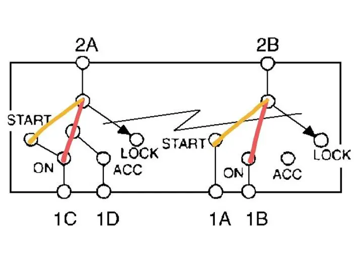

When the car is "on", 2A feeds through to 1D and 1C, and 2B feeds through to 1B.
When you turn it to "start", 2A disconnects from 1D but 1C remains connected, and 2B disconnects from 1B and connects to 1A.
I think that 1B or 1D isn't reconnecting after "start".
