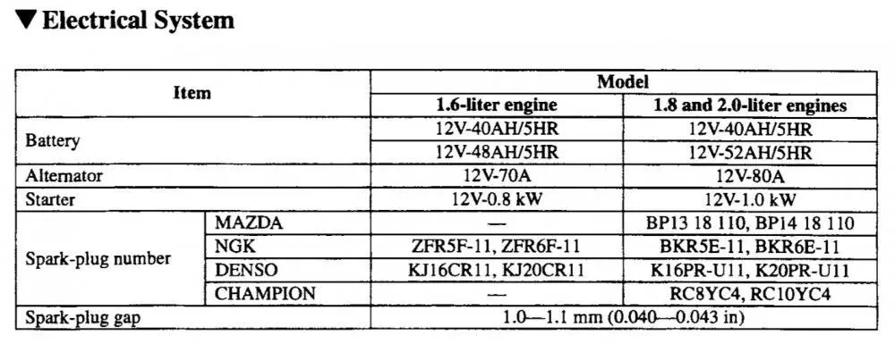

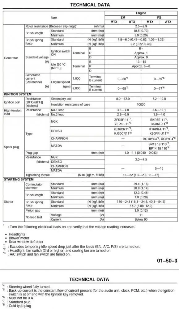

I could prob check my spark plugs out,..
I remember that there is a hot plug and cold plug available, and some guys went with a slightly longer plug.
I forget the part numbers.
I think the long ones might be from the 1.6 liter engine, maybe the ZM ??
I just went with the OEM plugs.

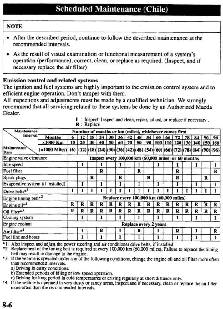

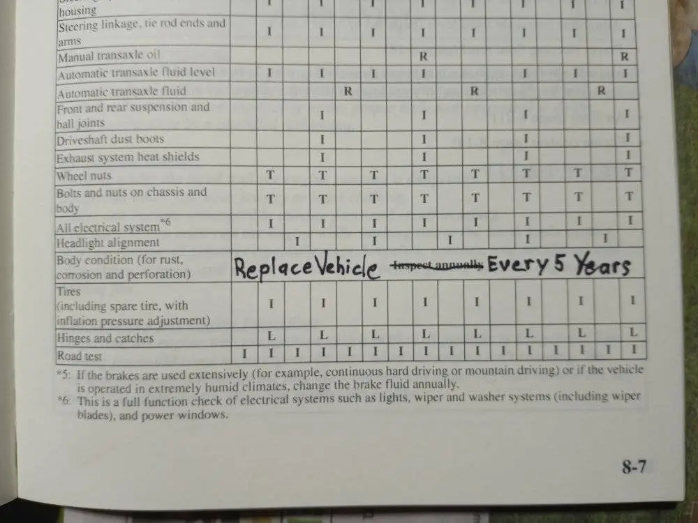

Here's the big list of things to check if you live in Chile.
They drive their cars up and down dirt roads in the mountains, so they have more things listed to look at and inspect.
A lot of the things are almost free to inspect, adjust, lubricate, or clean.

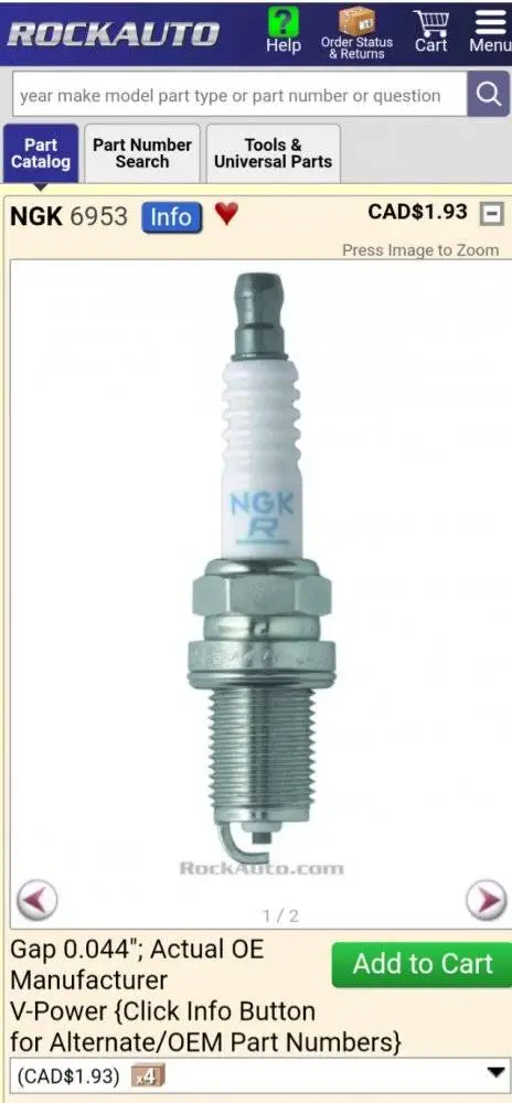

Regular NGK copper sparkplugs are the best for our car.
They give the strongest most reliable spark, and they're dirt cheap.
$1.55 American each.

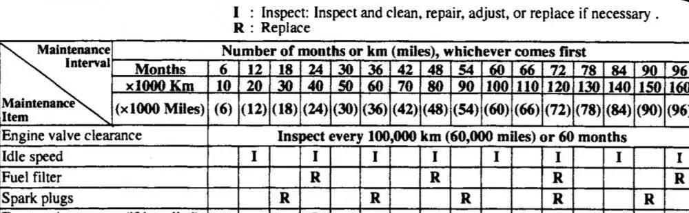

I've never ran the copper ones, up till now mine have usually called for the more pricey 100k mile ones. except for my expedition, I pulled copper ones out of it and replaced them (only saw a misfire caused by that at around 125k, can't remember if it was iridium tipped ones or what, I'd have to check my orders) about how long do the copper ones go between changes?
It was platinum they called for and I upgraded to the platinum on the expedition when the copper ones I went back with only lasted 15k miles. since these are so easy to get at I will go with your recommendation for copper. and make a note of the replacement interval.
also, 60k miles on the timing belt? IIRC these engines are NON interference. I haven't even inspected this one yet. just got done doing two of those on a camry and spectra. not looking forward to a third :ROFLMAO:
I've never ran the copper ones,.. about how long do the copper ones go between changes?
... since these are so easy to get at I will go with your recommendation for copper. and make a note of the replacement interval.

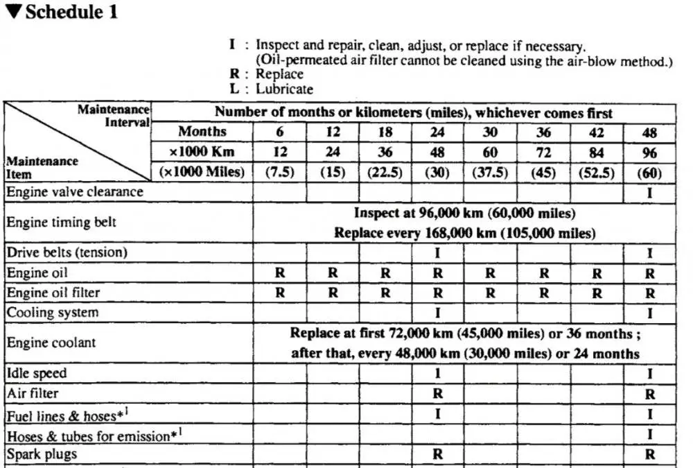

Schedule 1 says every 2 years or every 30,000 miles...
If you drive up and down dirt mountain roads in Chile, then every year and a half or every 18,000 miles...

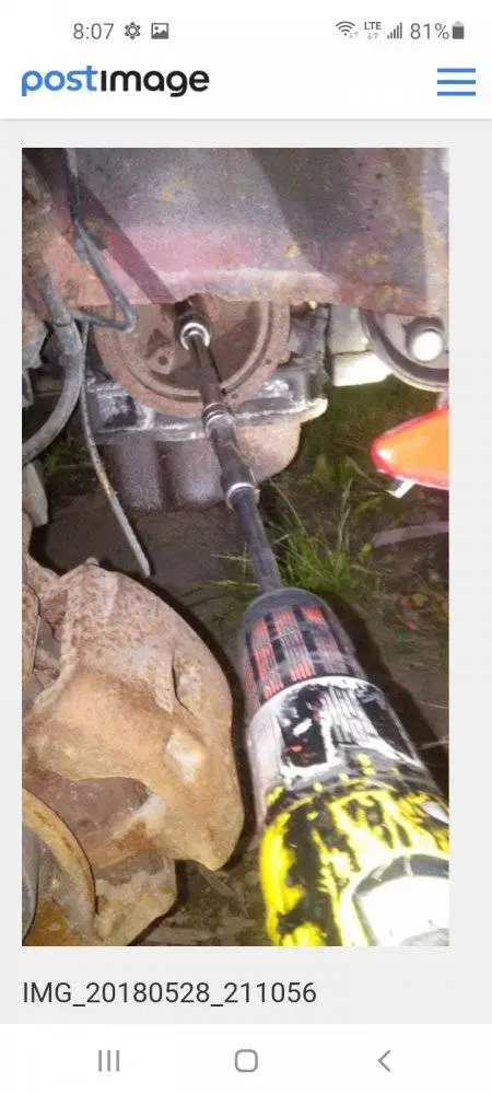

I cut my T-belt on my parts car and put a drill on the Crankshaft...
I locked the throttle on my drill and slowly rotated both camshafts around 360°...
No contact...

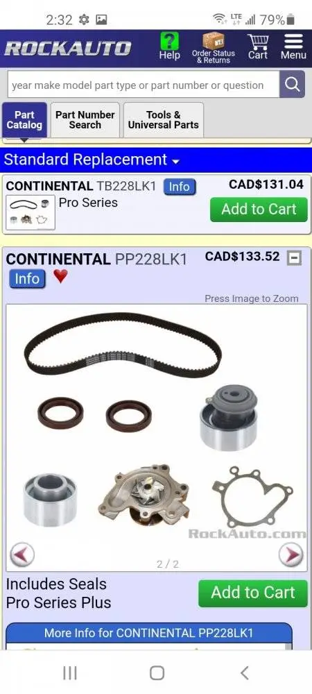

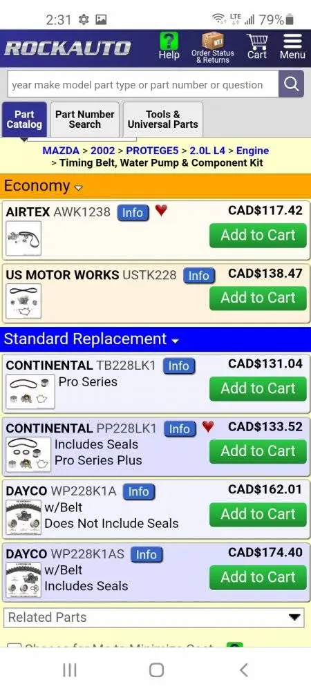

If you do it, or wait for it to snap, get the complete kit and do it right.
T-belt, water pump, idler pulley, tensioner pulley, and the all too important tensioner pulley spring..
Get the complete kit...

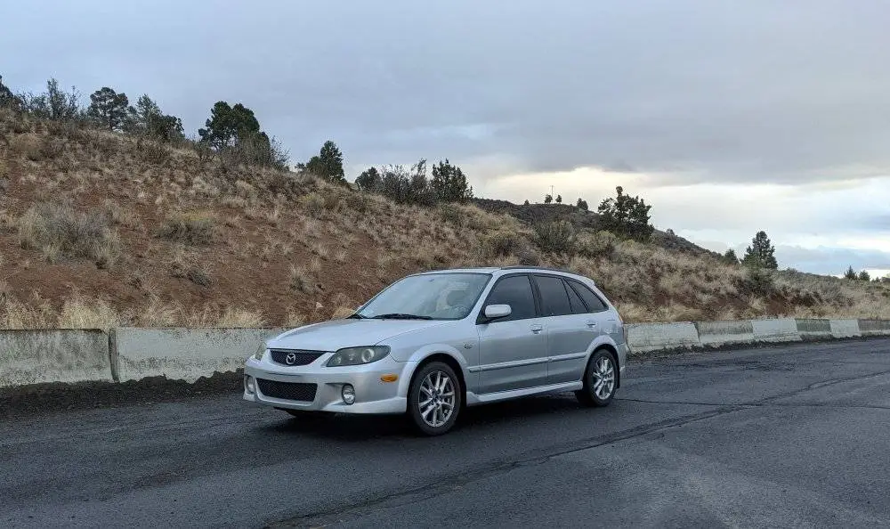

Couple of photos because I was feeling creative. I love this silly thing, quirks and all.
Did order some Redline MT-90 GL-4 transmission fluid to try out. Gearbox is starting to feel a bit clunky and notchy with the colder temps, and it's been 25k on the current oil. We'll see how the new fluid improves things (hopefully).
I thought I recognized that sky color. Where in Oregon?
Definitely try expensive transaxle oil before getting too concerned about the trans. There aren't any specific quirks aside from age and poor 1-2 shifting habits. You should absolutely keep an eye out for an MSP trans with the LSD. I thought my P5 was fun to drive, but the LSD in my MSP is noticeably more awesome (well, the extra 45HP doesn't hurt either).
The first photo is along the drive up to Crater lake and the second two are off highways 97 and 58 respectively.
I bought a gallon of Redline MT-90 GL4 75W-90 and I'm going to try it out at some point soon. The shift into 3rd is a little stiff sometimes (my mechanic noted it during a PPI and said it was not uncommon), and the 1-2 shift can also clunk pretty badly if I try to shift quickly. I'm starting to get into the habit of shifting more slowly and smoothly though, as I want to preserve my gearbox. My only other real concern is an occasional whine in the lower gears (1-3 if I recall).

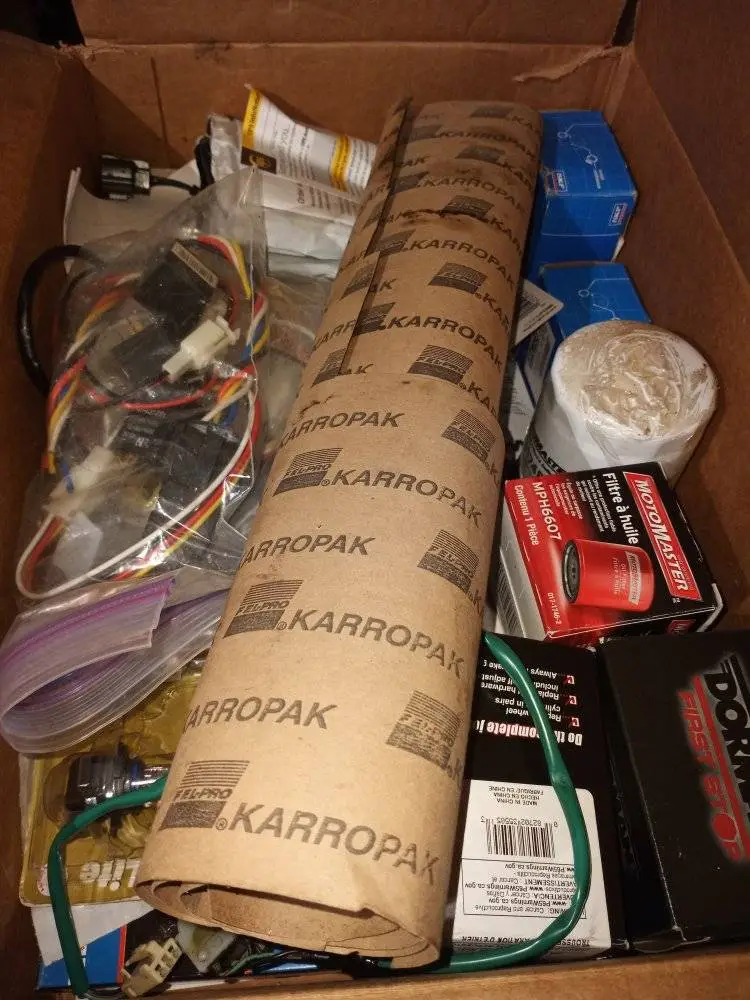

took a crack at fixing the leaking thermostat outlet. The housing and outlet are pitted from a previous leak and the seal doesn't work, dripping coolant from below. I bought a sheet of gasket material and cut it to fit and installed it. there is now a slower leak from the top bolt but it holds pressure now. Likely that I will limp it along and finally order the housing and neck if I can find them both.

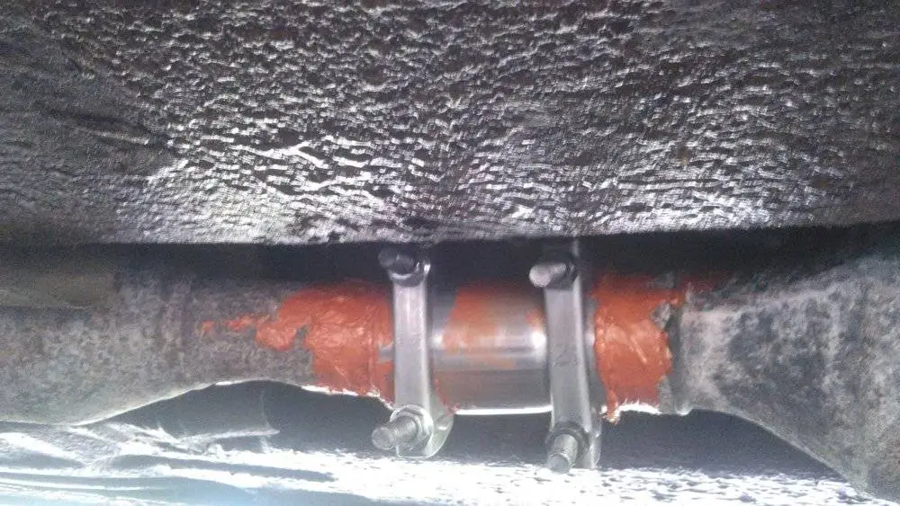

I've got a roll of gasket material too.
I forget what I used it on.
I think it was my exhaust, along with a tube of high heat copper RTV silicone. Lol
I do not envy y'all living in the rust belt. This is the first time I got the material. the last time I had to make a gasket for the same thing, I used cardboard paper and a very light coat of sealant (think it was gray in color from permatex) that one held until I sold the car. this one has the slightest seep from the top bolt now but it is slow enough that there is still full pressure after an hour drive and I don't see a daily coolant loss.
