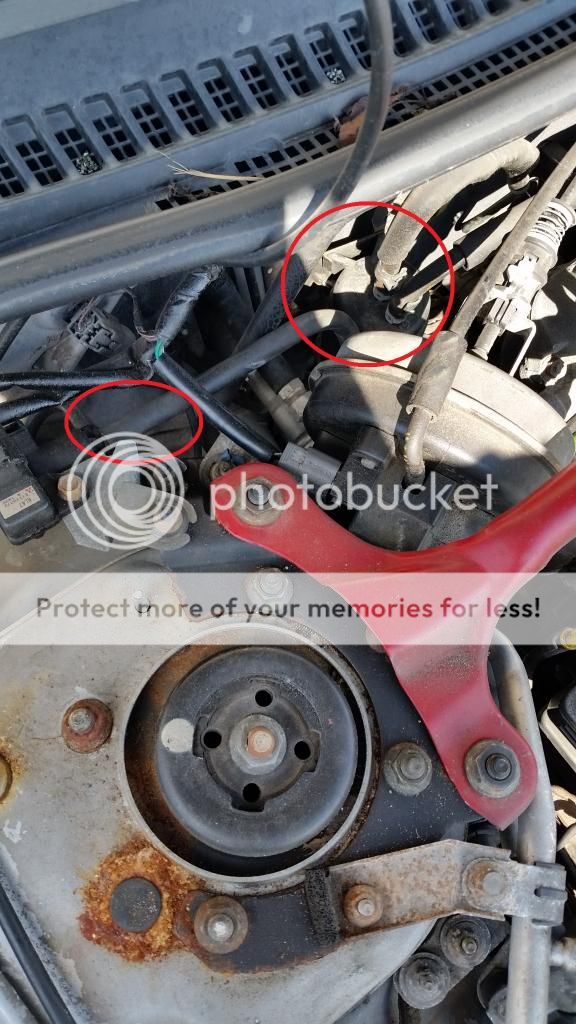

You need to remove the canister on the firewall AND the bracket or you will not get it out without breaking something, nor will you get the new one in.  Also disconnect the vacuum hose on the left and tuck it away.

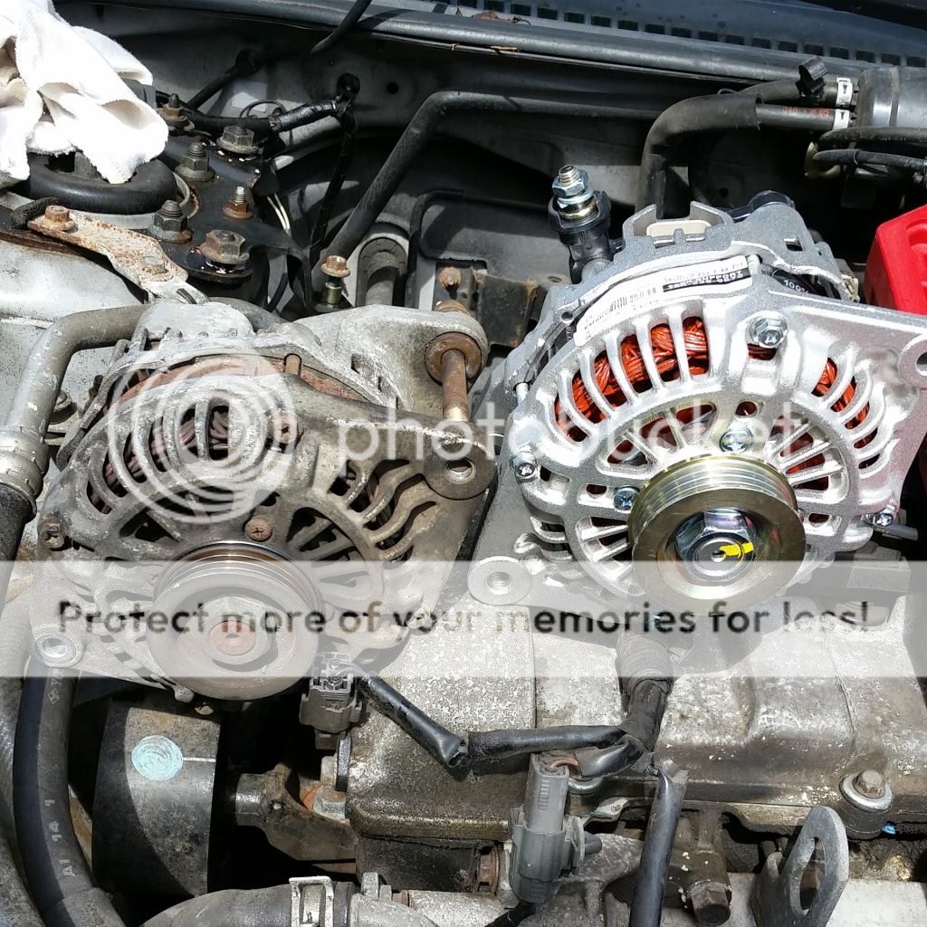

Here is the side by side comparison of new and old:

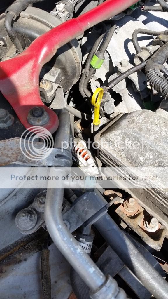

And there it is all nestled in there:
