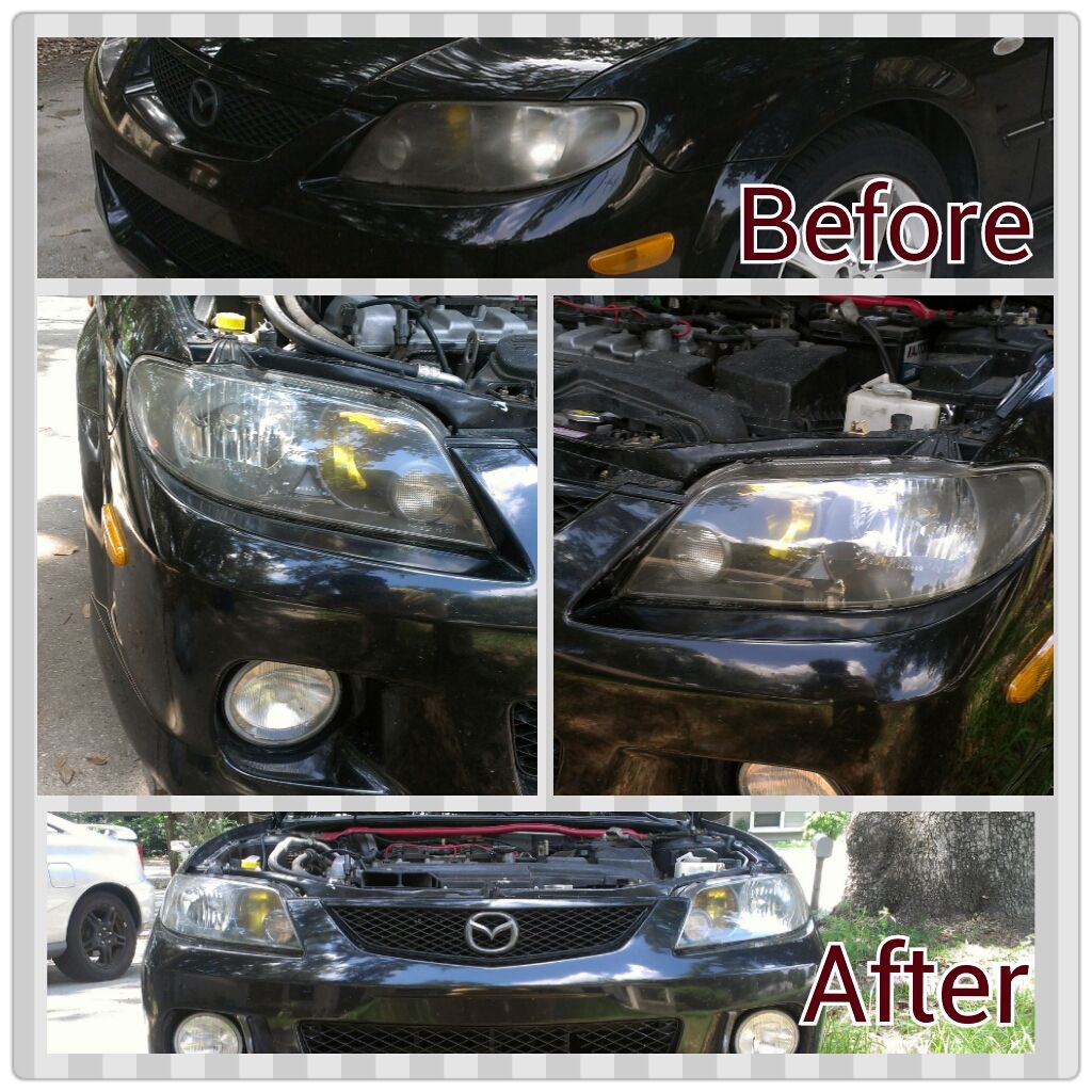

did my headlights couple of days ago!! glad witht the resutls!! after doing in them, i have done couple of more cars...
What product/technique did you use? I have to take care of mine.

Ive had really good luck with the 3M lens cleaner kit. Comes in a small clear box. It usually costs about $20 and comes with all the different grit sand papers, the sanding sponge, and the glass polish and protector.
I've seen those at Canadian Tire, it's good to know they work. I'll pick up a kit next time I'm there. Thanks!
The 3m restoration kit before, and it works very well, but the only bad thing about it, is that every 6 month you almost have to repeat the process...at least wax it or put in robing compound...but what i did was i seal them with a UV sealant..and it doesn't have to be repeated at all...pretty much is the same process as the 3m kit, but with a UV sealant at the end of the whole process...ill post a link later so you can see the process!!
here you can see the other cars I've done..www.facebook.com/wiso.cortes
