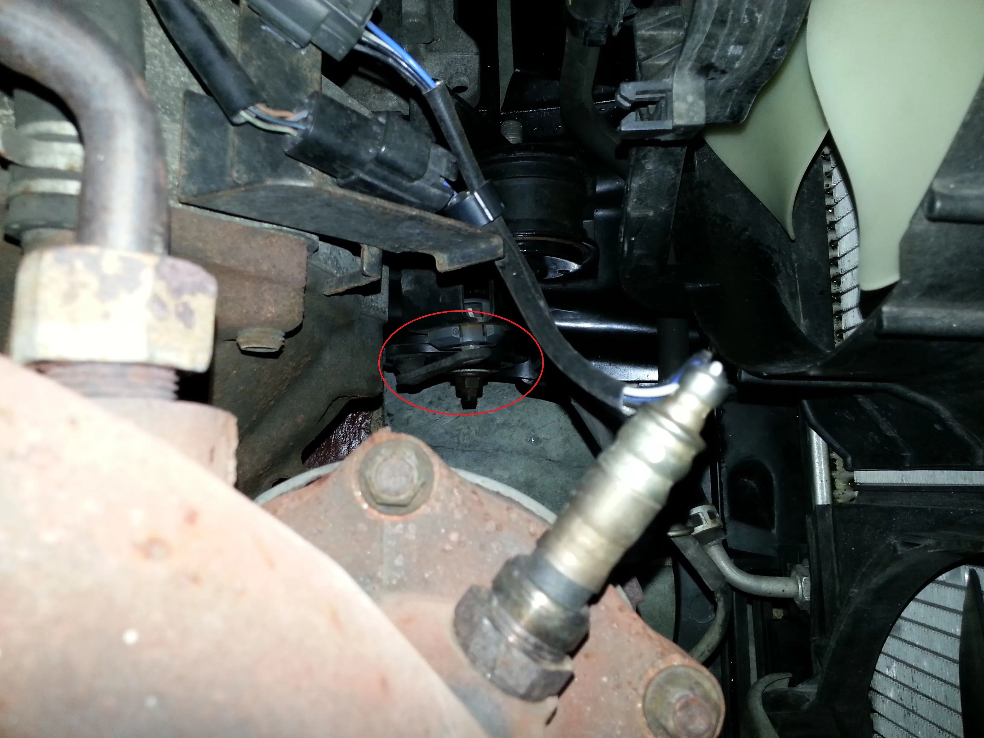

Took a drive to my bro-in-laws this morning to install motor mount inserts....now I'm really jealous of his oversized and heated two car garage. lol Got the CS inserts in the front mount. One question though, what in the hell is the piece circled in the pic? It's not menioned in CS's instructions nor have I ever seen it referenced in any how-to's for the mounts? Had to pop a ball bearing out and remove it to remove the thru bolt of the mount. Is this something specific to automatic's? Gotta love having a drill press and hole saw bits handy as well. Had to drill out what was left of the stock rubber to get the inserts in.
attachment.php

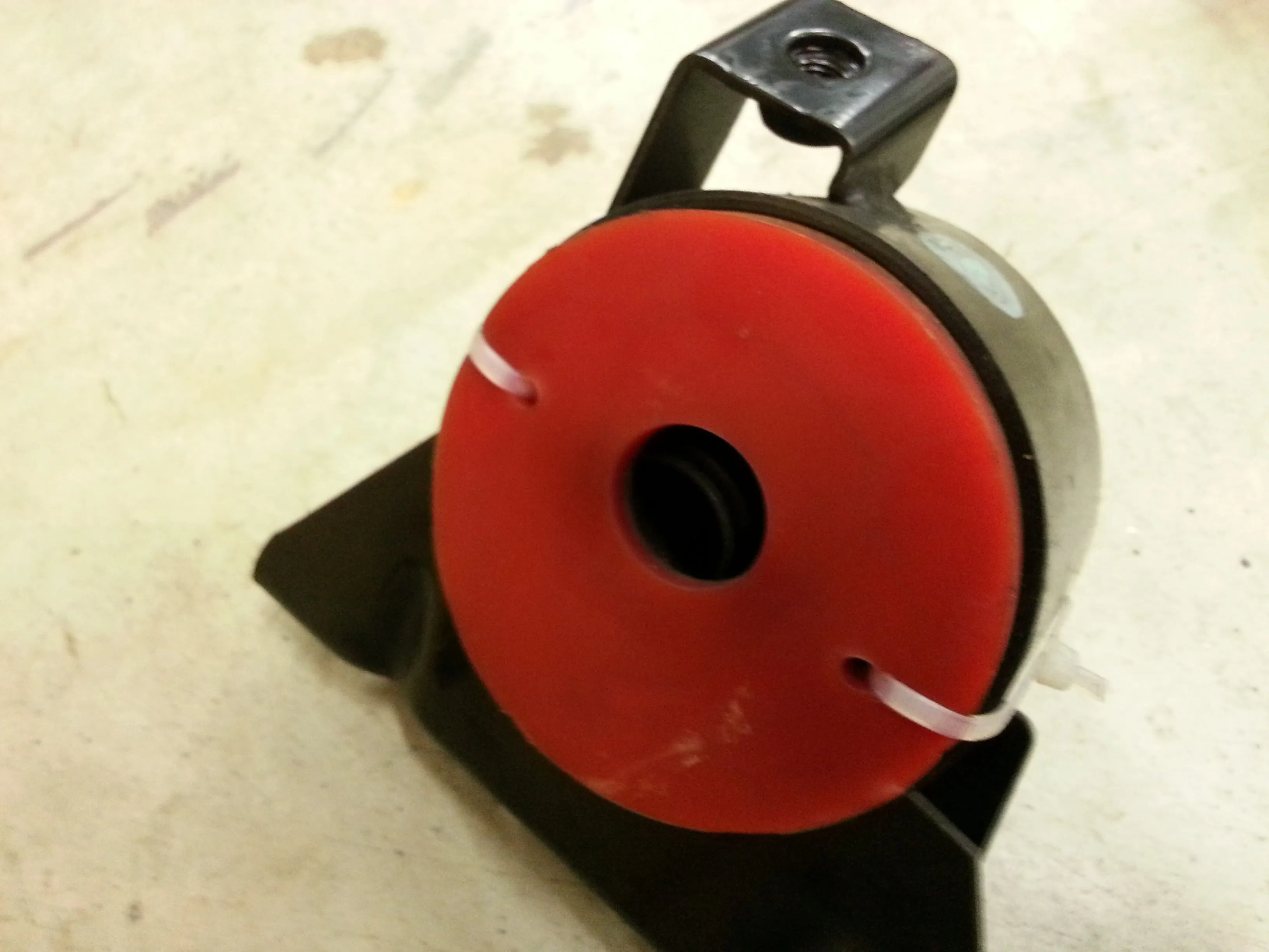

PS was a whole nother story. Got the mount off just fine and found the rubber was torn pretty good on both top and bottom. Used a band saw to trim the rubber off of the sleeve on the bolting flange so it would go through the AWR inserts. Once that was done we found that the sleeve would not go all the way through both inserts and was flopping around in the middle of the mount??? Attached a pic for s**** and giggles. Did a mock up in the car with it and neither of us were happy with it. Did I miss something on the install? Followed the instructions given with the inserts but mabye one of you guys encountered the same and have a tip/trick? Made a quick trip to Autozone and bought a Duralast mount to install so I could get the car back on the road.....$156.87 later.... Since I didn't use the AWR inserts on the PS, I left the DS alone for now.
attachment.php
