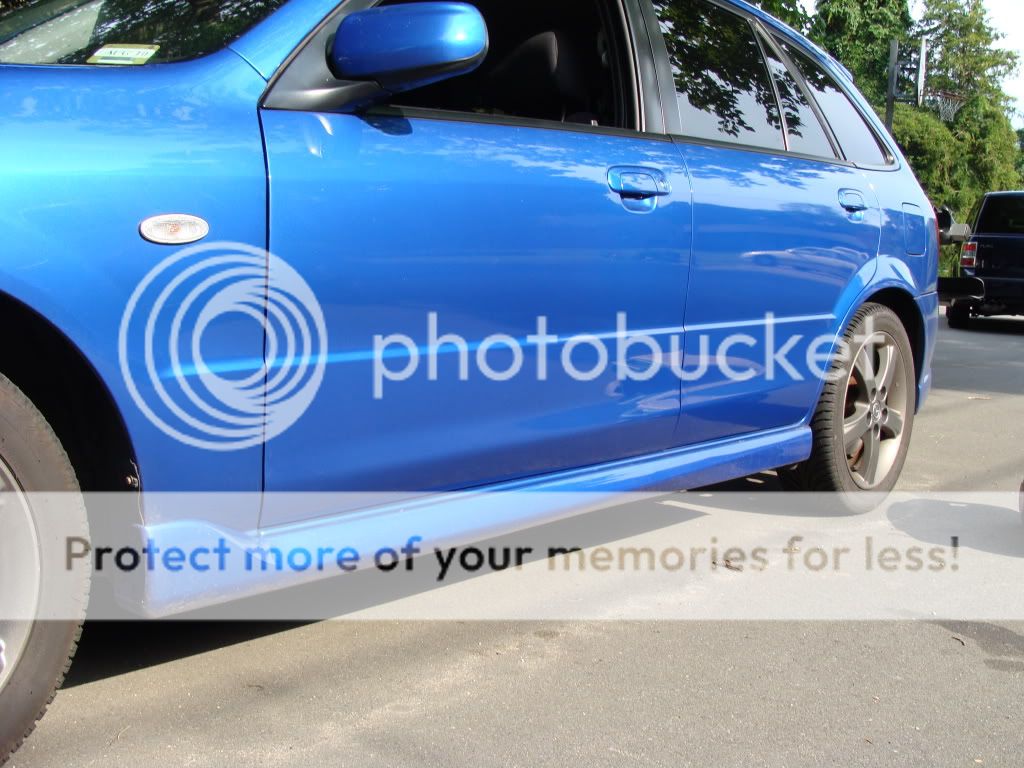

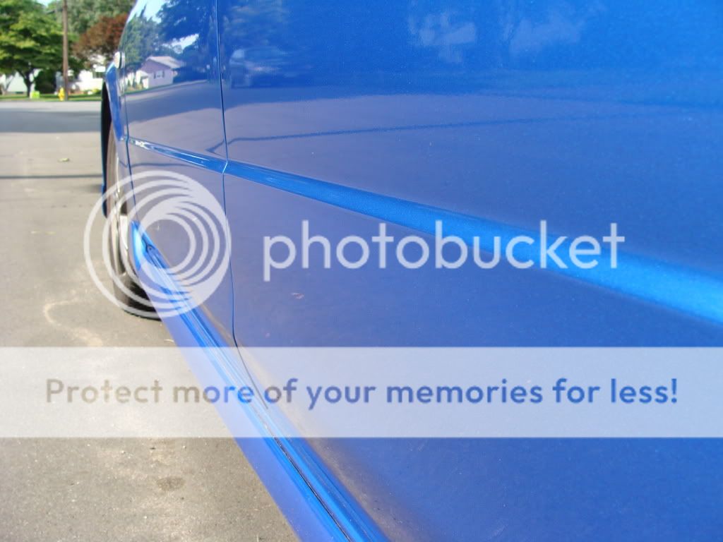

and i used what people said to not use to strip the adhesive, gas. and thats how good it looks once you clean it up and hit it with some wax
and matt your car looks much better than mine overall with all youve done to it. baby steps for me
