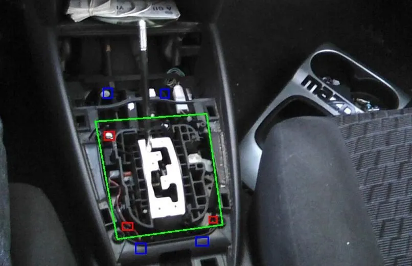

i just had it competely down to just the actual gear selector box ( i dont know the correct name) everything went back together but couldnt figure out how to pull that selector apart.
i saw 3 sews on the edges that seemed to hold down the top like it was a cover.. loosened them but they didnt back out... maybe a nut on the bottom side? ill have to get a better attempt at it with more day light. luckly all went back together without an issue.
alright so in the green rectangle is what i got it down to basically. the 3 screws i meantioned earlier are in the places of the red rectagle. those are the screws that i tried to back out but wouldnt come. im not sure if there i a nut on the bottom side of those or not. the red rectangles are the 4 bolts that hold that to the car. assuming if i loose those i can maybe get a look at the underside of it all there and maybe get a better idea of whats the issue.
has anyone taken this off and if so have any suggestions?

It's actually pretty easy, just 6 screws. two in back, two in middle, two up front on either side, don't brake the plastic nut type of thing around the screws when taking the cap off for the fronts, otherwise it won't look very nice when it's done.
And if it's an auto w/ shiftragic you'll have to put the car in neutral or drive to get it out.
thanks.
