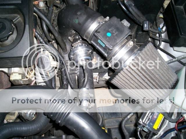

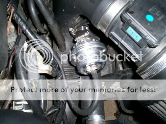

i installed my forge bov today. im curious as to if this would cause a stalling issue? and also if so (this may sound ghetto) could i cut my factory cold pipe and relocate the maf to it? or would that not work very well?

well for one... you installed the bov on your intake pipe.... you need to swap it to the hotpipe.
also, yes it will most likely cause stalling. I would recommend relocating the maf.. but i would not do it with the stock pipe.

Well from what I've experienced they do a pretty good job of breaking themselves so you probably won't need to.
But yea if you cut the pipe and put clamps or whatever on both sides of the MAF...they would probably just slide off once the pipe starts to expand and contract with the heat.
well i went back to the stock bpv. i experienced the stalling after i moved it to the hot pipe. and i dont want to do hard pipes till i do the diy ebay fmic kit after christmas
you will experience stallin with the forge bov unless you relocate the maf or run it with the stock bpv, this goes for any bov you put on
