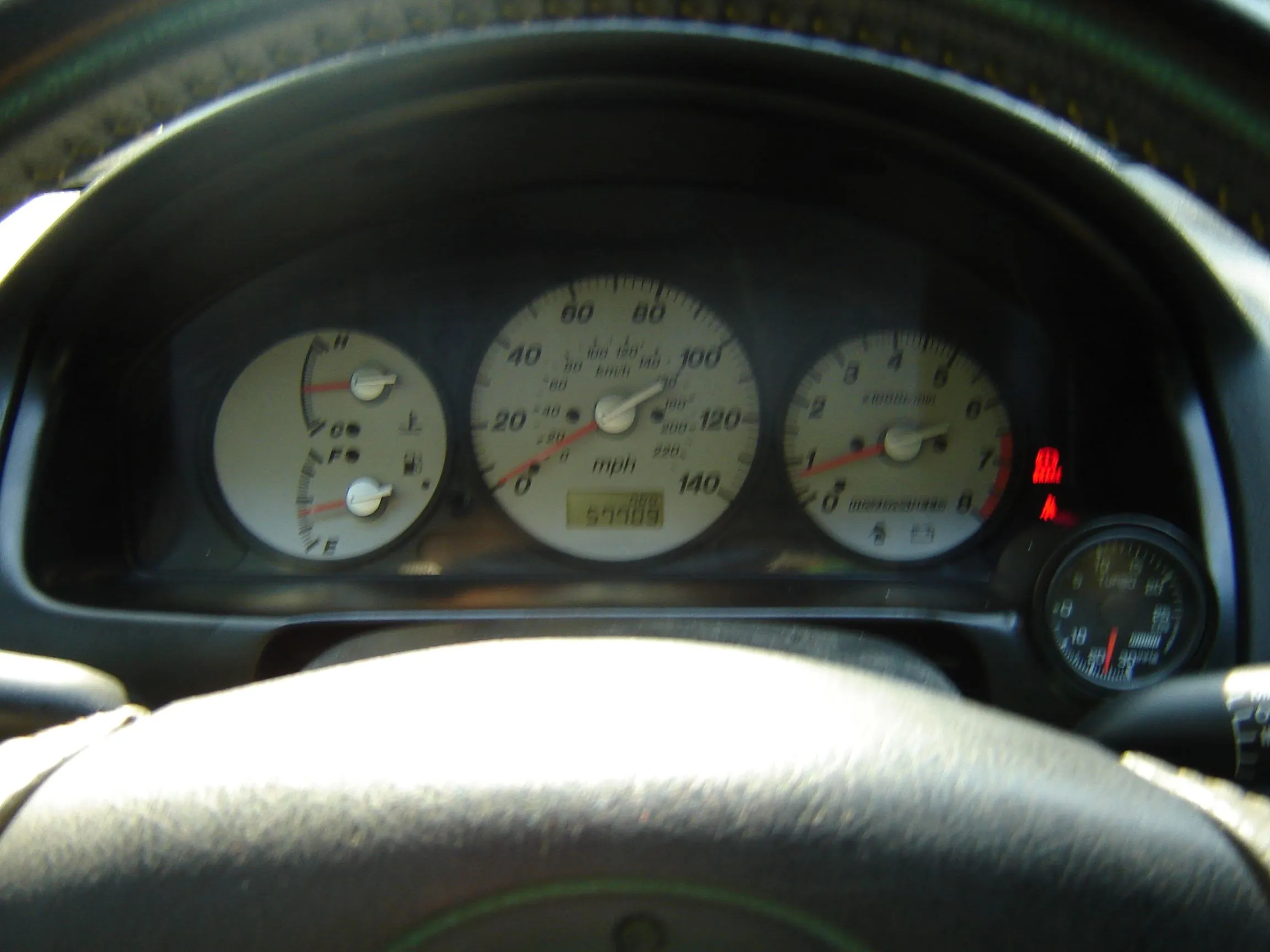

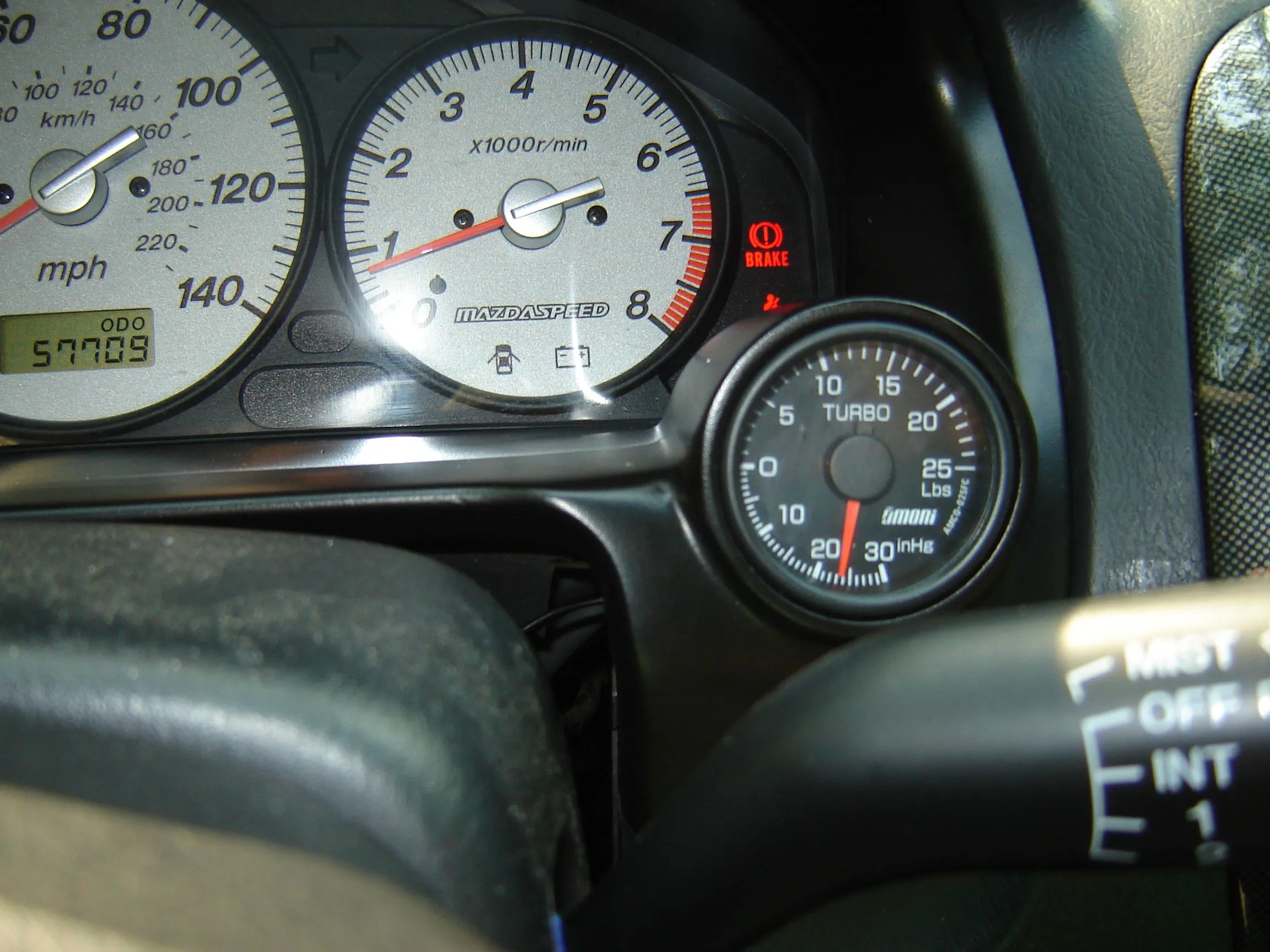

installed boost gauge! vac is at 25 at idle and boost just about goes to 5! now i want to up the boost! im waiting to install the cai. ill probally do it tomorrow
dude,!
if you have a mazdaspeed at stock boost (6psi)
please, do yourself a favor and check your boost gauge, it is broken!!
you must never have 25 on idle and be boosting 5 psi.
it just don't happen at stock boost...
thats what i thought! how do i know its broke?
dude,!
that's definatly bad
get a vaccum tester at autozone and test the boost gauge
it'll suck if you up the boot to 10 and actually you raising it to 14
yea vac of 25 is pretty dang high. or low, whatever. Mine is 20-21 at idle, and all the MSP's ive driven are usually 21-22.
Whats a normal vacuum reading? 20? I know mine reads that and it only gets up to 4 psi, sometimes 5.. lol
Anyways, I fixed the crack in my downpipe and I gutted my cat.. Hopefully Ill get to see some fireballs pretty soon.. lol
its weird, i just took it out again and when i was at the stop sign it was at 20vac and when im driving and i let my foot off the gas it goes to like 23-24. when the car is turned off the needle is at 3 vac. is it supposed to be at 0? is that the problem? how much for a vac tester?
Car off: 0 vac.
Idle: 20-22 vac.
Decelerating in gear: 22-26ish vac (to answer you: yes, that's normal)
full boost SHOULD be somewhere close to 6-6.5psi, but i have heard of some getting as low as 4. Pretty sure that's not normal though.
get in third gear, about 35-40mph, put the gas on the floor. The needle should jump VERY quickly to 0vac, then pause and start building boost. If it jumps to 3vac and pauses i should think you've got an issue. There's one quick test. But it should def. be 0 vac when turned off.
If you call the company that made the gauge, i would think that they will either re-calibrate it or replace it, no questions asked. try that if you think it's off. But check the line for any bends, kinks, or leaks. I super-glued the hose connection into the T and into the guage so it was sealed 100%; and my line is hard plastic/vinyl so it can't bend very easily (no kinks).
