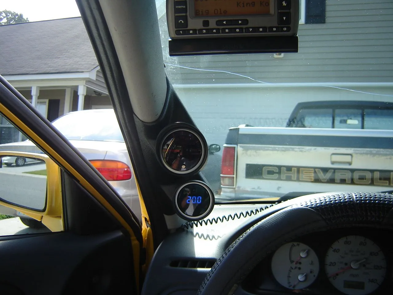

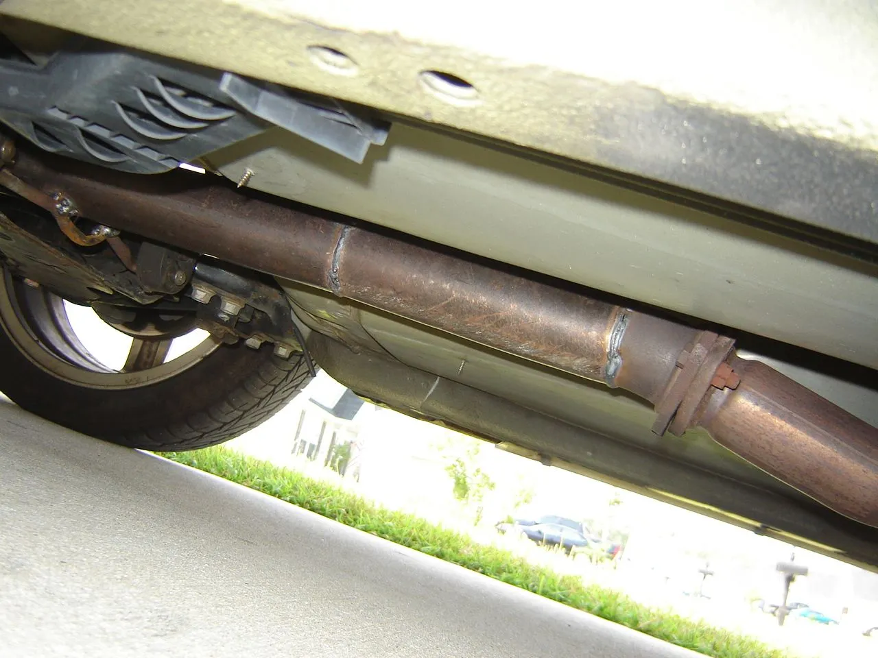

Samco Hoses hotpipe, Injen CAI, completely eliminated the second cat on the stock exhaust, and prosport boost and a/f ratio gauges; w/ more to come.
